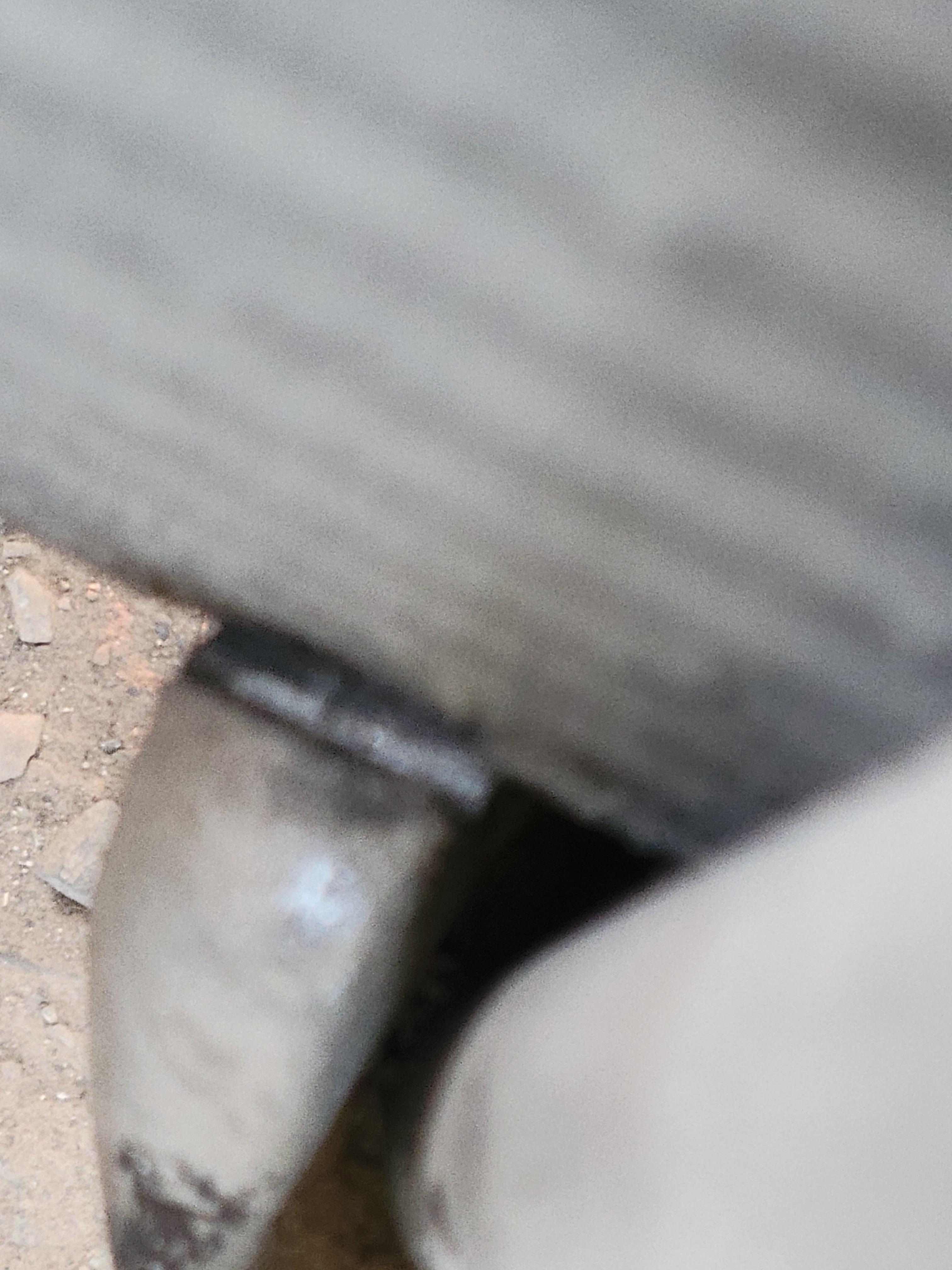

They came all different ways.  54" spread on camelbacks,  rod on the back rear was common.  I bet the truck he's asking about is one of those "county spec" trucks. Least that's what us guys around here call them. They were usually white with Ox bodies. Several of them come into the used truck marked on a regular basis. Hardly any miles and , no offence to anyone but they're cheaped out on in many ways to knock a couple thousand dollars off the price. They're actually pretty good low milage trucks. A little plain maybe. Usually well worth putting a few dollars into to upgrade a couple items  here and there.  Be a little tricky on this truck as it may require a reinforcement plate inside the frame channel or small plate on the outside.   Well worth putting on it though in my opinion .  Vinny's in NJ  that's 80K.  That truck very well have been made to haul 15 tons or so.  27......yeah, it's gonna get worn out pretty quick

definately needs a plate on the outside, and I would go with 3/8'' thick rather the the 3/16'' plate, high grade bolts, and stover nuts..
Those big 10.9 flange bolts and nuts.  Like if it was made with it.

Quality  work with brand new aftermarket  shit tightened with multimeter  and still move with load. It's like pissing in the wind. 1200 and change to change both saddles  and this is what I get. 20 years ago I would  have done them myself.  New ones ordered  from mack
Lots of guys don't realize how tight those need to be.  They're like 1600 ft/lbs.  Then retorqued after a few miles in service.

Oh.. ok..  I guess this is the older post about the torque arm.. that makes sense.  A re-Mack rear rear is around $2500.00 ish, plus labor.   Thanks for getting me back on the rails GW..  hi

Mech, his current carrier does not have the 4 threaded holes on the back for a rear bracket. Theres no more eyelets on top for the ball and socket type..
If im reading you correctly

Yes, i expect more damage later. However i think he has tried to keep the rears straight, i like to think he is not beating his truck.
don't think as an Owner Operator he would beat the truck ; 34's on a triaxle unless on farm hauling hay ;; not best combo. just sayin.

37 minutes ago, Vladislav said:
Maybe that 3.2K figure included drilling 4 holes in the carrier for the rod bracket?
The picture looked like it had bolts in the four already.  Wouldn't surprise me at all if the parts were over half the cost. I could see that bracket being close to $1000.00 in 2024.  Then the frame bracket and plate that goes with it. Probably couple  hundred at least in flange  nuts and bolts that actually belong on it. Stuff is nuts what it costs.
