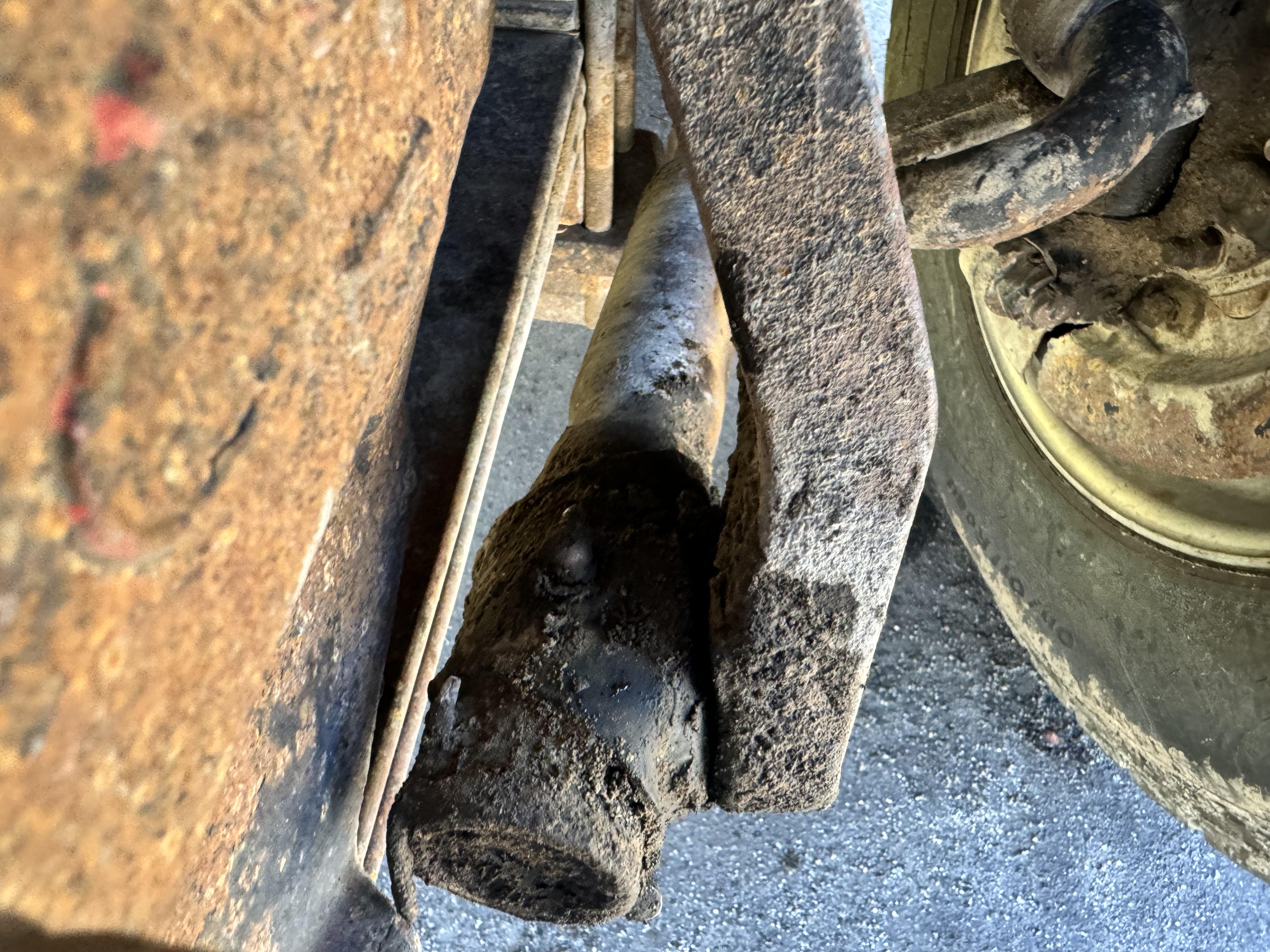

I’ve got a 1989 r688st and just failed safety inspection because the drag link has too much slop. I’ve only been able to the tierod style end but not the socket end. No one has one or plans on making one anytime soon. Someone suggested I update the pitman/drag link to the tierod style end.
Had anyone done this yet and have some part numbers? Or have an extra socket end laying around?

As said above. That's a plug nut in the end of the rod secured by a cotter pin. Remove it and try turning the nut clockwise. You need a kind of still plate to insert into the recess in the nut to turn it. Pretty easy deal at all if the nut isn't stuck really hard due to rust.
And probably no simple way to install a "tie rod style" drag link as you called it. You need another Pitman arm with a conical hole to suit the ball stud. And I doubt it even existed for this style of the steering box. Might be though.

Thanks guys, I’ve tried to find “junk” yards near by that have r models but haven’t had much luck. Is there a source for getting the parts inside the socket that connects to the pitman arm?

I say, never mind trying to by parts... take it apart first, clean the grease out and the threads of any rust and grit. if nothing shows dramatic wear, and if the spring is not compressed or broken,  screw it back to gather, I bet it will tighten up then grease it...  Guys,,  what say you?? Jojo
not understanding the "dumb ass part ??? seems to me your advice is correct. disassemble / clean/ inspect/ reinstall if nothing worn or broke.
