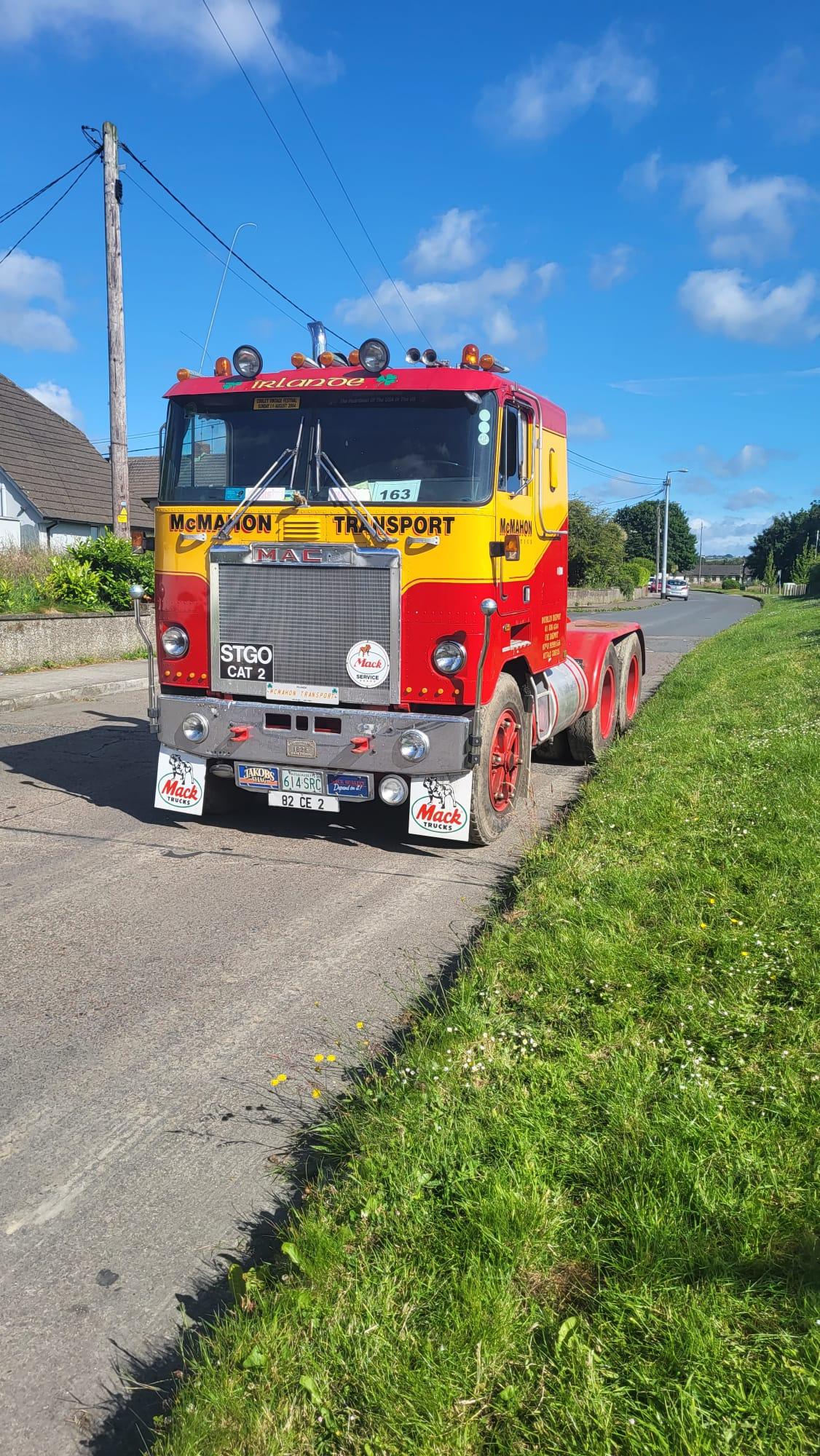

Yeah the gear lever goes through the floor between the seat and doghouse.i know maxitoqure gearbox takes a bit of getting used to but this shifter is very sloppy.it was the only thing that kinda spoiled the drive a little otherwise it was fantastic to be driving a cruiseliner at last

Thanks for the tips lads.the shift on our Cruiseliner is sloppy as in i cant get 1st gear at all 2nd can only be got when stopped 3rd and 4th are no problem and 5th can be got sometimes.the range changer goes smooth enough..filled shift tower with oil but it ran out passed the rods pretty quick.think i need to rebuild it....

Hi all,the shift tower that is leaking oil is under the cab floor.see picture.inside it the two rods have gears which move with the shift lever.the oil is leaking from the ends of the rods.i filled it with gear oil but it was empty in a few days.i wonder if the gears in it are worn but dont know what the amount of play should be.the link from it to the tranny has only 1 UJ which doesnt seem to have any play in it.many thanks for your help lads this is a great site.
