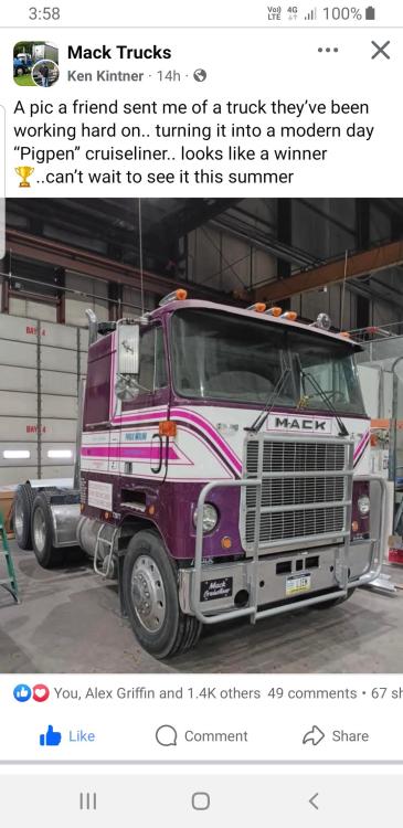

4 hours ago, mrsmackpaul said:
Spotted this on Facelessbook, might be of interest
Happy trails "Lovemachine"
Yeah,we saw it.She's beautiful,looks really great.Still intend to paint ours the same.Iv waited 46 years to drive Pig Pens truck...aint stopping now!!!!
Any one idea where that truck is?
Paul

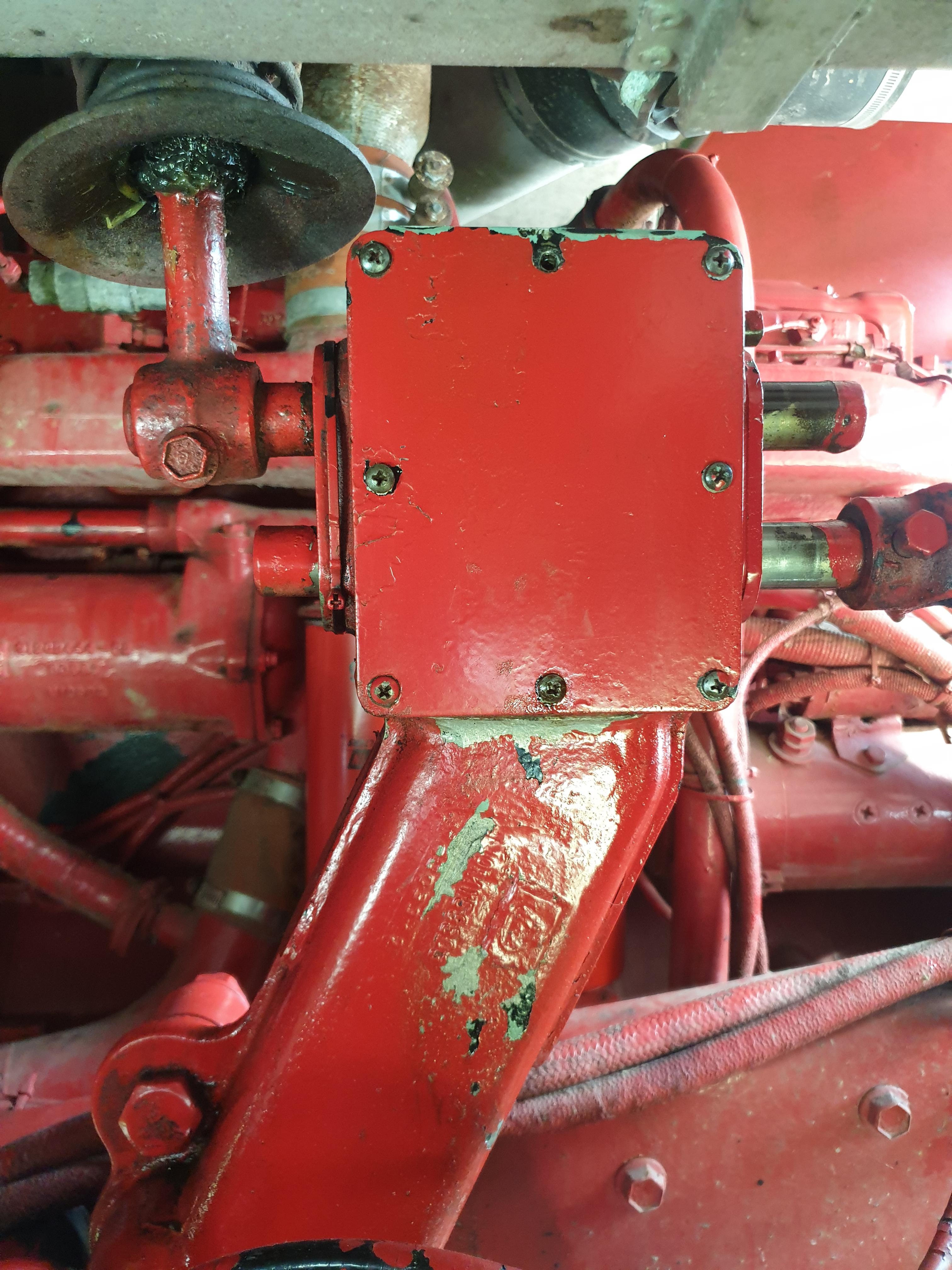

Hi all,the shift tower that is leaking oil is under the cab floor.see picture.inside it the two rods have gears which move with the shift lever.the oil is leaking from the ends of the rods.i filled it with gear oil but it was empty in a few days.i wonder if the gears in it are worn but dont know what the amount of play should be.the link from it to the tranny has only 1 UJ which doesnt seem to have any play in it.many thanks for your help lads this is a great site.
Hey Paul mine has had grease nipples fitted so pumped it full of grease. It is a little sloppy but hoping it might get better with some use
Nathan

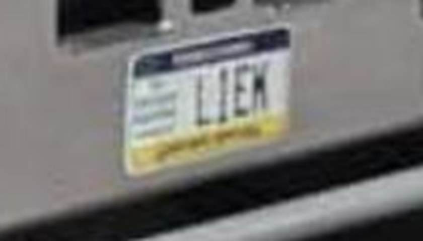

I see a couple things that make me think that's in Pennsylvania.
  • Haha 1
22 hours ago, cruiseliner64 said:
Go on do tell....
Paul
The guy that posted it isn't too far from me , and as others pointed out it looks like some type of Pennsylvania plate.  I tried enlarging it, but it just got fuzzy .  I think the guy that posted it is a cabover enthusiast too. Safe bet we haven't seen the last of it though.  Looks like a nice Cruiseliner.
