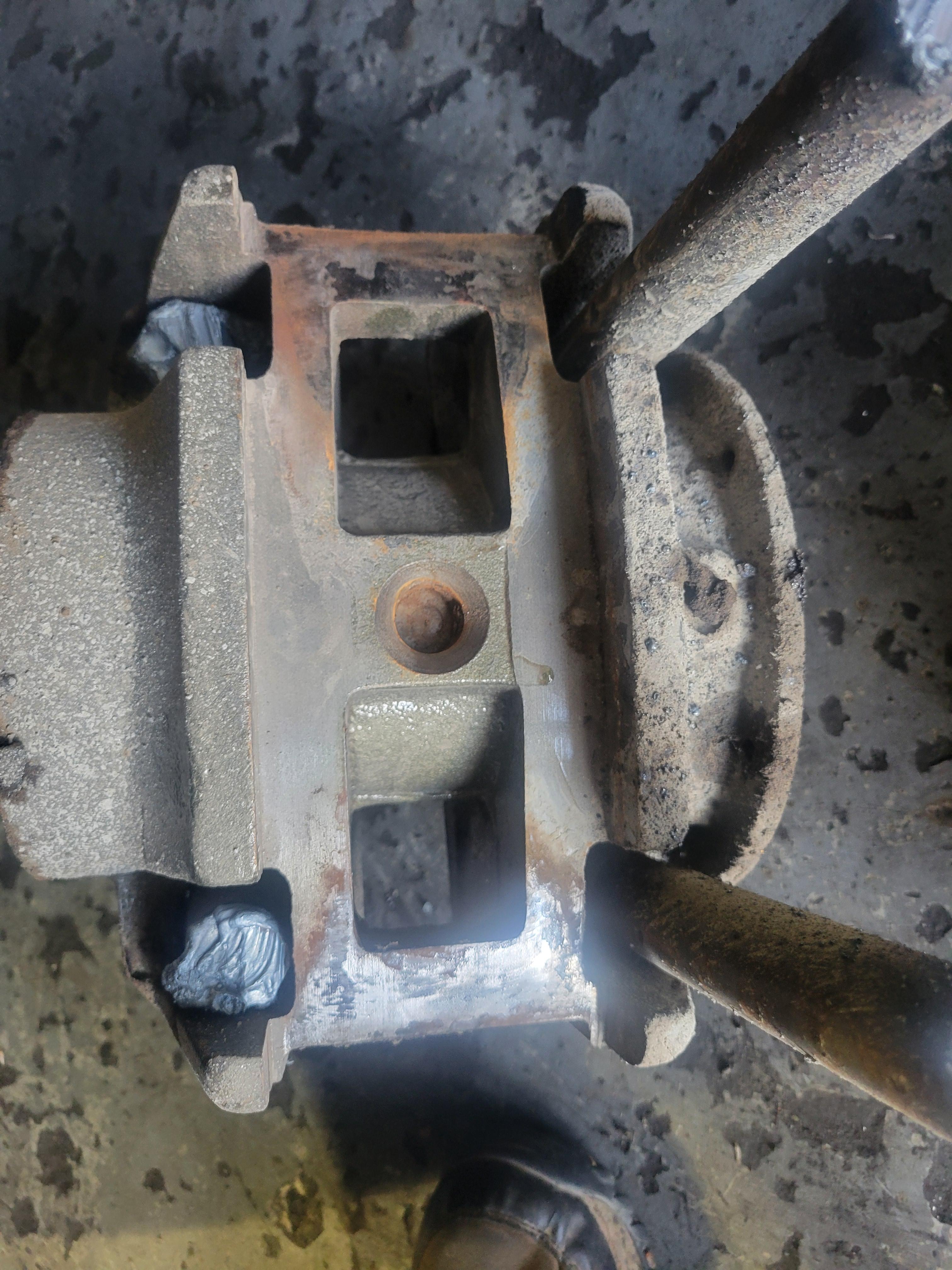

Spring guy said saddles  wore out he put cheap aftermarket ones on and they are worse then before.  I had enough  and went to mack and got oem. They don't the ears at the end , what would  be the difference.  Blurry picture  is the week old saddle  moving.  Even after being  tightened by a multimeter  gun20240815_064530.thumb.jpg.0eb368909e2471a5abc4207d4d2ad723.jpg20240817_163408.thumb.jpg.582ed4c40d4a254f0a49bdf72a88fbc7.jpg

Yes 20 to 40 or so I use to do these myself not at 60 , father had a shop . Something is shifting  its not the trunnion bushings  because  I did look the springs  are moving  in the cheap 234 dollar saddles  that where put on.in February and again last week , I was thinking  the sides of the springs  are wore and saddles don't fit tight,or center bolt is broke. Mack saddles  where over 900 a piece.  The way they changed saddles  didn't take springs off cut u bolts and jacked it up. Maybe they missed  something  wore on the inside of spring

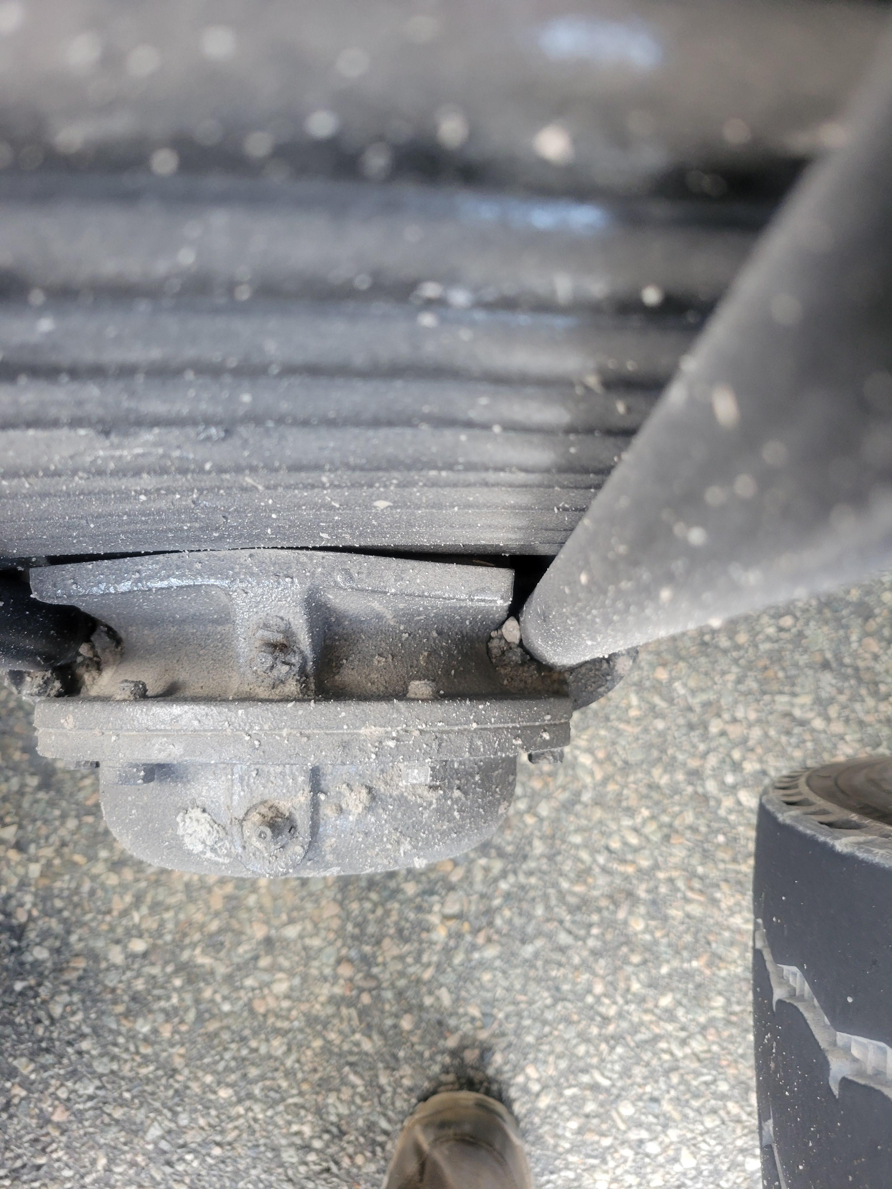

I forgot  to mention  the first day to me it looked like they were moving  ,I took a picture  of undnieth  as you can in picture  it was moving. Went back next day he put multiplier  on them while  truck was on the ground  and they tightened 20240821_064226.thumb.jpg.cd7ca9c7859012826a11fd96db943331.jpg
