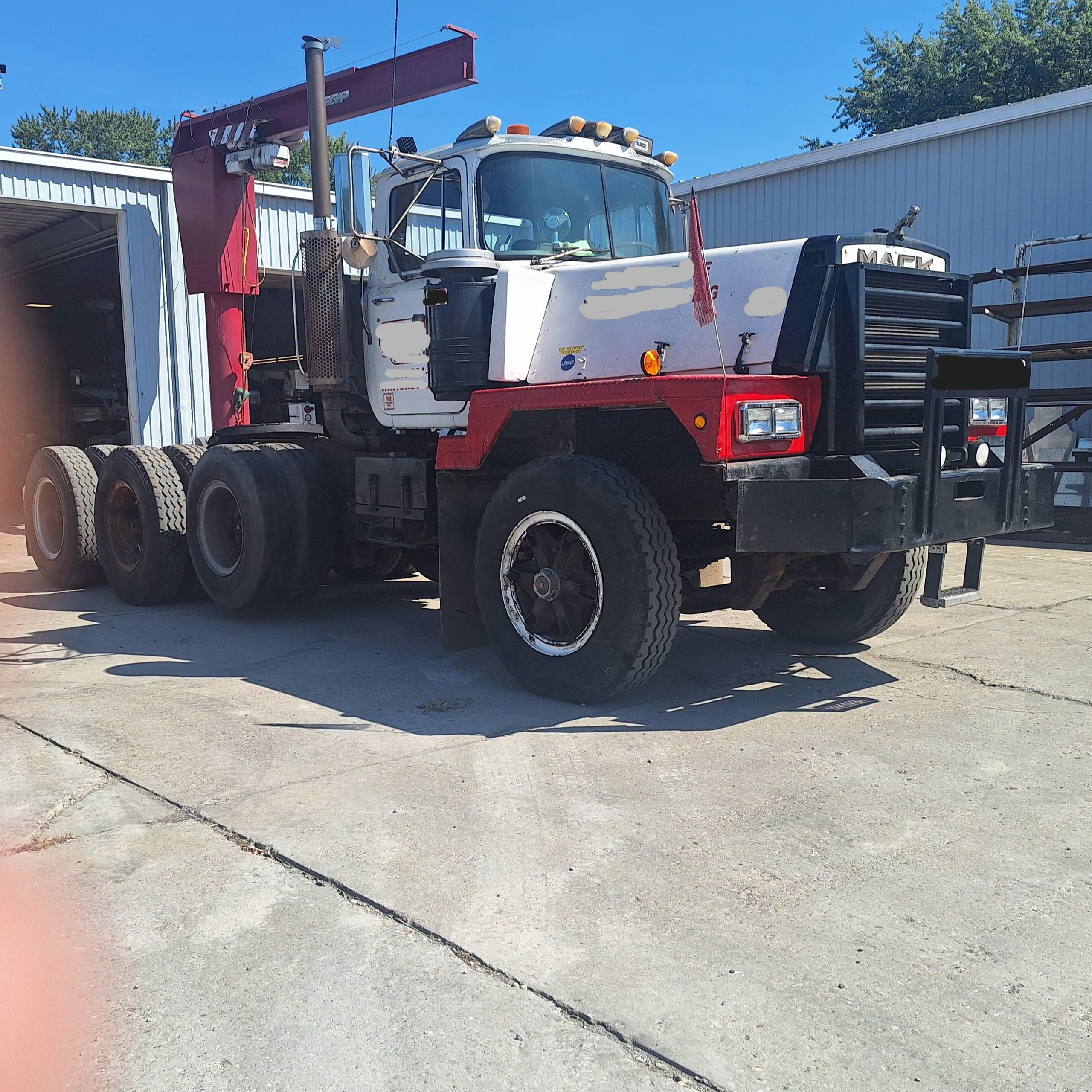

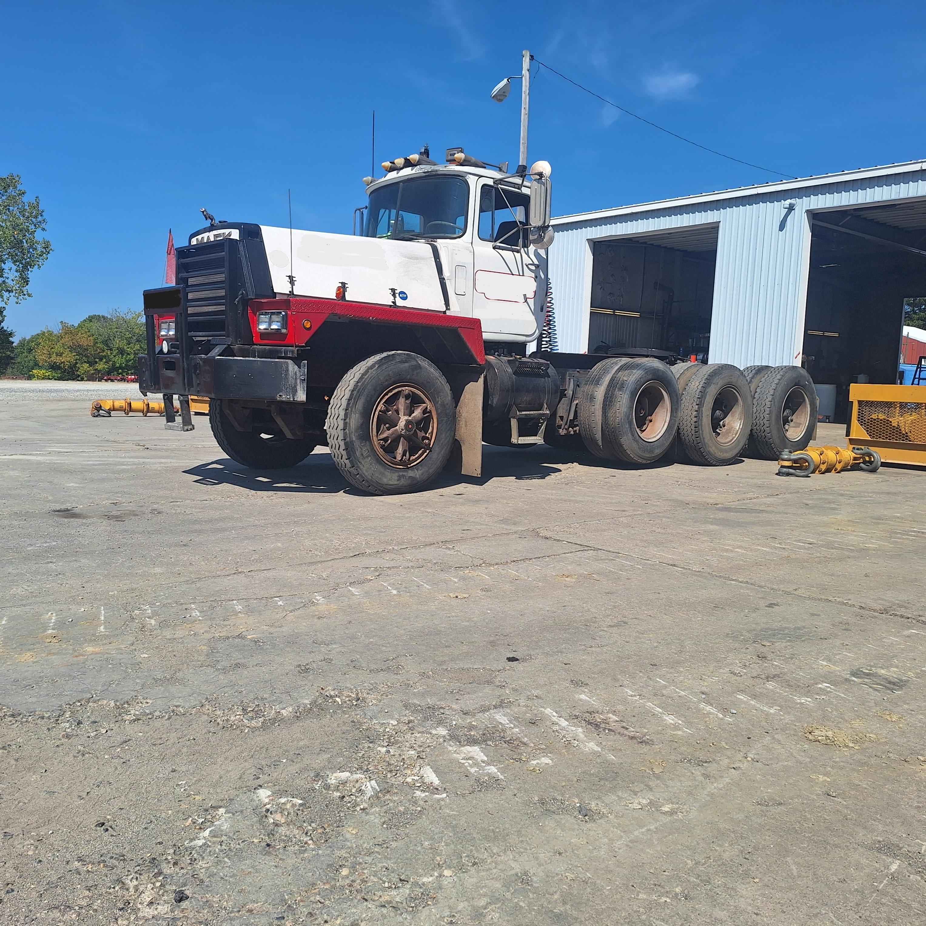

Have an RD886SX with a little 300, 5spd, direct/lo/rev compound aux, 80k rears wearing 12r24 rubber. solid walking beam suspension. 20K fronts. Triple frame. The truck is NEVER on the Hiway, and never will be. So get that out of your mind. A typical day is moving a roughly 175-180k gross load about 2 miles on flat ground with maybe 1/4 mile of that in reverse. Anyway, the 5spd is on it's last legs. Don't know the history before we got it. Going to go Allison when this happens, just not sure which parts we are going to need. Any suggestions? Already know custom driveshaft.

No ECM, it is a mechanical engine. Truck is a 1984. 15 mph on the loaded trip would be pushing it, there is probably 8 RR crossings along the trip. Multiple stop/ intersections. Newton's 1st law. And don't forget the nutjobs on their carts zipping all over the place. I should clarify, a 2 mile trip 20 to 25 times a day 6 days a week. Yes i know mounts, cooler, shifter, going to be fab work. that is not really intimidating. Getting the right flywheel adapter and torque convertor now that is where things get hairy. Bellhousing not so much, they are mostly either type 1 or type 2. I was leaning towards an ht740 or 745

Yea flywheel/flexplate was what I expected to be the biggest obstacle. Torque convertor for a similar hp/tq rated engine should be close. Do not need a pto. A pic would be awesome. The water pump went out of it yesterday, so it's down for the time being. Yesterday was also the last day moving steel for a couple weeks. Have some other things to address, new front springs, bushings, hangars. Once the hood is back on and it's outside i'll get a pic or 2

Pictures don't show you much other than a plethora of wires.  Double check,  but I don't think there's any TCM. Just data sensors for the engine ECU. Trans temp, neutral safety switch, VSS, etc. You can see the PTO plate on top.  Your best bet on donor will be a trash truck or an Oshkosh front discharge concrete truck.  I have a 2000 MR688 cutoff with the HT740 cable shift, my 2003 MR688 has an HD4560 which has all sorts of electronics onboard.
