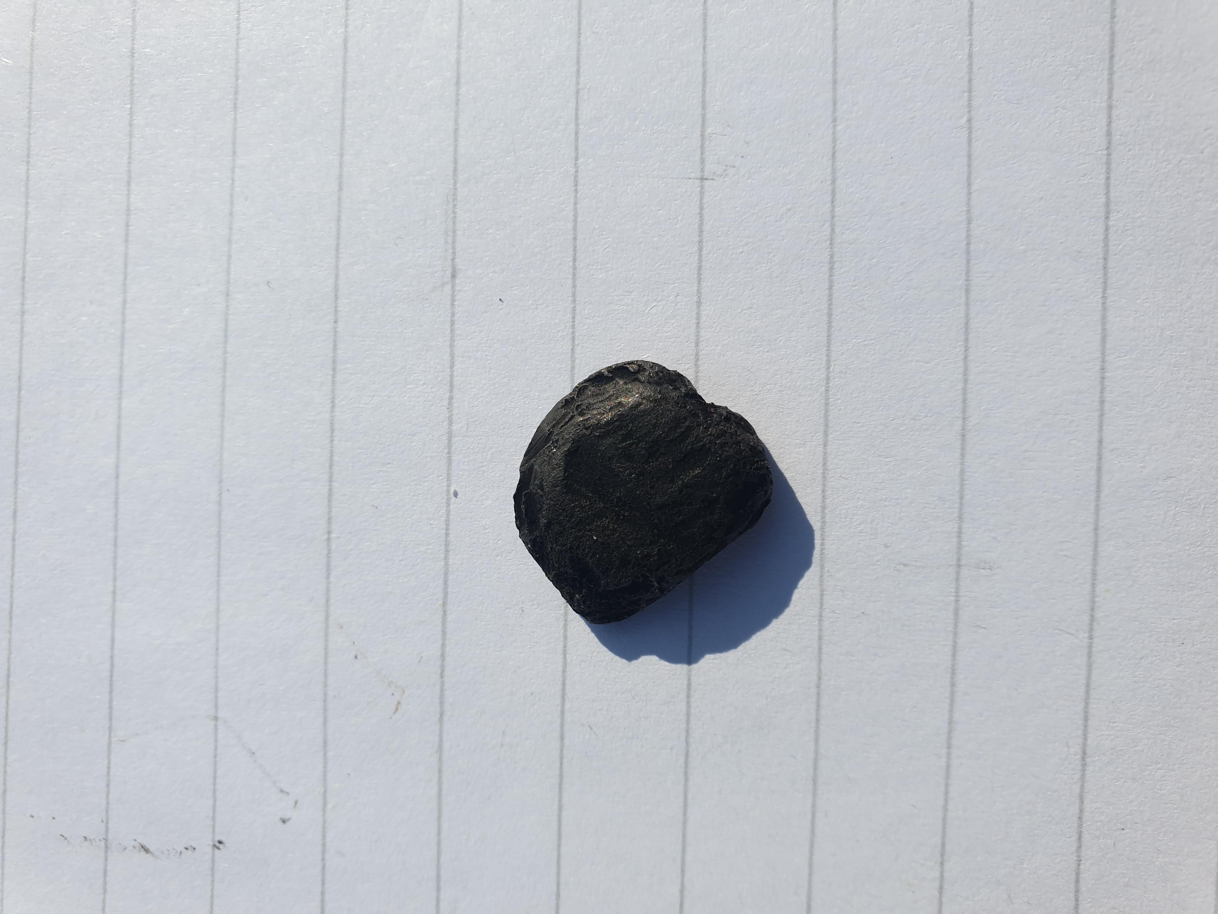

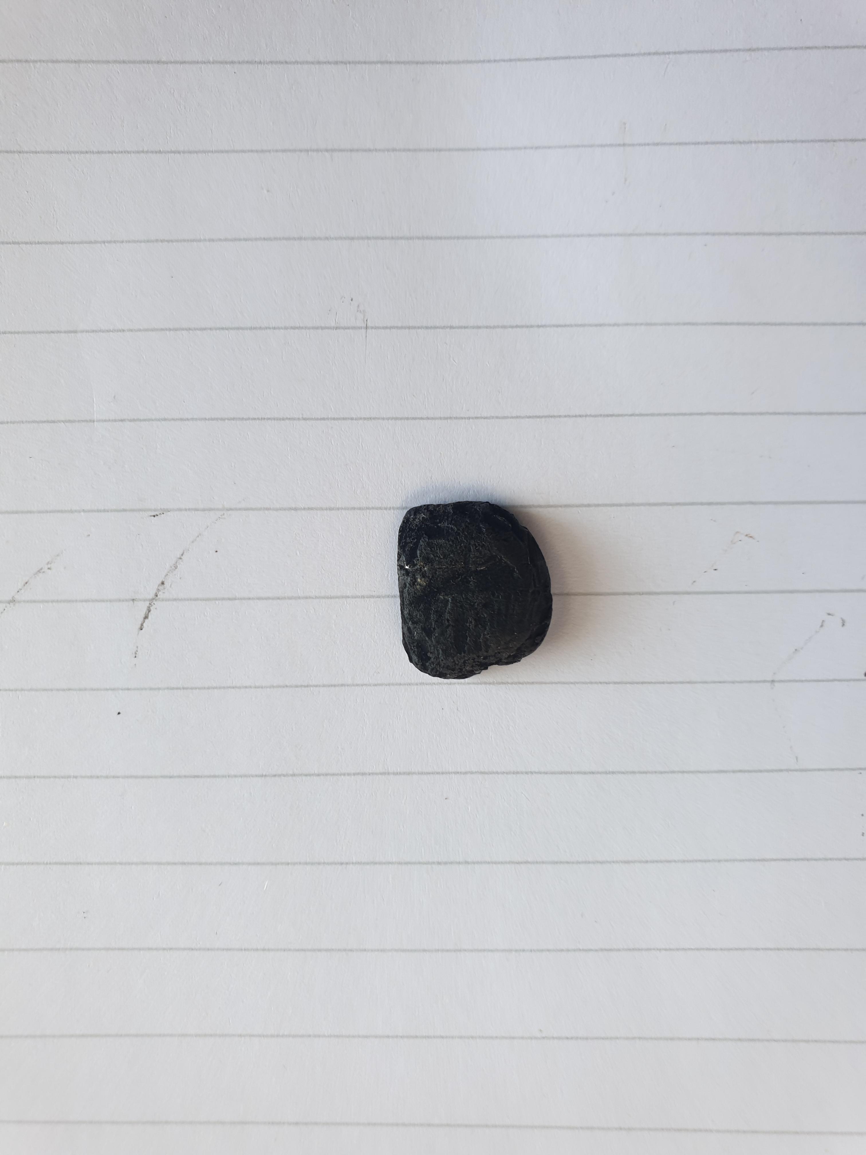

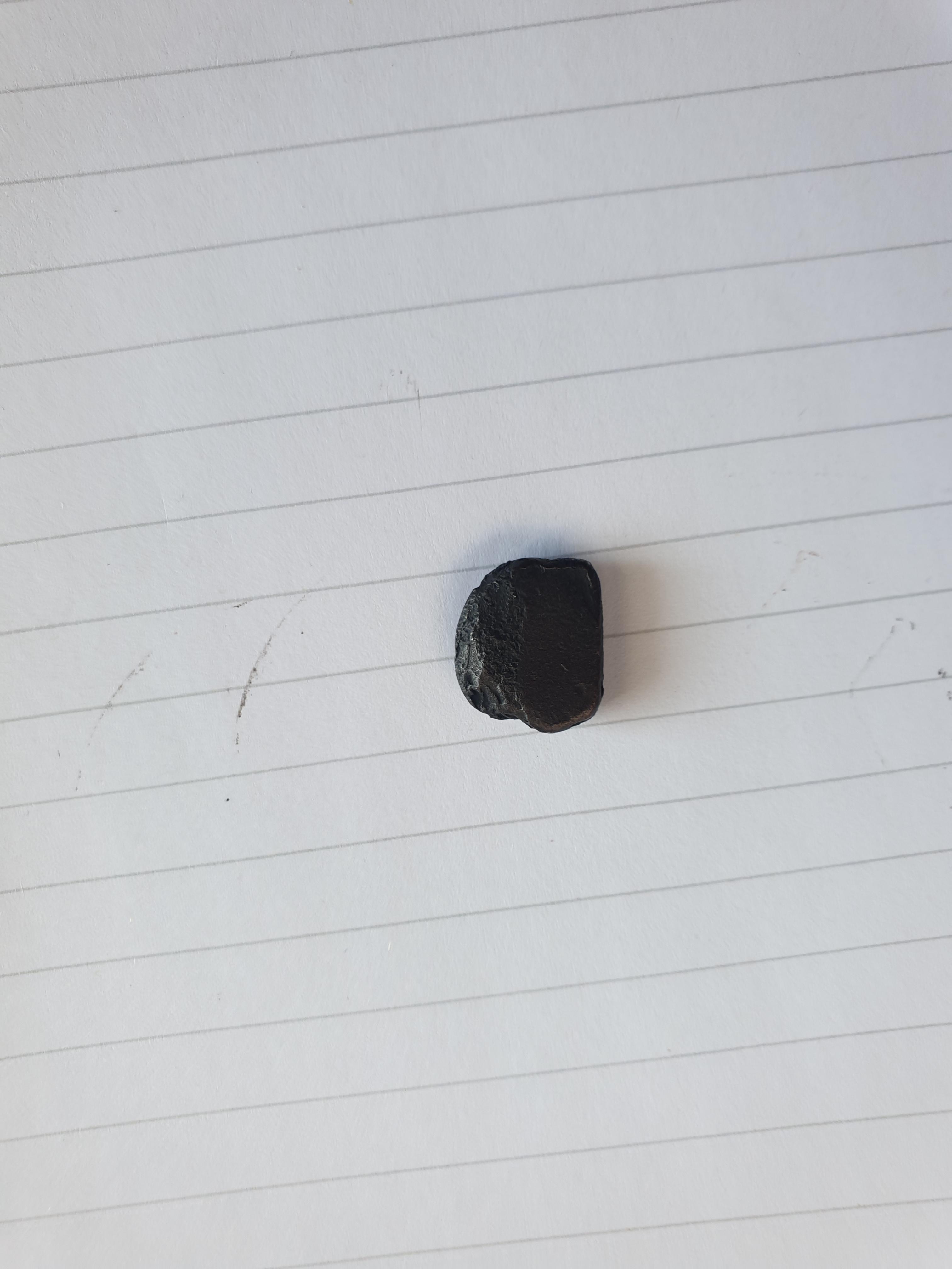

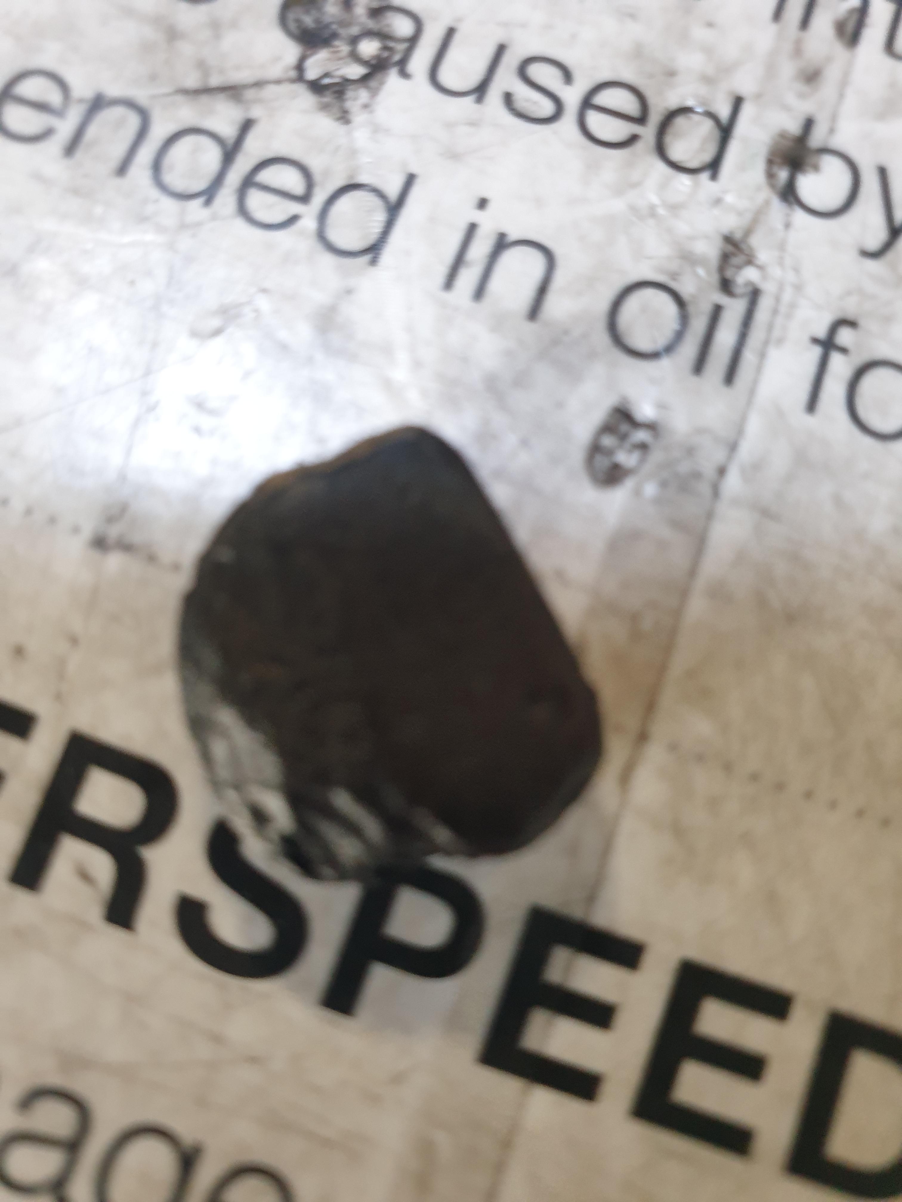

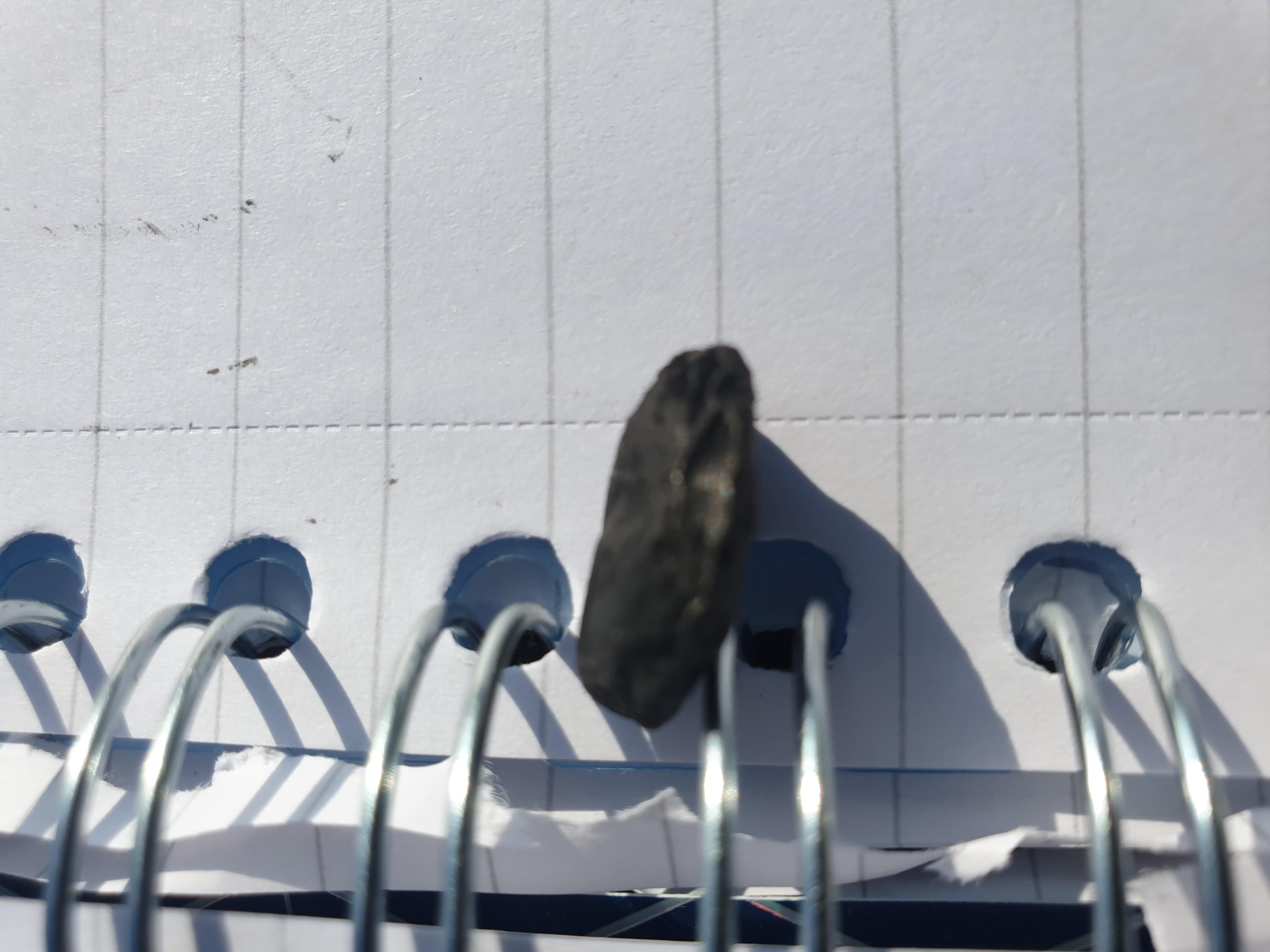

Hi all,the turbo guy came back to me with really bad news...the turbo is toast.he found a foreign object stuck in the exhaust turbine which came from inside the engine.its cast iron and shattered the turbine wheel.it seems to be to big to have passed through an exhaust valve so we are hopeing its from the exhaust manifold.we are going to strip it on saturday and do a cylinder leak test...wish us luck.anyone see anything like this before?
Paul20240829_112726.thumb.jpg.2d5dad52d9c21bc8f2de0103e525a0f5.jpg20240829_105755.thumb.jpg.a4cd74df47db1606283cfa0202cfc3e9.jpg

that looks like the bottom of a bolt hole that was pushed out by a bolt that was installed too deep..  i need to think on it..  any other pictures?  wide out rather than zoomed..

are there any odd bolts mounting brackets to the manifold?  are the turbo mount bolt correct, or been replade with longer ones?  you can check those holes by simply looking in them with a flash light inserted into the turbo ports. if you see the light coming from a bolt hole, you likely found where the slug came from..  I'm pullin' for ya... jojo

Thanks joey i will check all that out.yeah it was 1.30am when i put up the last post.its now 9am here in ireland.i cant thank you enough for the support.having never worked on Macks before its great to be able to talk to those who have.every make of motor has their own quirks that are learned with experence...

Great minds buddy my thoughts exactly is that piece magnetic? Not lump of carbon?

Hi all,yes the piece is magnetic,its cast iron as far as we can tell.i wonder if its off the exhaust turbine housing itself.it appears to have two vains around it which the exhaust travels before being fed onto the turbine.we cant see into it and we dont think the scope will fit in when we get it.i wiil see if i can block the oil feed and run the motor.see what it sounds like... thanks guys.
