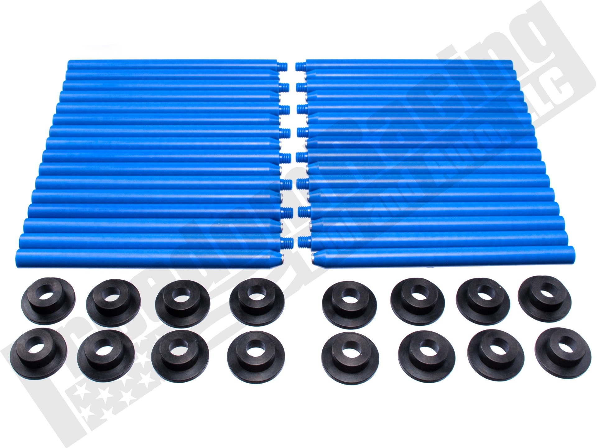

J-37720-C Mack E9, E7, & E6 Roller Lifter & Tappet Holder Kit Alt
  • J-37720-C Mack E9, E7, & E6 Roller Lifter & Tappet Holder Kit Alt
J-37720-C Mack E9, E7, & E6 Roller Lifter & Tappet Holder Kit Alternative
This tool retains the roller lifters when removing and installing the camshaft. It works on E-7 EUP (Electronic Unit Pump) and tappets in the Mack E-9, E-7, and E-6 Engines.
Inclues High-Quality Aftermarket Alternatives of:
  • J-42425-3 Magnet Cap x16
  • J-42425-4 Bottom Rod x16
  • J-37720-5A Top Rod x16
  • J-37720-6A Grommet Kit x1
  • J-37720-13A Magnet x16
AM-J-37720-C
Manufacturer Aftermarket
Brand Aftermarket
Storage Code W-46, W-42
SKU# 1664-L
th?id=OPHS.dL5Y%2fNVrXOSmuQ474C474&o=5&pid=21.1&w=174&h=174
th?id=OPHS.FPWPo9sVGg6%2fag474C474&o=5&pid=21.1&w=174&h=174
Here are 3 essential tools to do a basic cam job.  since it is running good I didnt list a couple others. Jojo
