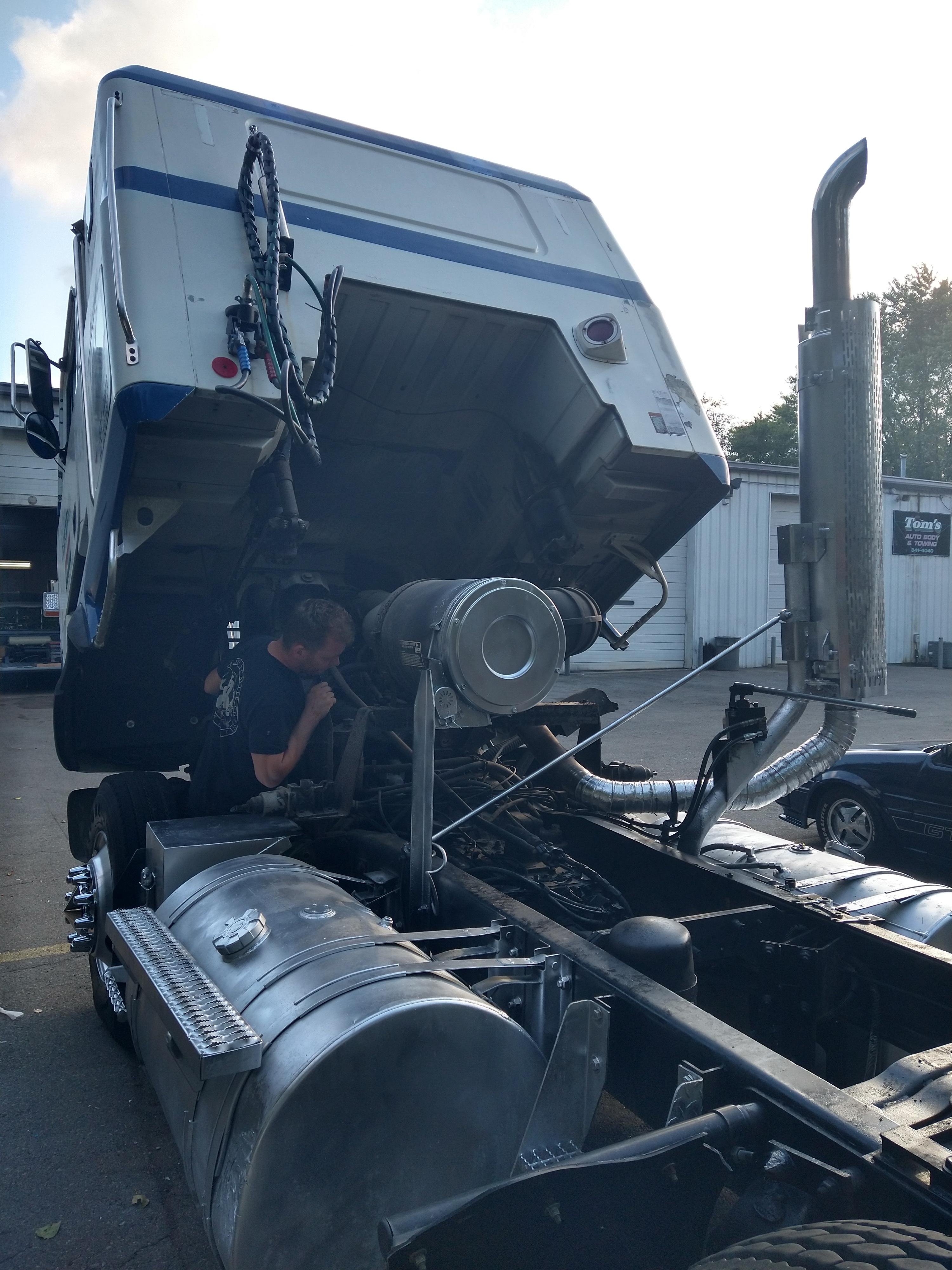

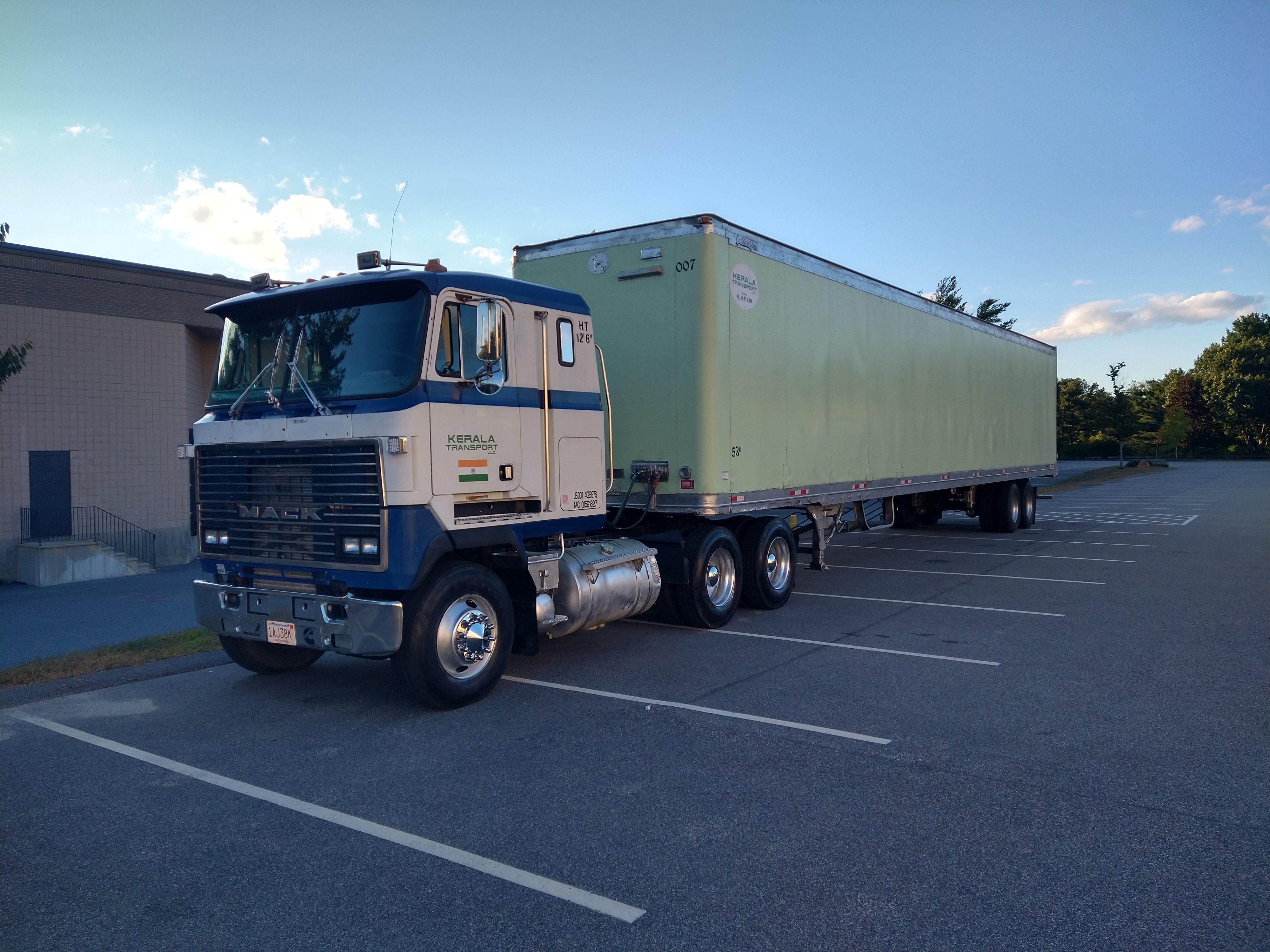

Good morning gentlemen. I'm Jason , I own a small trucking company and just bought a 1991 Mack MH 600 cabover to add to my fleet. It's got the 350 Cummins small cam with an 8 speed manual tranny.
I'm really excited! My mechanic is going through everything now. He just did the PM , all fresh oil in the differentials and new wheel seals , bearings and shoes on the drives.
Next hes gonna tackle an exhaust leak. He also fixed all the lights and fixed the wiper fluid pump that wasn't working. The AC is not working but we don't have time to dig into that right now.
Ok, now the fun stuff.... The cab lifter isn't working. He removed all the hydraulic lines and had the drivers side Piston rebuilt because it was leaking badly. That was a hassle... But after that the cab still won't lift. Hes removing the pump now and is taking it the same hydraulic guy. He thinks that needs a rebuild too and and maybe the check valve inside is bad.
Anyone have any experience with this??? I really wanna get this cab up because he doesn't wanna put the new fuel filters and then not be able to prime it.

Good to see a fellow MH guy. Jason, I just recently replaced my cab jack pump on my 93 MH. PowerPacker makes them and it was around $400  brand new.  https://ohiohydraulic.com/power-packer-hp50034204-hand-pump-4000psi-35ci-69-spindle/
Also, beware when putting new fluid in that system.  Don't mix hydraulic oils or use transmission fluid. It's recommended to use the military aerospace grade hydrulic oil MIL-H-5606A in that hydraulic system for the cab, especially if you are in cold winter area. This (or an equivalent)is technically the correct oil for that system.  It's kinda pricy,  but it's the recommended oil. I bought a gallons worth and they were super fast on shipping.

Make sure the safety latch drops in place with the cab up. Or get something to brace up the rear of the cab while you are under it. Don't trust just the lifting pump to hold it up. Just mentioning this for a friend............    .....Hippy
Yes definitely make sure it's latched before you crawl under there! Check the cab hinges too and make sure they are in good shape and greased.

Being a 1991 it should have the E7. Very nice truck!
Macks are small cubic inch compared to cat/Cummins.  They don't drive the same, but will do the same job.
Is the 8spd OD?  Likely has 4.17 gears and puts you about where you're at speed/rpm wise.
