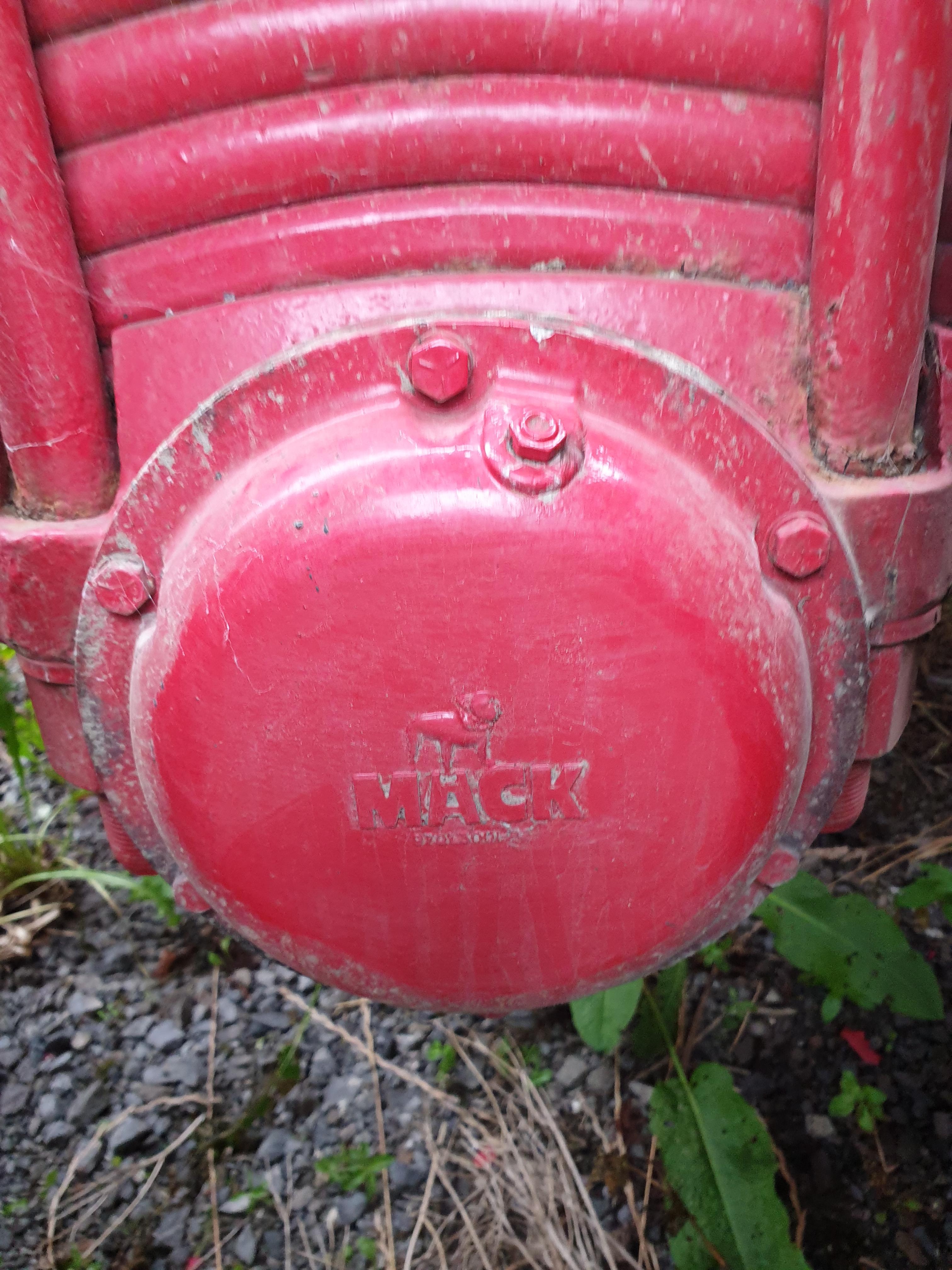

Hi all,asking questions agsin as we try to get to know our Cruiseline inside out.The trunnion bearing in the Camelback suspension is it oil or grease lube? The reason i ask is theres one grease point at the rear of the trunnion tower and what appears to be an oil plug on the bearing cap(see pic).i understand the weight has to be off the bearing to lube it.any infomation would be great.thanks.

grease. the plug in the picture is an air bleeder.  it looks like it may be sealed by paint. pump grease in until it comes out of the bleeder.  may want to just put modern spring loaded bleeders in the trunnion caps so you dont bust the caps.
