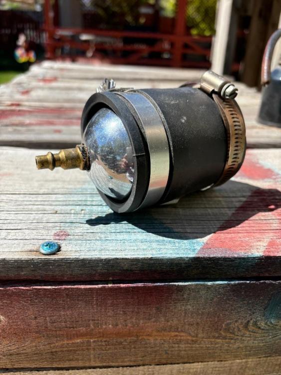

there is plenty of sources out there and yes they are all available dealer does not sell them on the roll anymore i just changed mine went to a hydraulic line shop in town got everything,,,and no you dont have to touch pump or injectors if you have a problem with priming after wards spin it over a few times with starting fluid untill it runs on its own good luck and yes the ends are reusable,,,bob
Thanks for the info.  Love the air tank pressurizer, great idea.  Hopefully I won't have to go that route.  On double fuel tank set ups, is there a check valve between the main tank and the feed from the aux tank?  I have a weird looking right angle fitting poking out of the aux tank before the line that connects over to the main tank.  Are these set up to only allow draining from the aux tank towards the main?
I am not sure what you’re talking about but I’m sure other guys will chime in and yes, I don’t think you’re gonna have to need that device. Just an option as I said I bought everything at Home Depot right off the shelves…. Right now mine keeps losing prime so I have to blow it just about every time I start it so far I’ve only changed the oil lines. Haven’t done anything with any other others yet…. It was starting with a little ether now that’s not even doing it after one week. It’s already got air in it. And I usually start every Saturday.

I don`t have a hand primer on my ENDT673,so am planning to use Bob`s method.Bob,how long do you keep pressure on that tank?
i leave it connected for around 10 minutes,,,,ill be starting mine soon,,,ill probably wind up doing the same thing,,,,i have a hand pump,,,but it dont work worth a shit...bob
5 hours ago, skydawg said:
I`m low tech...an old piece of tube w/ the valve and a hose clamp to seal it to the tank.
I suppose that would work too, but then you have to have a clip on air  chuck mine would not start at all wound up. Going to a car show instead local show and shine.
Even if the system is dry, on a air start truck it will start in two tanks of air
If a hand primer is fitted, just chuck the new filters on, pump the primer, you will feel it when it is primed and bypassing back to the tank
Fill the air start tank and hit the giddy up and go switch and let the magic happen
