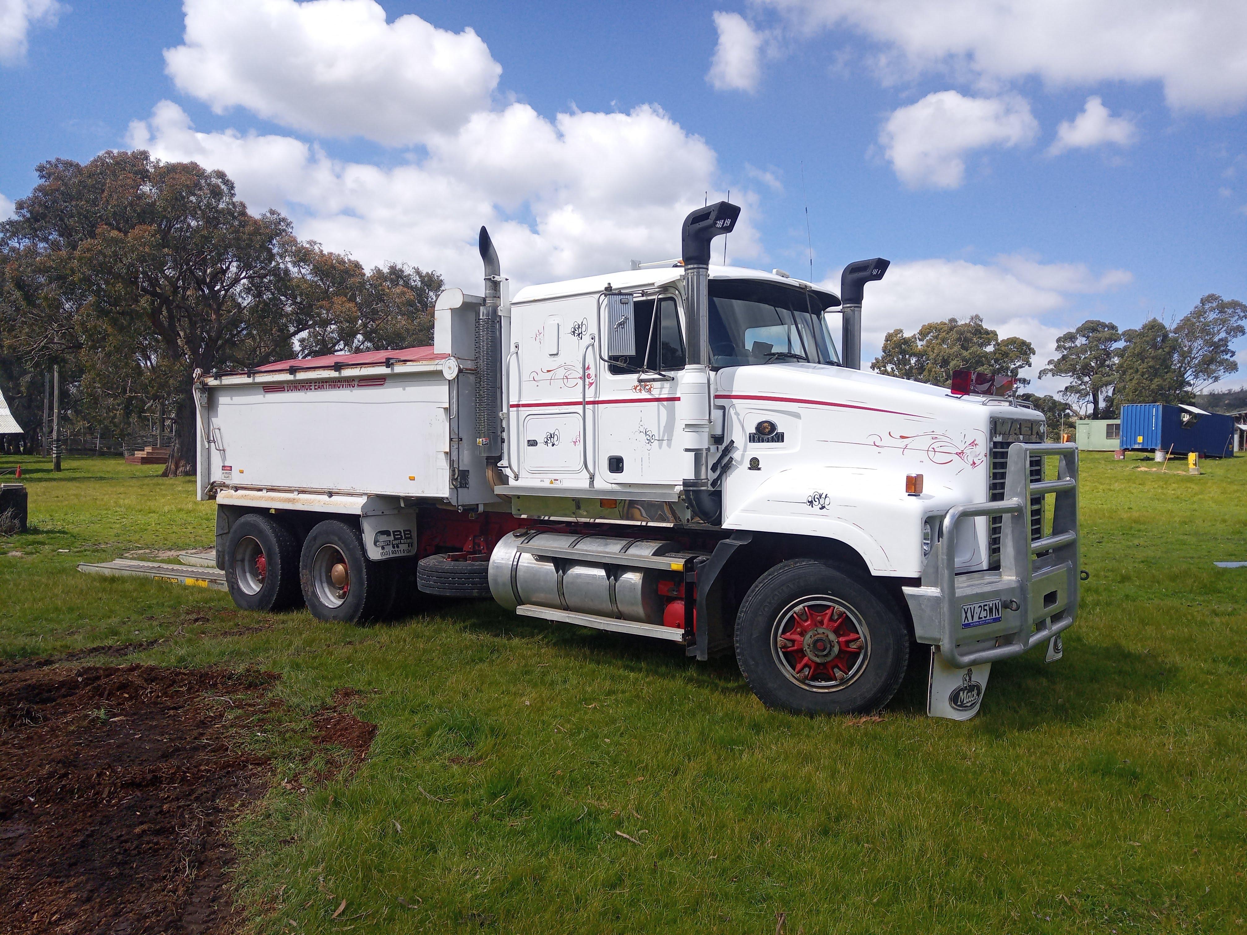

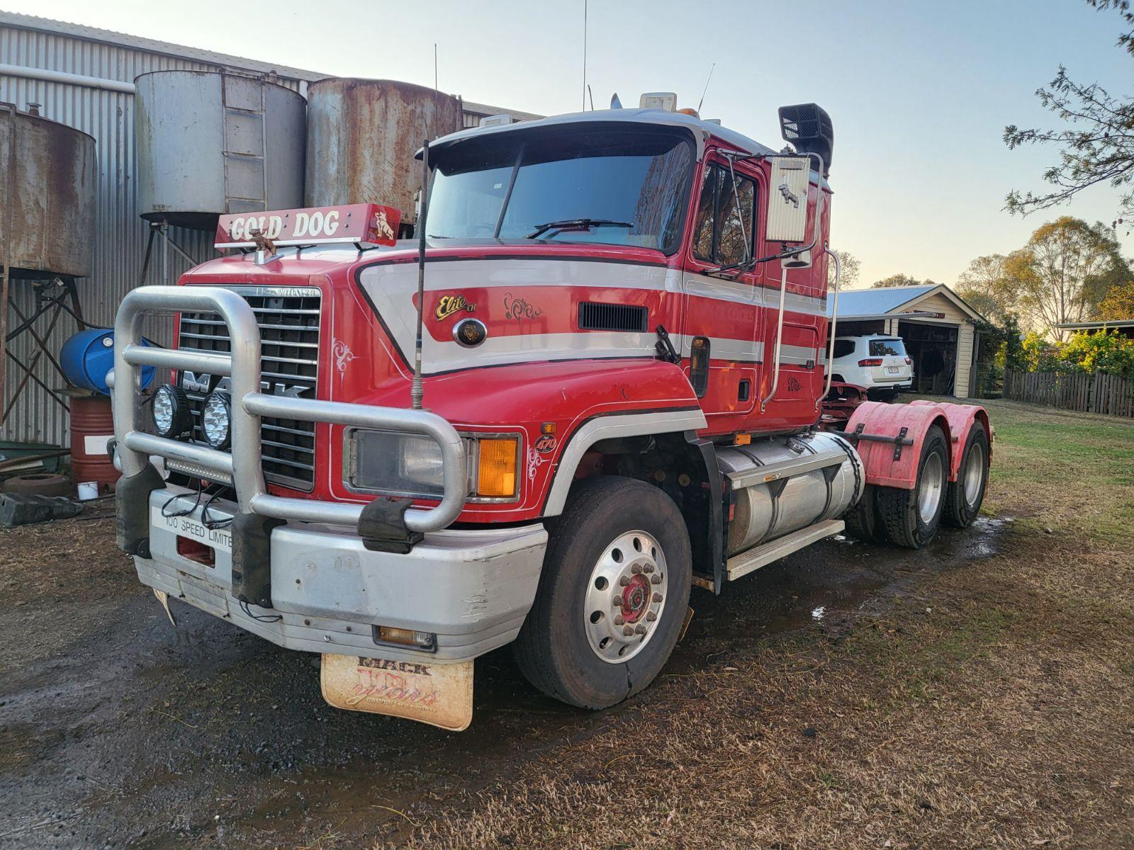

IMG_20210916_120127_2.thumb.jpg.f4dde2c38df17cfe80059a32251fc7ec.jpgSaw that for sale Paul, was cheap enough. Reckon he's got a good truck there. Was 2 IT bunk CHs for sale last week. Don't think there was too many made over here. I've got a Trident about the same year with one.
