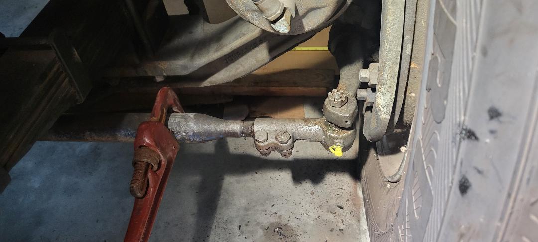

I've recently driven my 1959 H653LT for the first time. Runs great - drives "OK" but needs front-end alignment. I've checked "toe-in" and found it actually has about 0.5" toe-out. Rotating the tie-rod with a pipe wrench seems to just move the tie-rod left or right - but doesn't change the toe-in as I'd thought it would. So, looks like I'll need to disconnect one of the ball-joints from the tie-rod to make the adjustment.
To remove the ball joint, I've been told to just hit it from various angles with a 4-lb hammer, and it will drop out. I'm reluctant to do that without knowing a little more about it.
In the picture below, there's a hole in the steering knuckle adjacent to the ball joint's tapered shaft. I'm concerned that there might be a roll-pin or some other sort of "keeper" there that must be removed before the shaft can come out!

Thanks, Terry - I get that about the castle nut.
But I'm talking about the hole in the steering knuckle itself. Anyway, a local ATHS friend said "don't worry about it" there's nothing in that hole that will prevent the shaft from coming out of the knuckle.
  • Solution
there are NO pins just loosen the castle nut and strike the end of the steering arm and it will fall out, leave the nut on a turn or 2 so it dont hit the ground..it may take a few strikes, but she'll come...

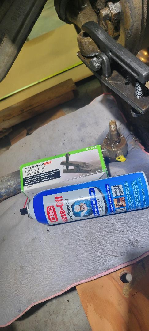

Yes! Eventually. But not without help (Credit where credit is due!) : Heavy-duty ball joint tool from Harbor Freight, propane torch, CRC Freeze-Off. I had to grind out the opening in the ball joint tool - it was about 1/8-inch too narrow. Applied the tool and cranked it down hard. Heated steering knuckle with the torch. Applied Freeze-Off to the stud for about 30-seconds. And ... BAM! ... it let go! Glad I'd planned for success (!) by placing a wood block and cushion underneath.
