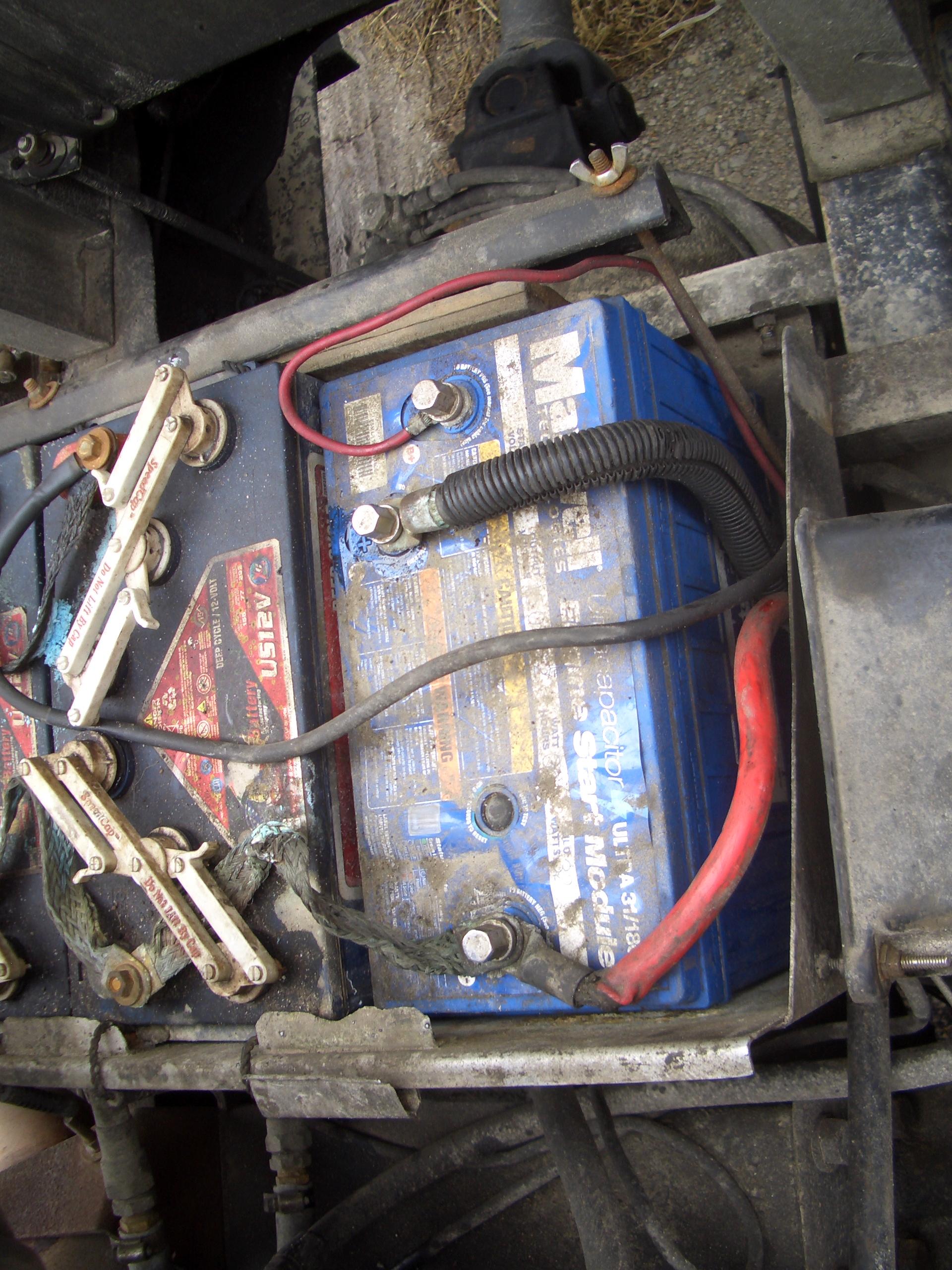

ESM-2.thumb.JPG.6506b8d61e4ae79928a892494f6624b3.JPGThere are 3 ways to eliminate the Series/Parallel switch, or there used to be, one may not be available due to Elon buying then re selling Maxwell.
1st is to change the starter and cabling to a 12 volt crank/ run system
2nd is to used a TR alternator with both 12 and 24 volt output, The batteries are wired in series and the 12 volt truck loads are placed on only 2 of the batterys, the remaining two go to the starter in series with the 1 st two. Works but the batteries should be swapped around periodically for best life.
3rd and the one I would recommend, if it is still available is the Maxwell EMS, it will charge on 12 volt but supply 24 volt to the starter. It is the size of one Group 31 and can supply more than 4 group 31's can for short cranking loads.
 I had the 12 volt version in one of my trucks that didn't have room for air start. Even with the 12 volt holding less power than the 24 it cranked no problem in -25F temps.
 The 24 volt unit would charge on anywhere from 10 volt to 30 volts, so ideal for a 12 volt run truck with a 24 volt cranking system
Edited by Geoff Weeks
