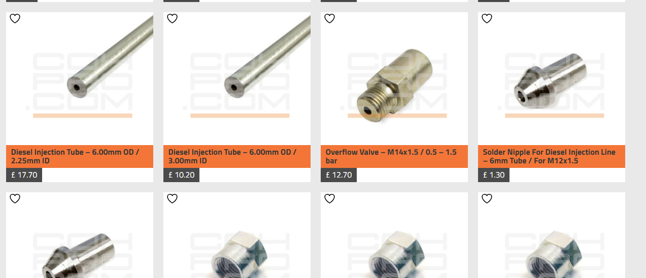

Not sure if they have the right stuff or if it's useful without lots of work, but if you wanted to modify injection lines
https://cohpro.com/product-category/metal-tube-fittings/diesel-fuel-injection/

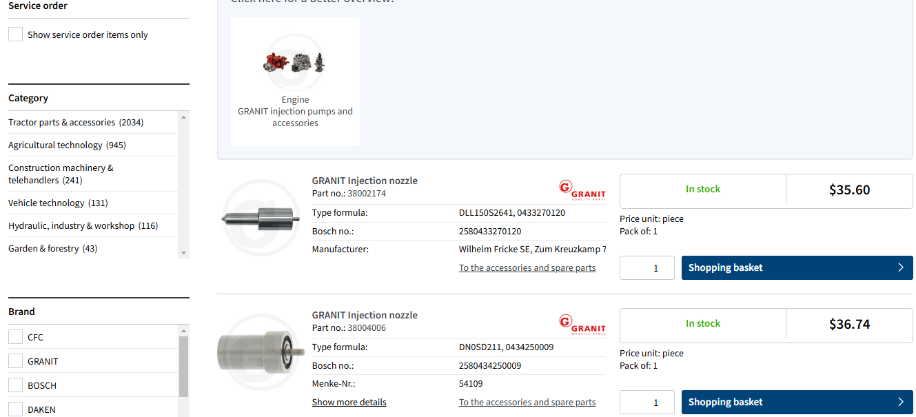

Lots of stuff in this place too including lines, you have to look around the site
https://www.granit-parts.us/e/search?q=injection
