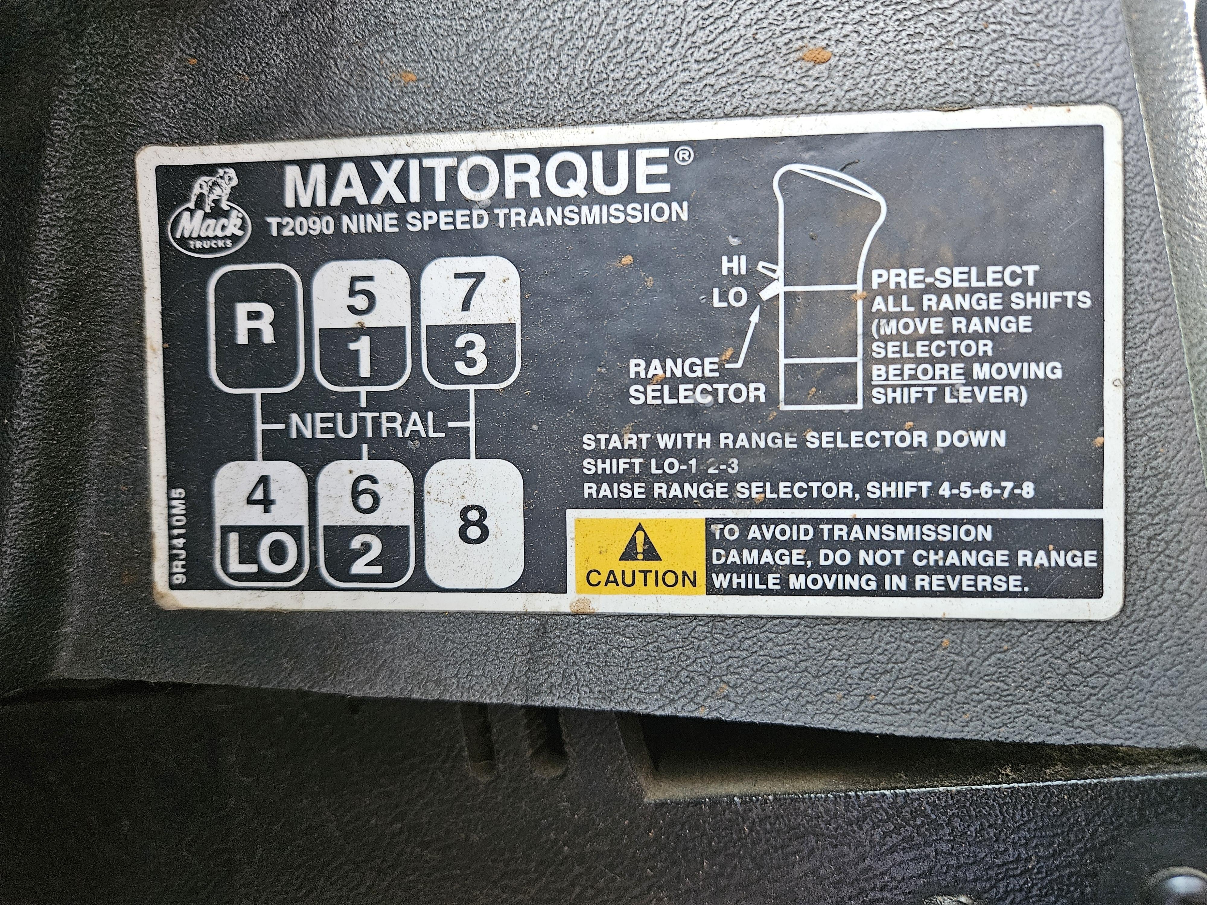

I have a 2000 ch613 that recently started clicking in the high range gears. It's a 10 speed and it mostly does it in gear 4, which is the 1st high range gear. And it only does it when I let off the accelerator and the engine is slowing the truck down. It clicks and feels like it's coming out of gear. Not sure what it might be please help!!

I know it's a mack transmission but not sure of the model. I think it's either 4 or 5th gear that's the 1st high range, not sure which one. But it's clicking in the 1st 3 high range gears now. It only does it when I let off the accelerator and the engine/transmission is holding the truck back. Feels like it wants to come out of gear or something. Where would I find the model # of the transmission?
  • 0
ok, now it makes sense..  that transmission does not shift like a typical 8/9 10.. and so on.  so when you pre-select before going to 4th, is it not shifting right as you pass through nuetral?
