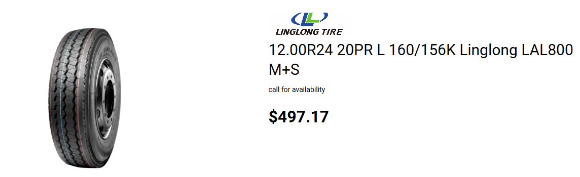

https://www.otrusa.com/shop/truck-tires/12-00r24-20pr-l-160-156k-linglong-lal800-ms/?srsltid=AfmBOopa_Op2361UBDUbypmffY1vtG0m9YNmX3AcpLXIvXjdEOOA-6YJ

2 minutes ago, Geoff Weeks said:
On the spec sheet those are listed as TT or tube type.
They still will not install them?
I kind of get the feeling that there was some miscommunication at the tire shop. I get young guys all the time who don't know a 11r24.5 is a 10r22 and so on. Tube type sizes are ancient history to them

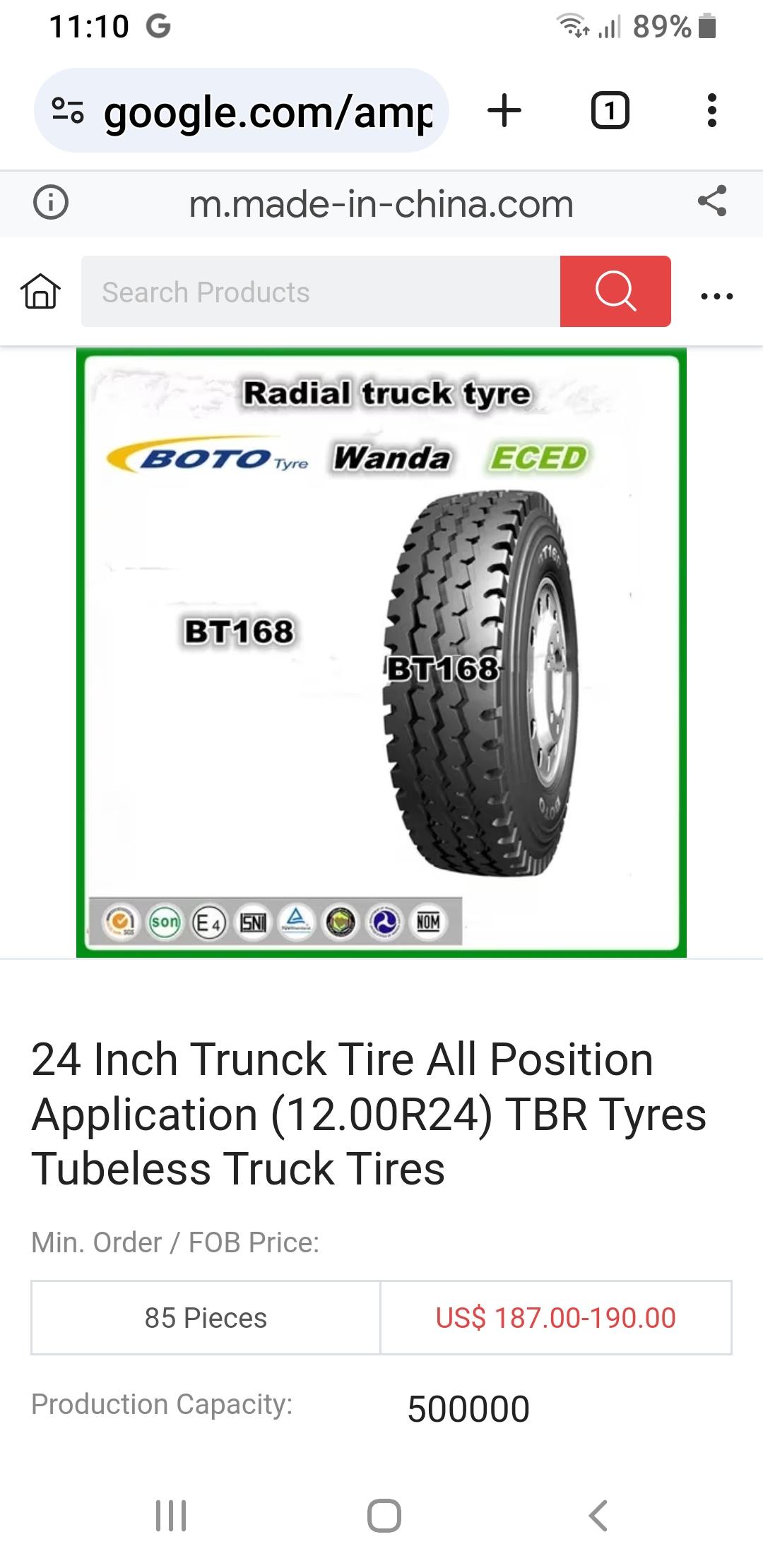

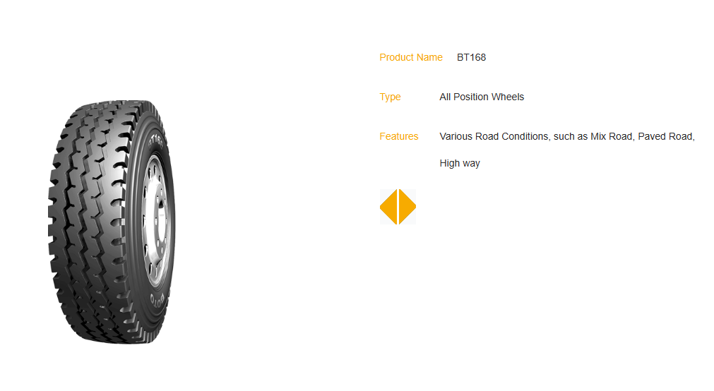

The above is from Winda-BOTO's tire specs. The 12.00R24 is TT (Tube Type)  it would say TL (tubeless) in the 3rd column if it were tubeless.
Either your tire supplier has no idea what they are talking about, or they are ordering 12x 24.5 (I don't think there is even a tire that size) tubeless which are not the same.
If they can't read a tire catalog or don't know the difference, it is time to find a dealer that knows their trade.
Please Have them show you, so your can show me, where they are finding tubeless 12R24 tires!
To the best of my knowledge there are no tubeless 24" tires made for highway service.

Well I got back down to the tyre depot and the guy there said 24in tubeless tyres are widely available from a few different companys...all in China.The tyres are highway radial tyres and are the most common truck tyre in China.Boto and Long March are two of the companys he said make them......
