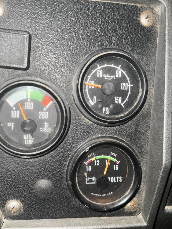

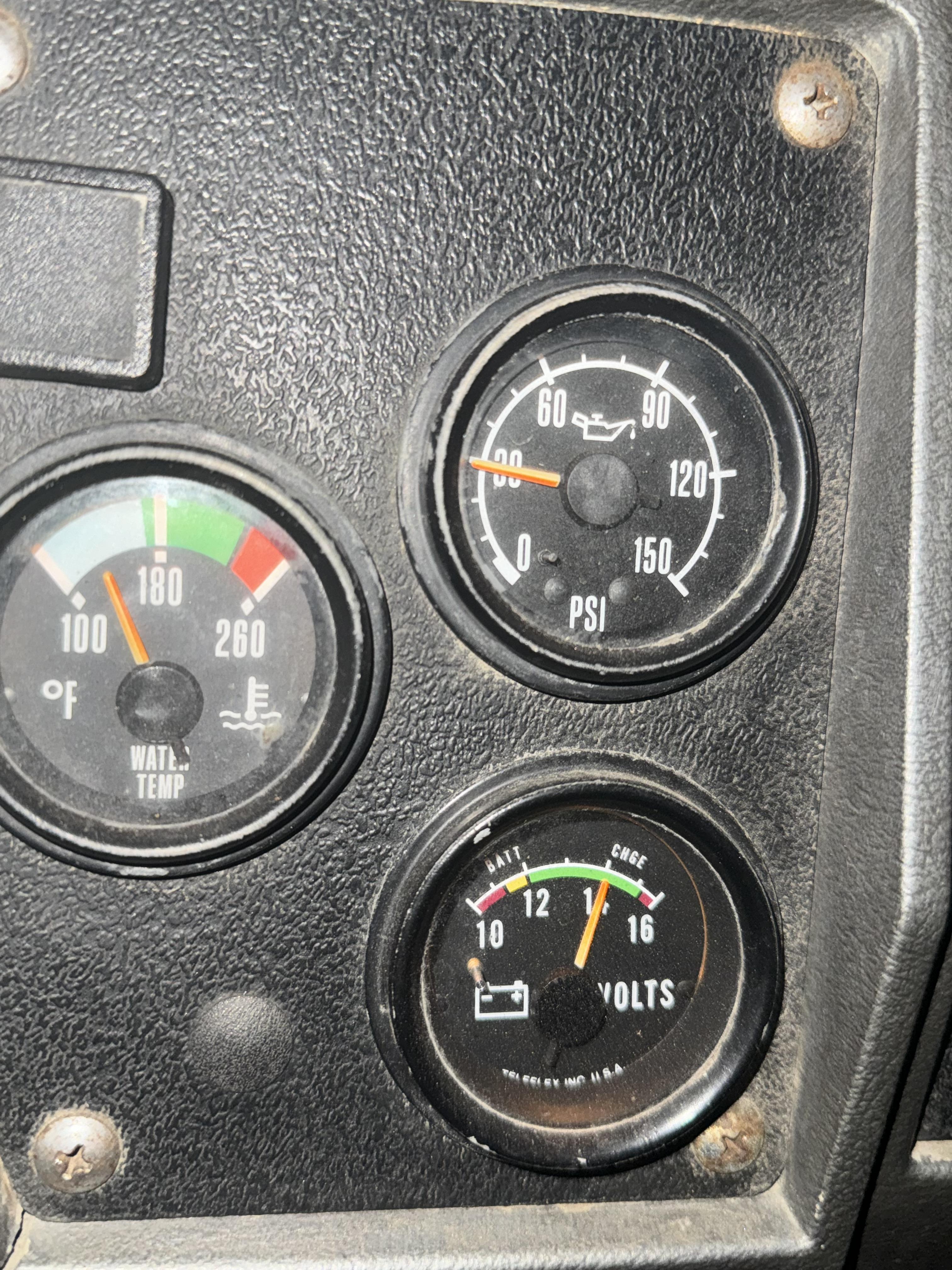

My e7 has over 600000
on it my oil pressure after about 25/30 mins is around 35/40
use to be higher should I be looking to roll some bearings in or just keep up the maintenance and keep riding
truck runs and drives great

are those gauges showing numbers at low idle?  625-650rpm? I see you are not at 180 degrees,  what is it at 180?  to me, it looks good given the current pics.  20+ at hot idle is normal for an older worked engine.  40+ going down the road is good too.  I suspect 65+ on cold start up in the morning..   so long as oil changes are done in the correct interval..
