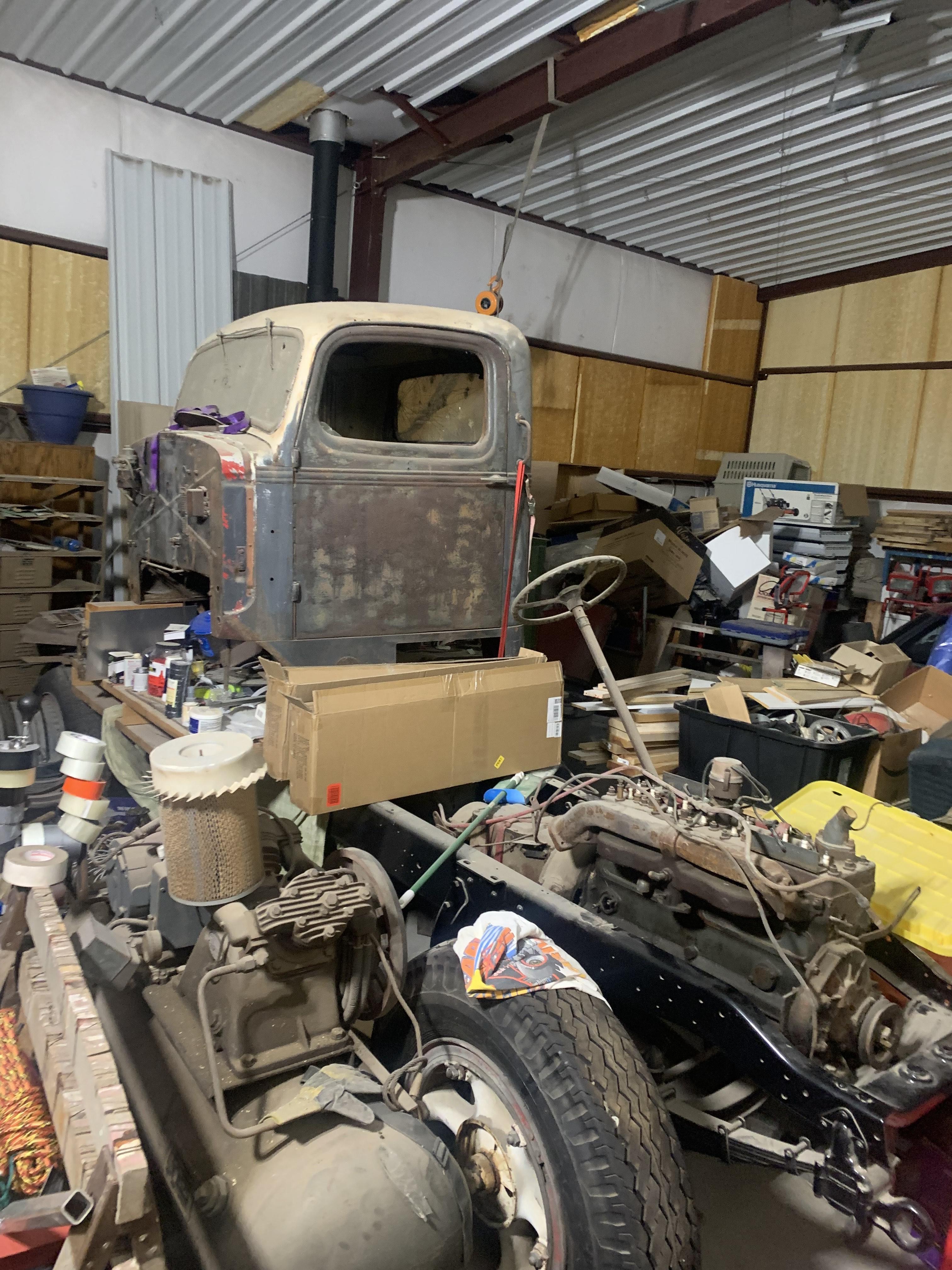

Hello! Brief introduction about myself (it will hopefully help explain a few things) I am a young 20 year old. Years ago my dad bought a 47 Mack firetruck out of California and brought it to Utah. My dad started restoring the truck but didn't get it finished. My dad passed away about a year ago. No one in my family cares about the Mack besides me. I am wanting to finish restoring it in honor of my dad. I have very basic knowledge of vehicles, something to keep in mind. I want to keep this truck as original as I can, but I am open to changing a few things. Anyway, I have a 1947 Mack, the chassis is restored but the rest of it is not. We almost have every original part to the truck. I believe that the oil pump was broken off and crushed. I would love some more opinions on what I should do with the motor. Do I keep it original or should I do a motor swap? If anyone has knowledge that would be beneficial at all, I would love it! I do have pictures of the truck, if people are willing to help with opinions, then I will share those pictures. I will try to provide as much info as I can! Thank you!!

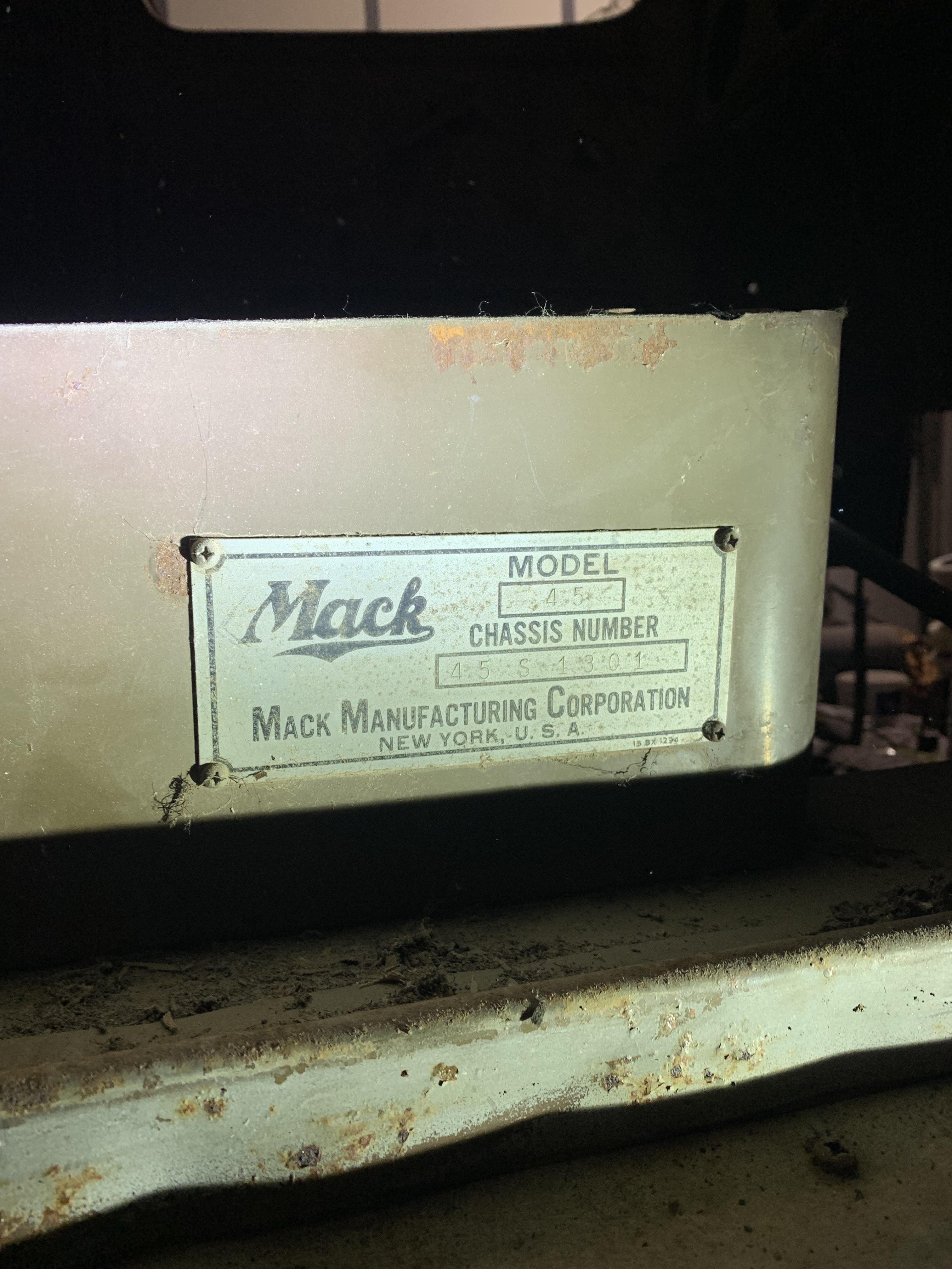

First try to find all the data plates you can.. Including both the chassis and whoever made the pump and body.. As FWD said with the serial number the Mack can provide a lot of info.. They are GREAT!!!! With the apparatus manufacturer and their data plates there are many sources for info and parts.

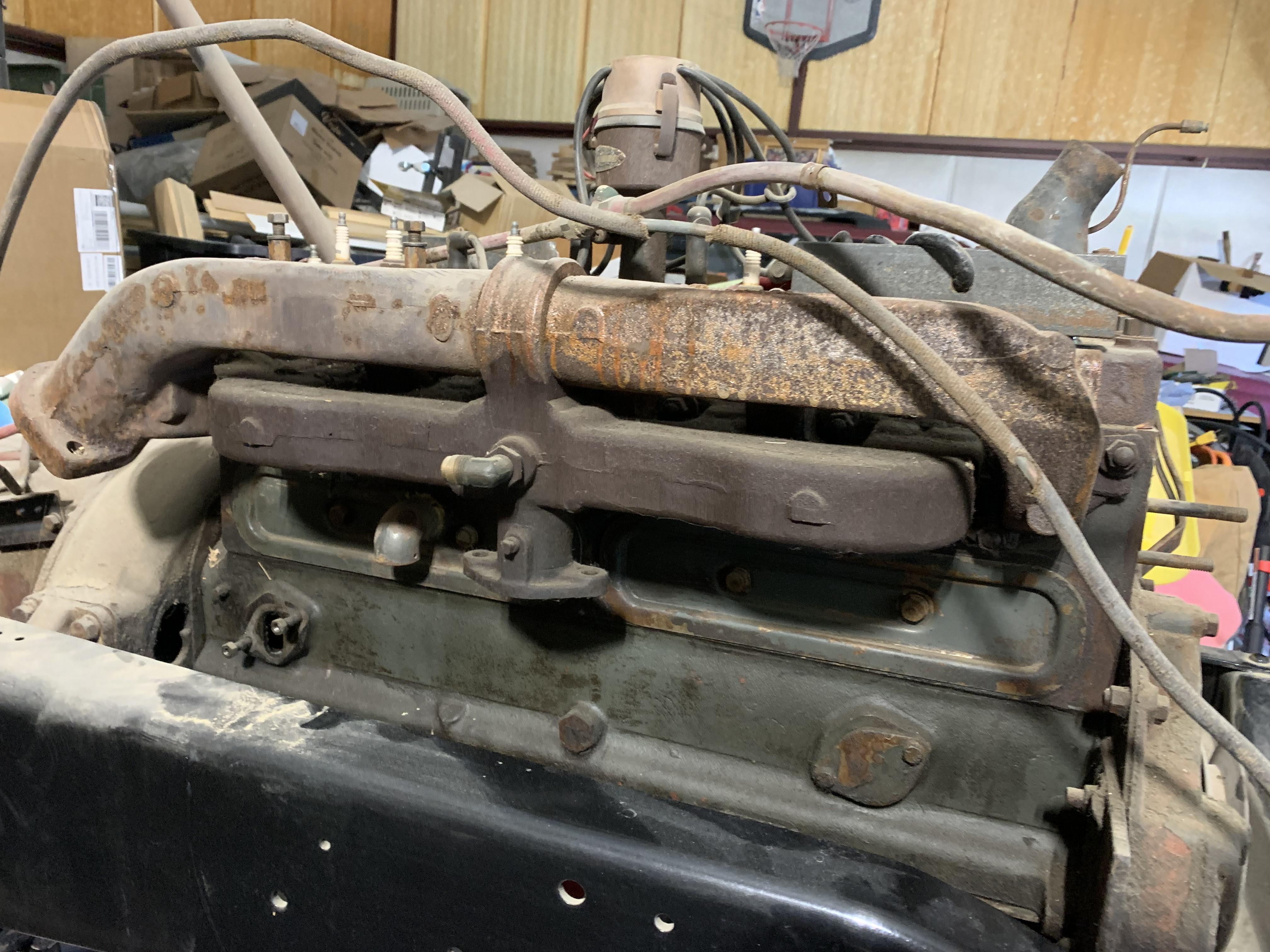

Thanks for the pictures James. Finding an oil pump for the 330 Continental engine should not be a problem. That engine was not only used in a lot of trucks, but it had dozens of industrial and agricultural applications. They are very good engines, too. There is a place that might even have a new old stock oil pump, Home Page - Montes Equipment   Here in the northeast there are still  a fair amount of old Brockways with that engine  to be found as well.
Well, you got something there that caught a lot of our attention. Most of us are interested in that old fire equipment and that’s exactly what I thought you were going to say about the oil pump. I bet you had fell off an engine crane I don’t know anything about those engines, but that’s what I hear. Everybody speak very highly of them. Looks like you got enough there to keep your hands full.
Steve, either Tom Millard or Stan Augustine had mentioned them on the old Brockway site several years ago.
James, either of the two mentioned above can help you with Continental engines. If you need their email addresses please email / PM me thru here.

So the engine is somewhat pulled apart, would you recommend trying to put it back together the best I can to see if there is anything else I am missing? The motor hasn’t been turned over in years so I have no idea what the internal side of it looks like. What would be the best way of going about cleaning it up and putting the motor and transmission back together? Is that something that would be best with the cab back on?
I would work with the engine first and before you do anything take out all the spark plugs and just shoot a bunch of mystery oil into  all the cylinders and let it sit while you’re hunting parts there might be nothing wrong with the engine
Yes I would start with the engine. Pull the plugs, Put a bar on the front and see if it is free. Do you already have  the pan off?? If you do not have a cylinder scope to go thru the plug holes, make sure you can get a rebuild gasket set, and pull the head and pan to see if it is rebuildable??? If not you may have to consider a repower???  At he same time set the cab on a pallet and inspect it close.. That will tell you what is involved in the body work necessary. Do you have the fire apparatus body??? If so do a good inspection of it. Then take a good appraisal of your body work skills. A lot of your decisions will be how much of the work you can do yourself versus your checkbook!!!
Brocky
James, I like your plan!!! I thought I saw some new black paint on the frame rails.. So you have a head start there.. It looks like you have a fair sized shop to work in. With no serious rust thru problems, and some help from a body man you can learn to do the majority of the work yourself, and be able to tell the people who are admiring the truck "I did that myself"!! With no fire body, when you get that point, you can then go with a flatbed, with stake sides, grain body, or even a roll back???
