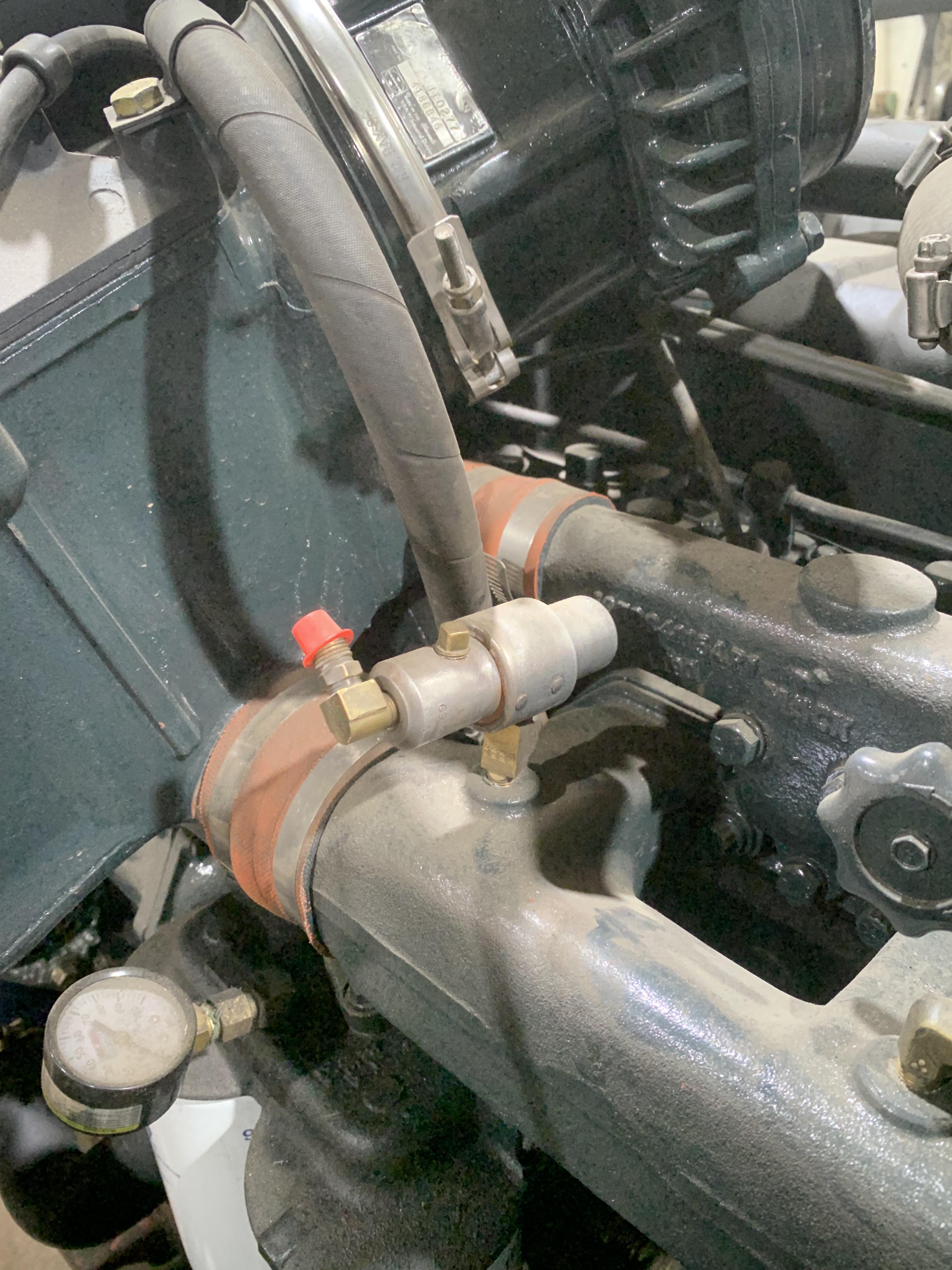

Yes, that is my question, is there a port somewhere already that I have not noticed or do I have to add one. It appears that the title of this thread has caused some confusion. I only mentioned the tip turbine because, of course, the entire intake system between the turbo and head is unique to this system and it is so where in that system that a port will be if one already exists.
https://www.bigmacktrucks.com/topic/74727-tip-turbine-boost/#findComment-561615
Looks like a solenoid valve for an air fan clutch? no idea why that is there. There looks to be another port at the next intake runner as well. Has a 90 deg fitting that is cut off at the edge of the picture.  Any of them would be a place for a boost gauge.
https://www.bigmacktrucks.com/topic/74727-tip-turbine-boost/#findComment-561622
Not to up on that era Mack stuff, but I always liked the Tip-Turbine set-up. A better solution than Cummins low-flow cooling, for the same problem. How do you aftercool better than engine coolant can? How do you do it and fit the engine into current vehicles without re-designing the front end? Cat didn't try, Cummins tried to "super-cool" the coolant before it entered the engine, Mack decided to pull air from outside the hood, to pass through an air to air inside the hood.
https://www.bigmacktrucks.com/topic/74727-tip-turbine-boost/#findComment-561624
I took that “gizmo” off and searched the part number and, yes, it is a puff limiter (whatever that is). I’ll pull the boost signal from that port. Thanks to all for the replies.

If the puff limiter works and is shimmed correctly, it should have minimal smoke and run about as good as it's gonna run.  That "gizmo"  would have got air when the parking brakes were released and then it would regulate the rack's travel according to manifold pressure.  Over fueling is never good. Looks cool when you're 23 or so..... then when you pay for it a couple times, not so cool.

The puff limiter is disabled on our Cruiseliner because its leaking air badly down at the injector pump.We are looking for one but no luck finding one yet.Can they be repaired? Or is it just a throw away part?
