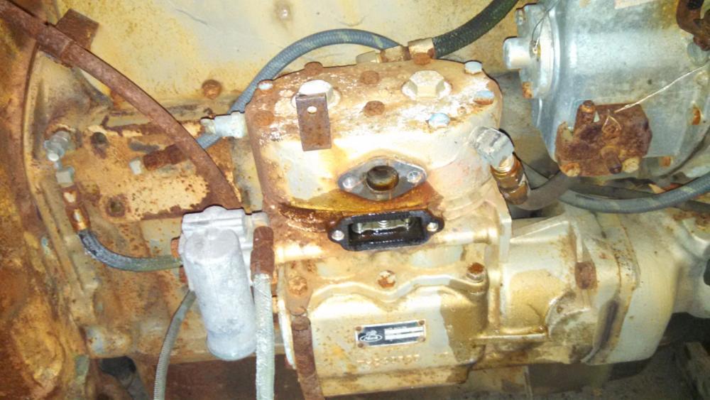

Looking through the pics I took of this engine before tearing it down and the air intake for the compressor has me scratching my head.  There is a hose that comes from the head of the compressor (which should be the air intake ) but the hose goes to a fitting on the lower side of the compressor?  This arrangement seems illogical to me. Can someone confirm how this is supposed to be. OK, so I can’t seem to be able to post the pic (must be too big). So that fitting that the hose goes to is just below and behind the governor bolted to a rectangle boss.

it sounds like its wrong.  why would they suck crankcase pressure into the compressor if that is what I am understanding? ..  I too am curios..

The upper port, in the head, is the output.  The lower port just below is the intake.  Mine has a small box with foam filter bolted directly to compressor . Many older trucks had rubber hose coming from air cleaner tube up at engine.
This is picture of my 237 before stripping it down and getting it installed.  I already removed the fittings from the compressor.  I actually installed the compressor from my 673 because it was already rebuilt.
