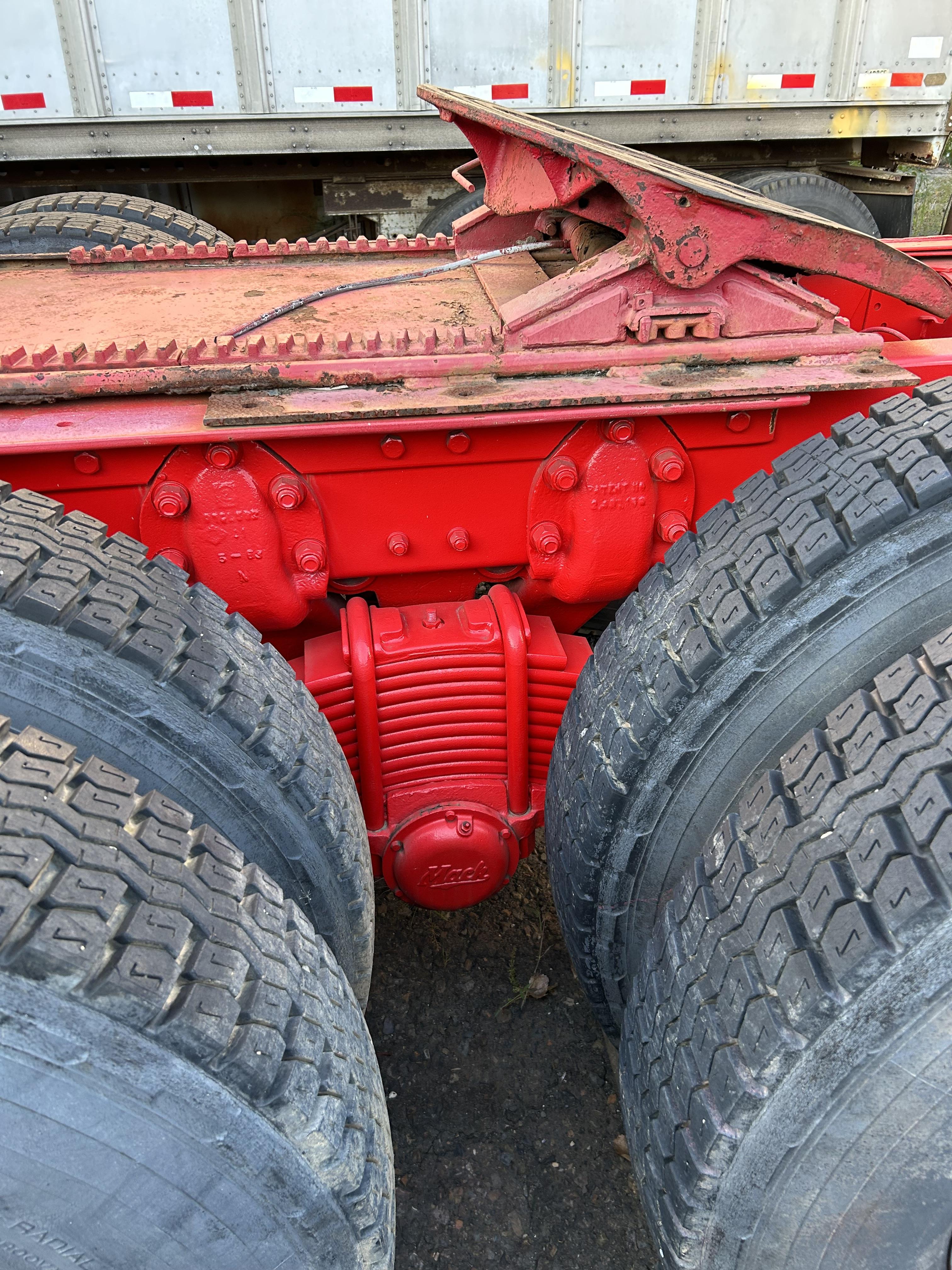

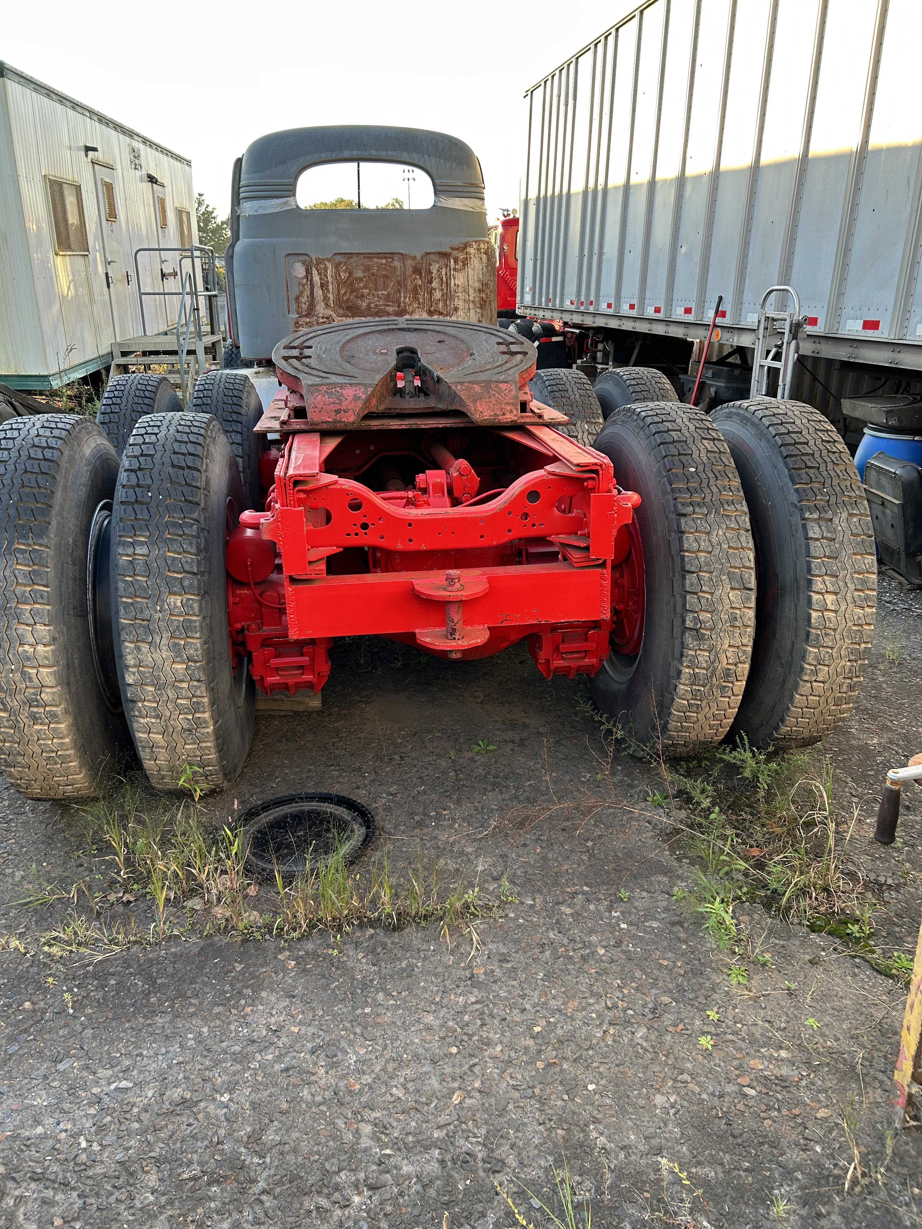

I am thinking of doing this to make the painting that much easier.Has anyone here done it before.It doesn’t look all that tough to do.My biggest concern is it has 65,000 lbs rears and canal back suspension.The truck has moved 100 ton before so I’m concerned with anything springing and not able to get it back together.

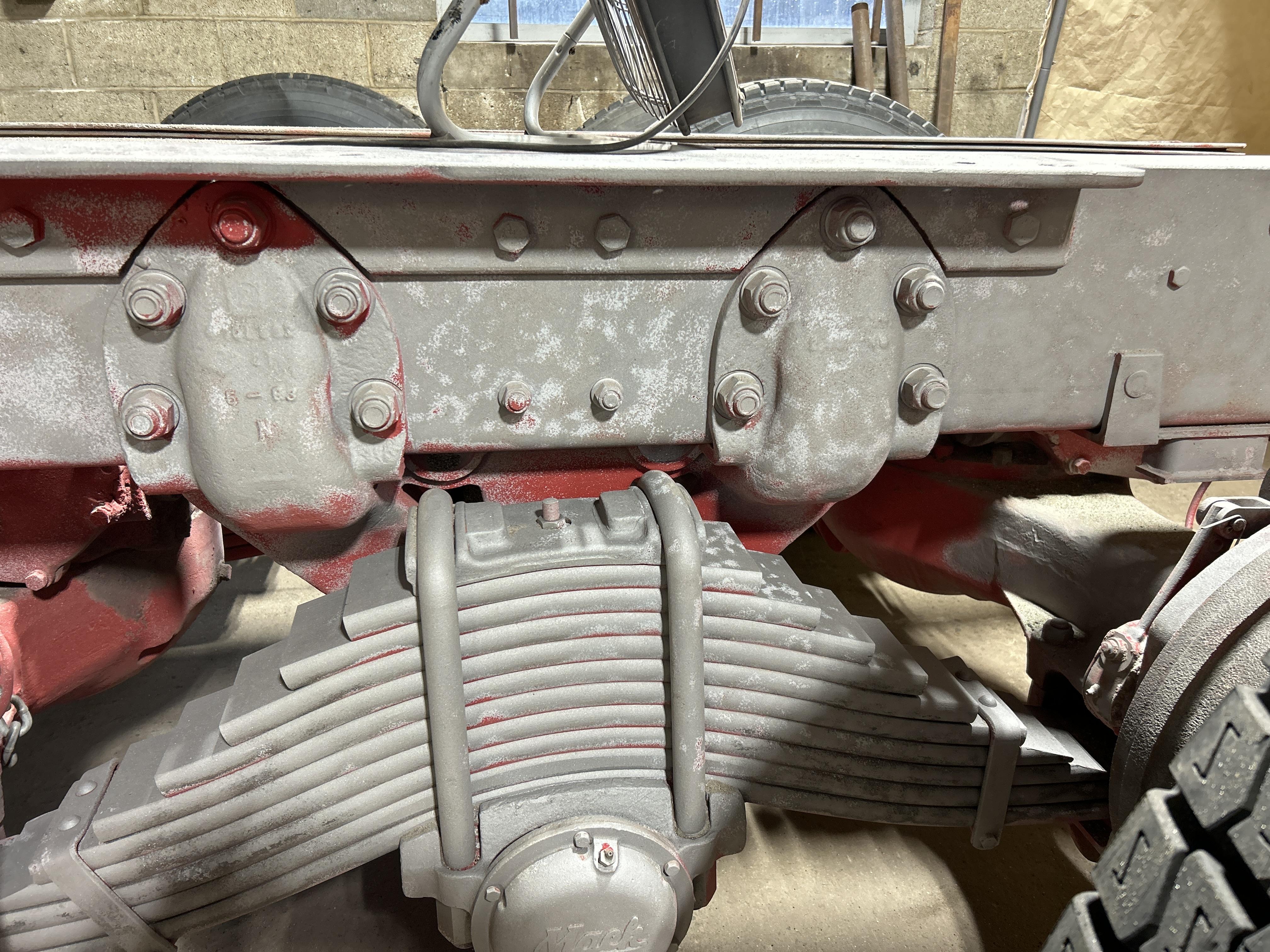

The only thing holding the bogies on is the two trunnion caps underneath the trunnion bar right,once removed jack up the rails disconnect drive shaft,and air lines and roll em out..
Mack’s,no removing the caps won’t do it.I have to remove the 10-1  1/2 locking nut and the 2 torque rods on top.Then I will be able to slide them out.

On this setup I believe the crossmember inside the tandem unbolts I have a truck with this setup, but I've never pulled it apart.  Trunnion bar underneath has bolt on caps underneath, so depending on what you're trying to accomplish you probably have a few options.  You could unbolts the trunnion bar caps and lift the truck off the suspension/tears.  Whatever you're thinking it requires lots of room and big toys to get this job done, everything is heavy!!!
That’s the way I would go,then remove fifth wheel and plate should be plenty of room to sand blast and paint,chances are the trunnion caps and bolts will need replace anyway..
