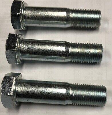

Those are all "body bound bolts" They have a shank that is larger than the threads. When you install them you ream the hole to tightly fit the shank of the bolt. That way the bolt also acts like a dowl pin. They don't come out easy. You are not going to spin the bolts. You have to spin the nuts off and then drive them out. Most times they get damaged while being driven out.
When you get new bolts the shank diameter and shank length are important. There are larger diameter shanks available because if you are swapping parts around you will need to ream the holes oversized and instal the larger OD bolts. Being you are using the same parts on the same frame rails, you won't have to ream the holes unless something gets damaged.

have lucked out removing the body bound bolts by removing the nylon lock nuts and washers; install a basic nut (5/8 -or 3/4 fine thread) fully on bolt than a B F sledge hammer rail the bolt. once it starts to move loosen nut keep hammering. brass round stock to finish removal. less chance of bolt damage. this technic is for days gone by when parts were reused not just thrown away and new installed.
Mech,  woould ou believe me if I told you that when I started fixing Macks only 25 years ago, that My mentor taught me about body bound bolts, and in years past, when I suggest using body bound bolts I get funny faces because they dont know about them, and then I hear, well I will just use grade 8 bolts, then I try to explain how the shoulder of the body bound bolt works.. I just had this convo, 2 months ago with 2 co-workers who were putting a steel flat bed on an F-450 with a gooseneck ball in it. The know -it-all guy said it wasnt neccesary.   anyway,  we'll see if the bed loosens up, the owner pulls 15,000 pounds with it..
I guess my point to them was a tight fit so the bed would'nt loosen up, and shear the bolts off..
Yeah, well I go back just shy of 50 years doing this full time and I remember getting them out and saving them or at least most of them, but older trucks that are run here in the northeast, and especially double frame trucks can be really stuck. But shop labor worth a lot of money anymore, so I just figure on buying new bolts if I have to do one. I'm up in Hazleton Pa and when you remove a mack trunnion in a double frame truck, bolts are usually the least of your worries, the damn rust jacking is your big worry.
Most anything still serviceable is way past body bound bolts and well into the huckbolt era. I remember my first exposure to body bound bolts. Guy thought it was funny watching me cut the head off with a torch and trying to drive it through the frame.
