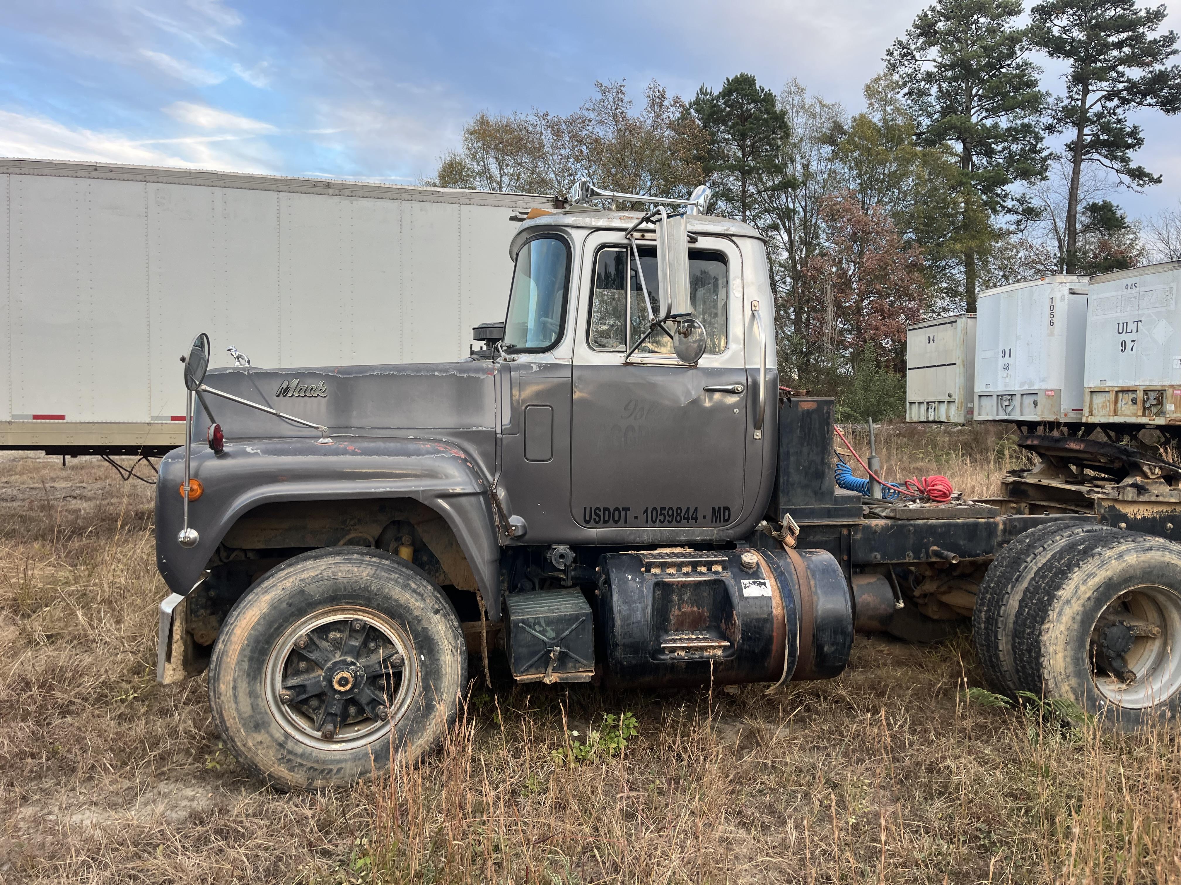

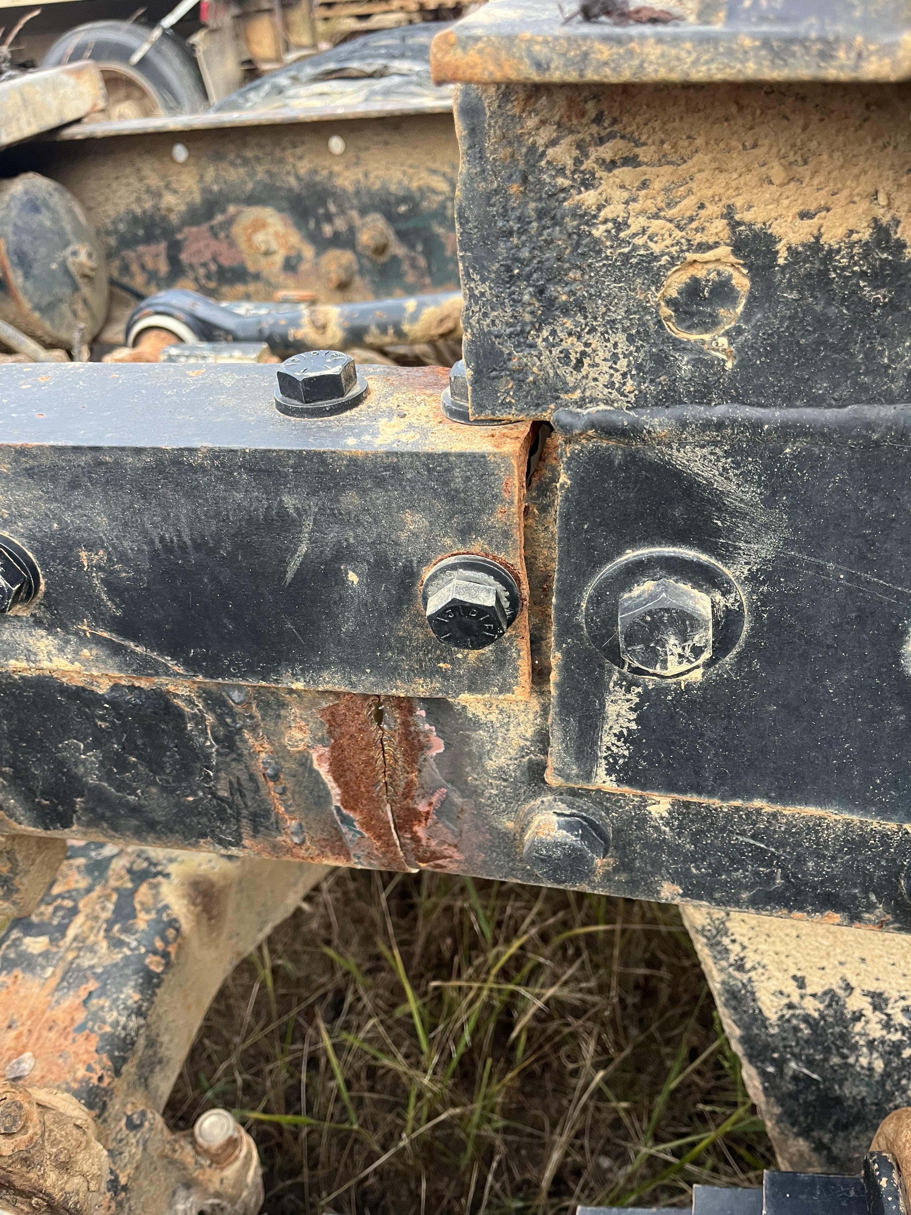

I have a 80 model R686ST. The frame is broken on both sides in front of the tandems. The previous owner was pulling dump trailers with it. I used it to spot log and chip trailers on a logging site. The other issue we had it was geared to high for our application. Really would like to fix frame.

since its a site truck, can you get 2 peices of inner frame from double frame truck, and overlap the cracks?  then weld the crack shut after the overlay is in?  A full frame replacement is a lot of work, even on a short truck like yours..  I know JoeH can atest to that...
