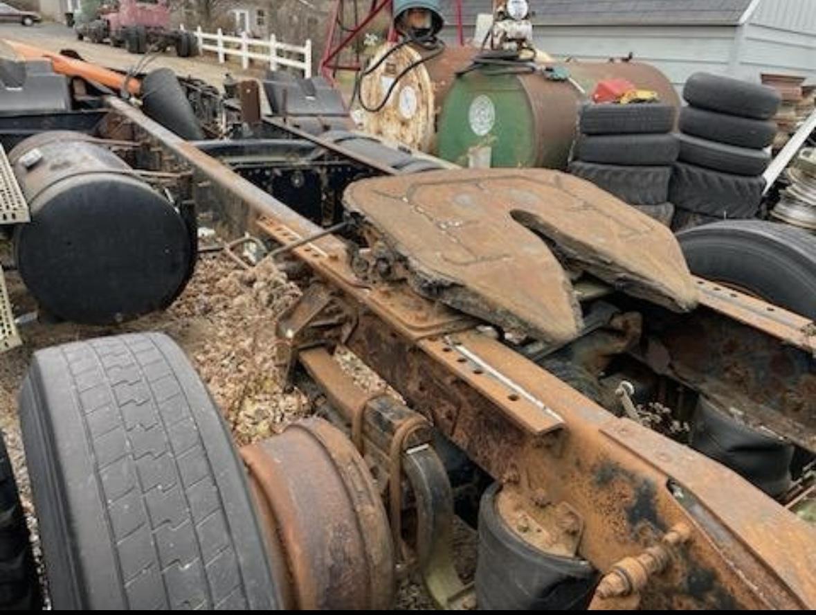

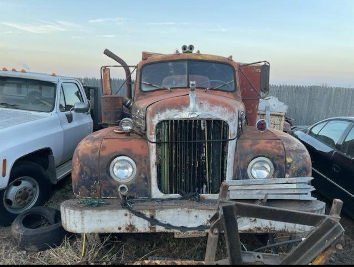

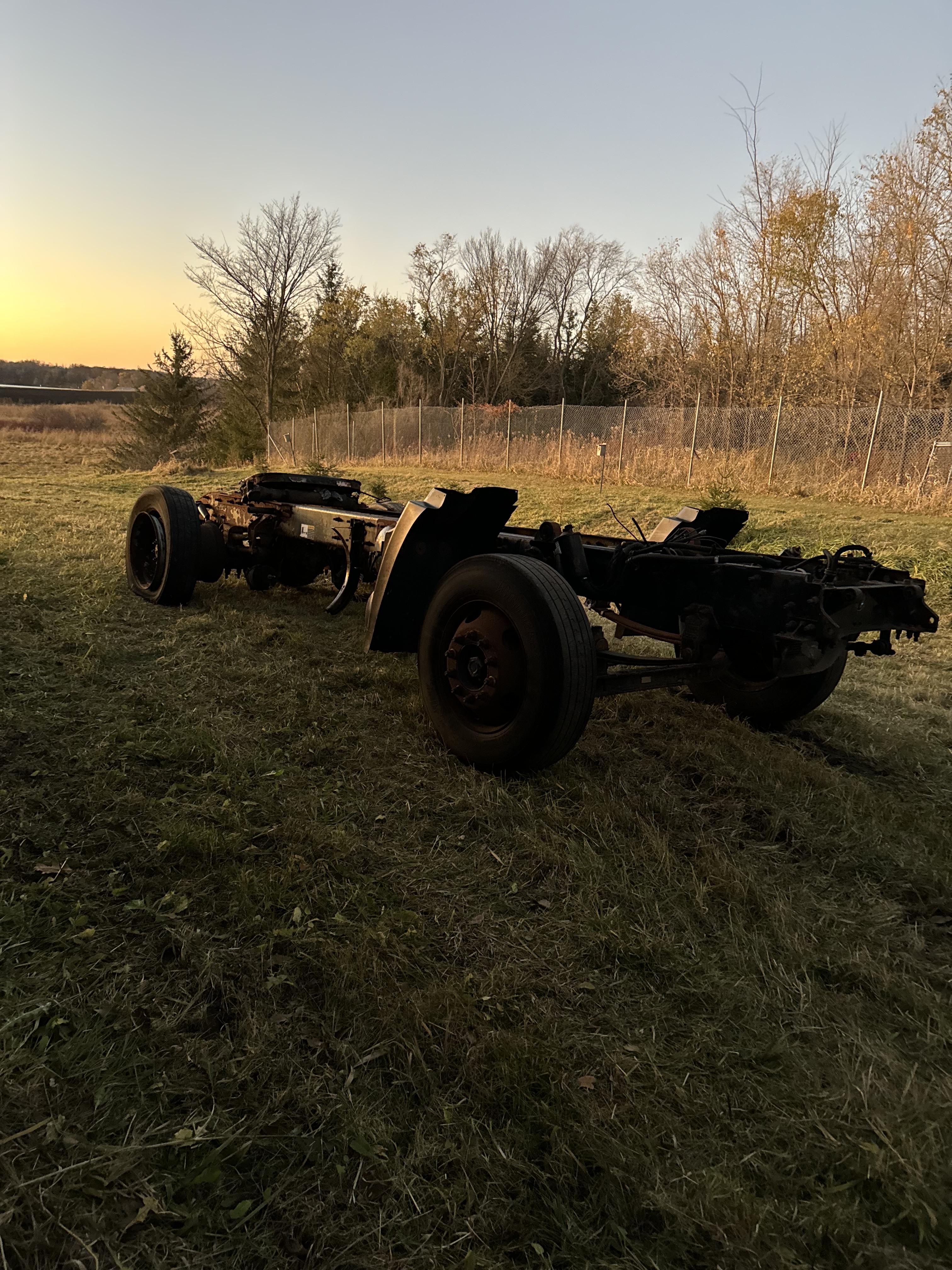

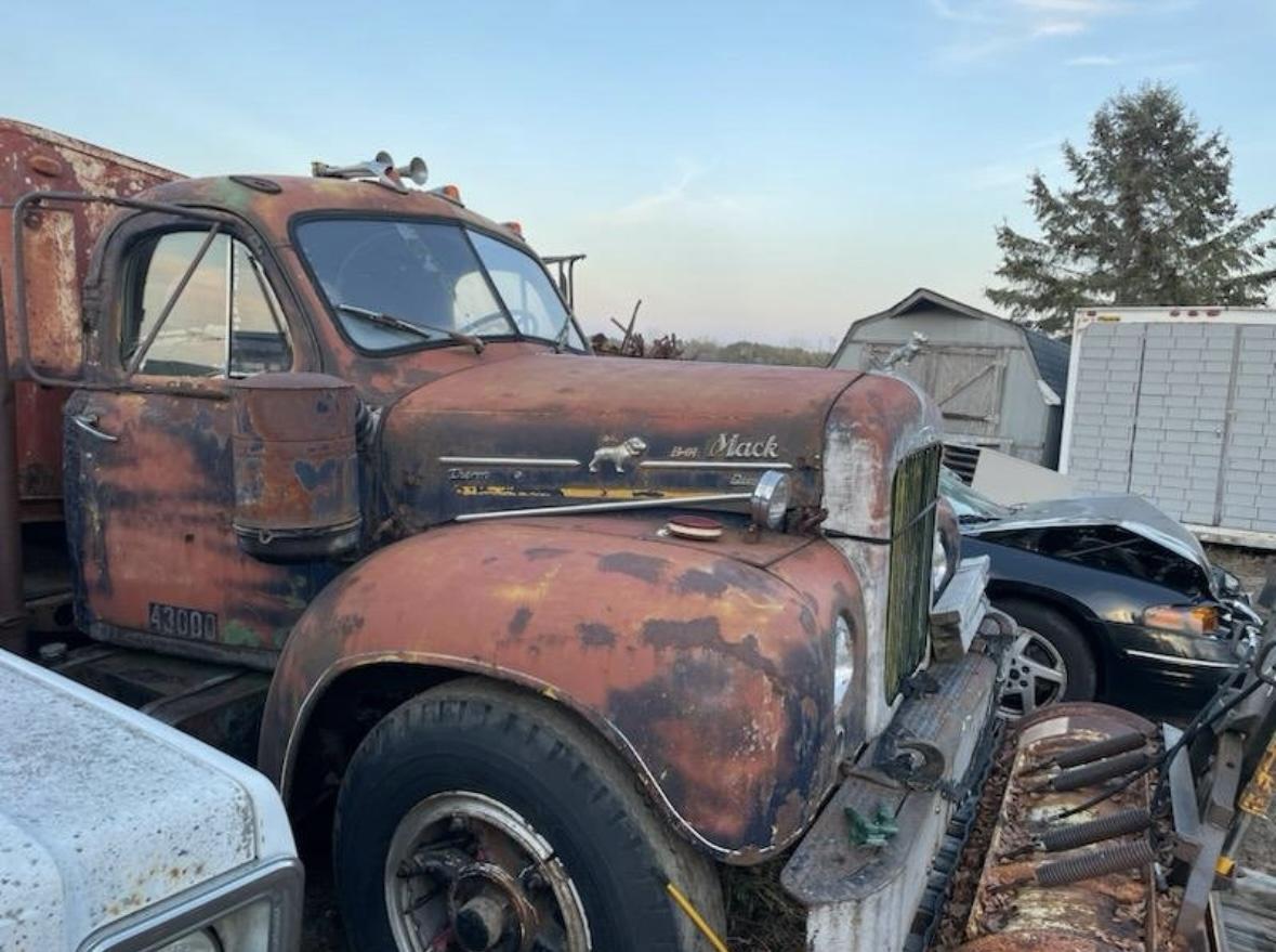

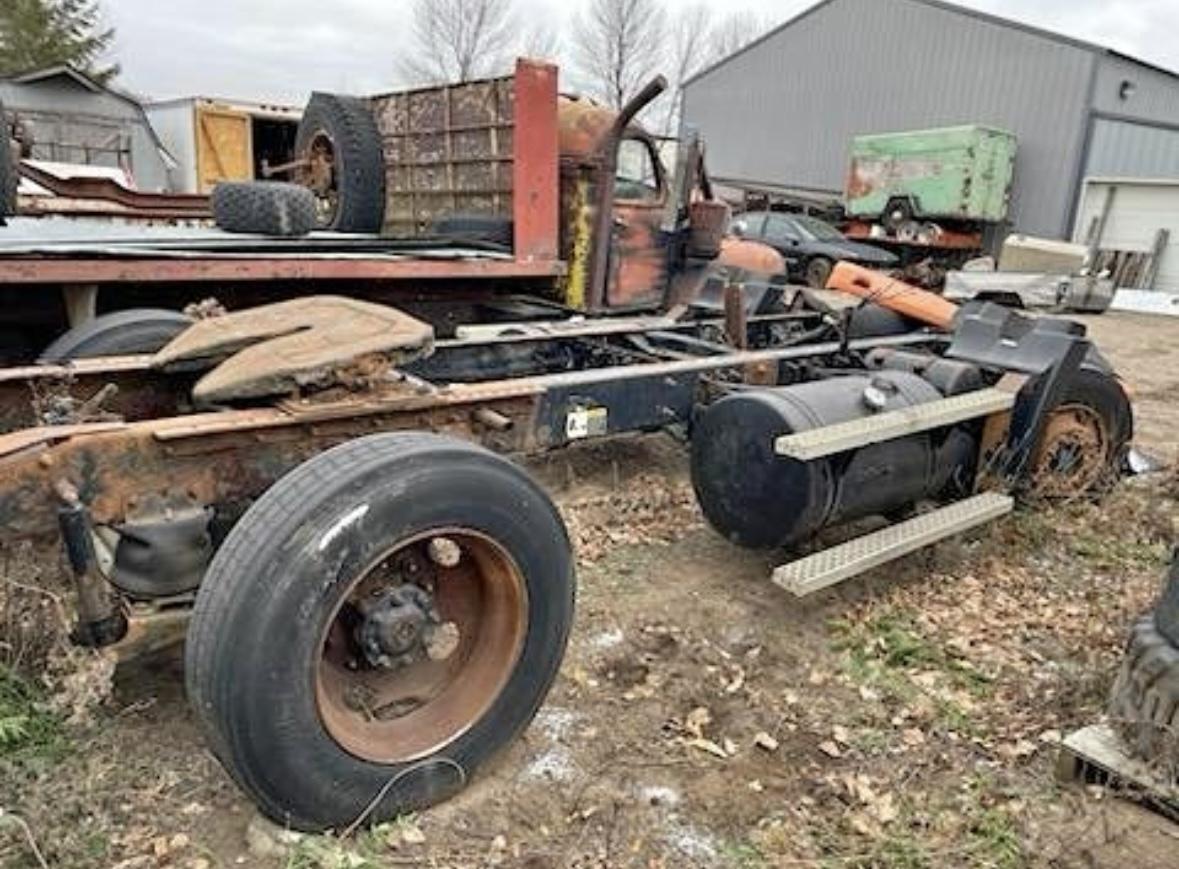

Here are some pictures of the frame…first one is at my place, others are at the previous owner, which also had the B61.

Hard to tell in the pics but the little bit if frame showing in the 3rd pic of the B61 show that frame to possibly be in pretty good shape, maybe as good or better than the CH frame. IMO, a lot easier to retrofit the air ride suspension to the B61 frame than the B61 cab to the CH frame (with the added bonus of the serial number on the door and frame matching when you are done. However, I suspect that the CH frame has a power steering box (and you probably want that) BUT, how will that line up with the B61 column?????, don’t know but probably not. There is a LOT to consider when doing acab swap like that, steering, clutch, cab mounts etc. however, when it comes to the clutch, a frame swap MIGHT solve a few issues depending on what you go with for a trans. The B61 uses a “push” style clutch where most (all?) newer trucks run a “pull” clutch so the linkage works in opposite directions. When I was gearing up to do my b61 project, I went through many of the same ponderings that you are. I settled on an E350 ( because the deal seemed right) but I think the typical 237 swap is probably the best choice. Would love to follow your progress hope you keep the thread going. Thanks for sharing
I 100% agree. Cab swaps don't work out like they do in youtube videos. And those video guys never show how much of their poorly engineered modifications break when they are actually driven.
The only thing I have a different opinion on is, Leave the end673 in it. Put some fuel to it and even though it's a 9 millimeter pump, it will make all the power you'll ever need
Thank you all for the help and suggestions.  Funny enough, last night I was contemplating taking the front axle off the CH, and swapping it to the B chassis, and then cutting the CH frame, and put the air ride and a little more on the B as well.  I do know this will probably be a better choice in the long run.

Couple things, first, the axle on the CH is likely 2” wider than the b61 axle and as such, will set the wheels too far out relative to the fenders. Of course, this is the same for the rear but the rear will not show the width difference like the front will and, I don’t know how you would mount the front axle to a narrower frame due to the way they are mounted. Regarding the rear, while cutting off the frame and grafting it to the b61 frame is a common route to take, I chose to mount the suspension to the b61 frame. Was not difficult to do and, IMO looks a lot better and less “cobbled” together.
I kind of figured that the axle is wider, but haven't measured it yet to see how much.  I would like to keep the power steering, but understand that it may need to be modified from the CH a bit to work with the B.  Also want to keep the BUDD style hubs.
I certainly will take that idea into consideration, but I do question if the CH frame is a little longer.  Some time with a tape measure is in my future.  Some warmer weather wouldn't hurt either, as these are both outside at the moment.
