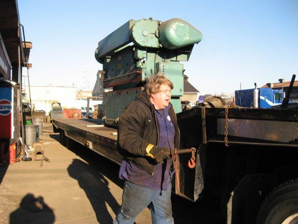

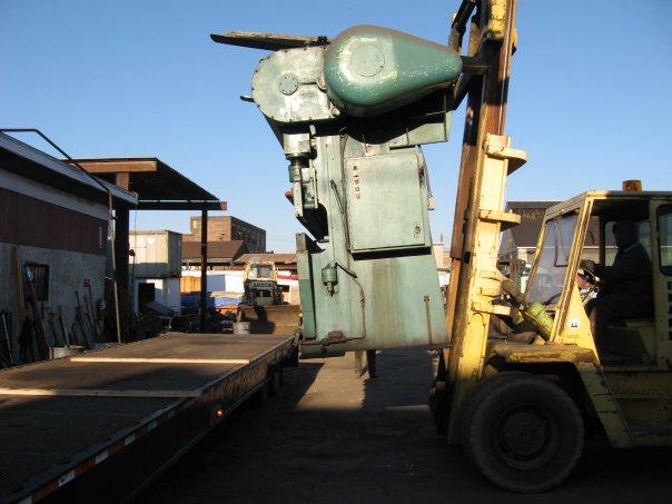

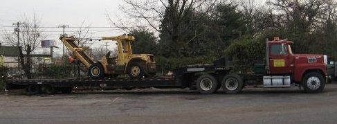

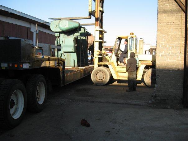

Running local I never put any kind of big milage on them. I think that Cat had like 350K when it broke. But I bought it when it was 10 years old, and who knows if the guy was testing and treating the coolant. A lot of my days are spent loading and unloading, running a forklift, taking preloaded trailers that were dropped in my yard to a construction site. Stuff like that keeps me from getting bored.
Some days I just take one of my forklifts out to load someone else's trucks. Although I've really been slowing down now because I'm getting older and I can't work like I did when I was 20 something or even 40 or 50 something
