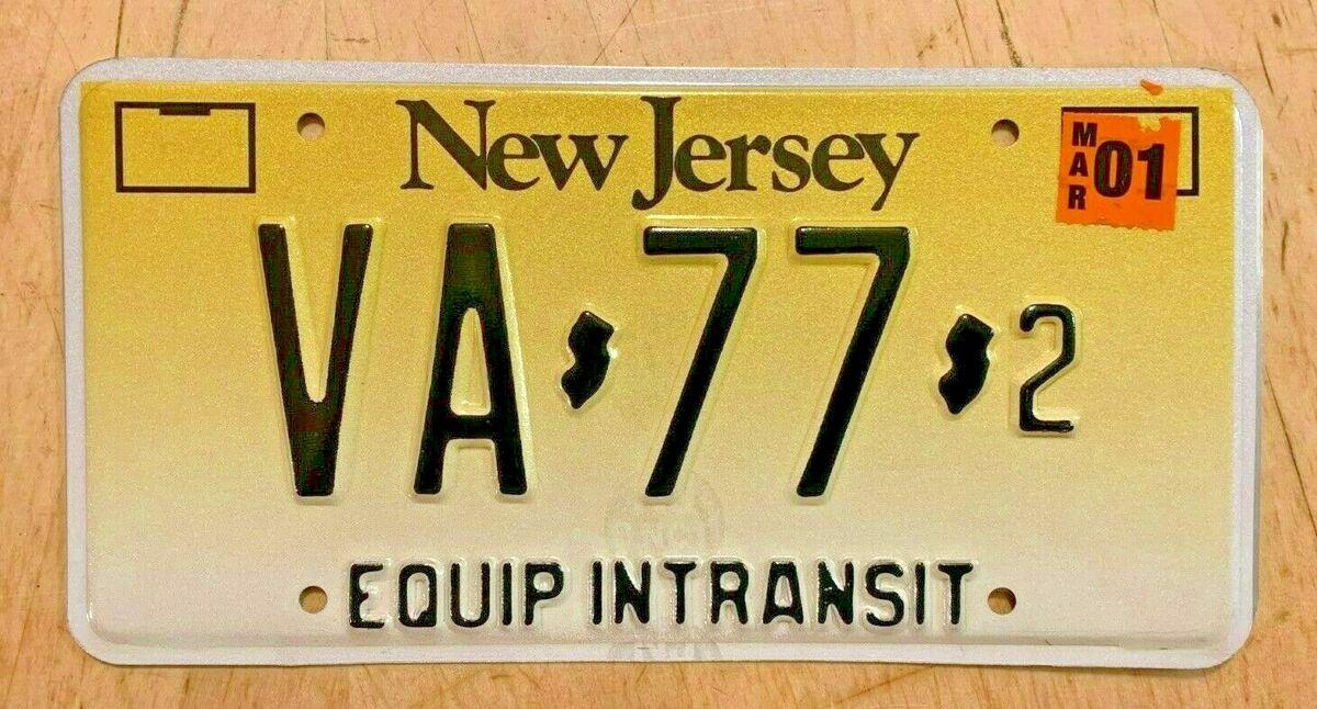

Like my NJ Code 56 Registration. I think they are 150 bucks for 10 plates. And no specific piece of equipment listed. No GVW either So all you have to do is bolt them on whatever you want to move that day.
Back in the day, guys in Philly would buy them, and run 5 heavy spec 10 wheel dumps on one pack of tags for 150  bucks. 1000 gallon tank of home heating oil at the yard, payroll done with envelopes full of cash, maybe half your drivers had licenses from Florida. It was a good time to be alive

In Illinois, it was a registration for a set vehicle, I don't remember all the specifics, I think a hub meter and bond were needed, but it has been decades since I looked into it.
get caught running in transit tags now in Jersey and it is a BIG fine unless you are empty and moving from one site to another.
a few years ago there was a contractor running transit tags on his snow plow trucks. trooper saw them, stopped them, and impounded all the trucks for working with transit tags.
I use mine for, compressors, generators, pumps, storage trailers, office trailers, stuff like that. But back in the day I saw them on all kinds of stuff. I remember a big ready mix company near Trenton who had them on half their mixers
