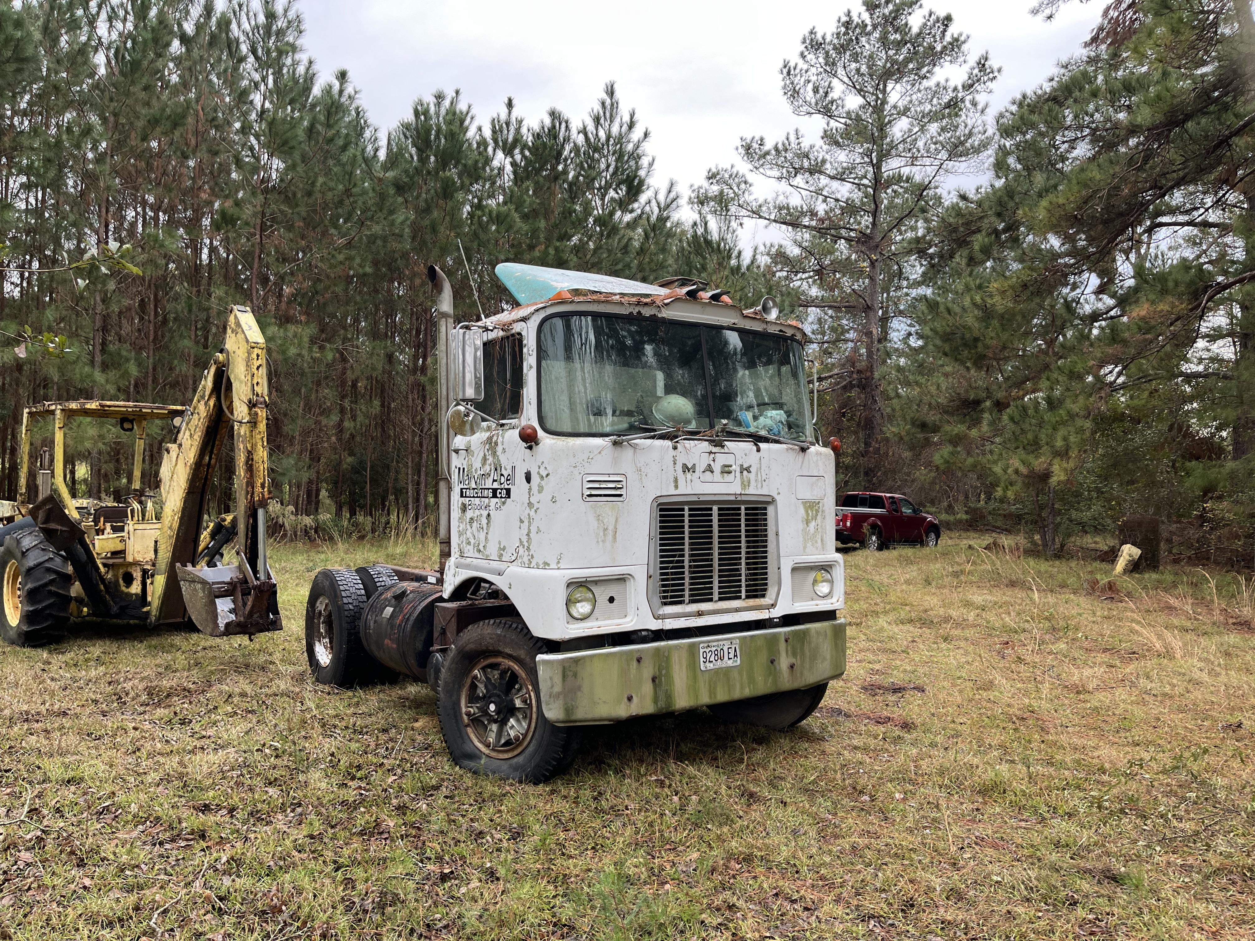

First try to roll the engine over with a bar on the front pulley bolt. If free, start from there.
I’m in Warner Robins Ga.   Found the truck in Bullock County Ga

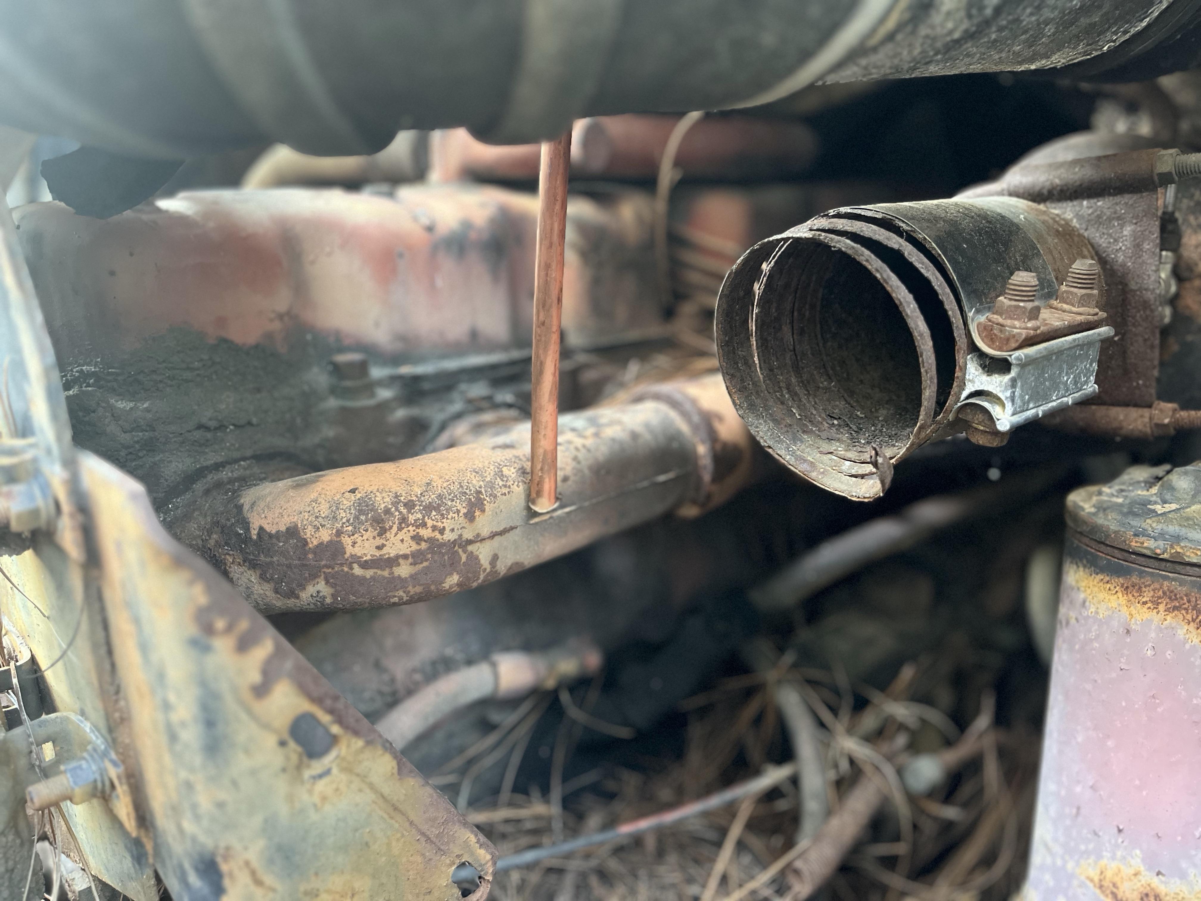

make sure you remove all the injectors and shoot a bunch of mystery oil into the cylinders and let it sit a week or so before you try to turn it over also remove inlet turbo oil line  and shoot oil into turbo bearing,,,and make sure the turbo spins free nice going bud,,,,,bob

Please add it to you profile.. Being a F-712 what engine does it have in it??? If it is a 2 stroke Detroit you have to make sure the rack is free or it will run away!!!!

Believe it’s a Mack motor with a 5speed.
if it is an 81, it should ne negative ground. as for 12 or 24 volt, you would have to look at the alternator and starter to be sure.
or it could throw a monkey wrench in the plans and be 12 volt electrical and 24 volt starter.

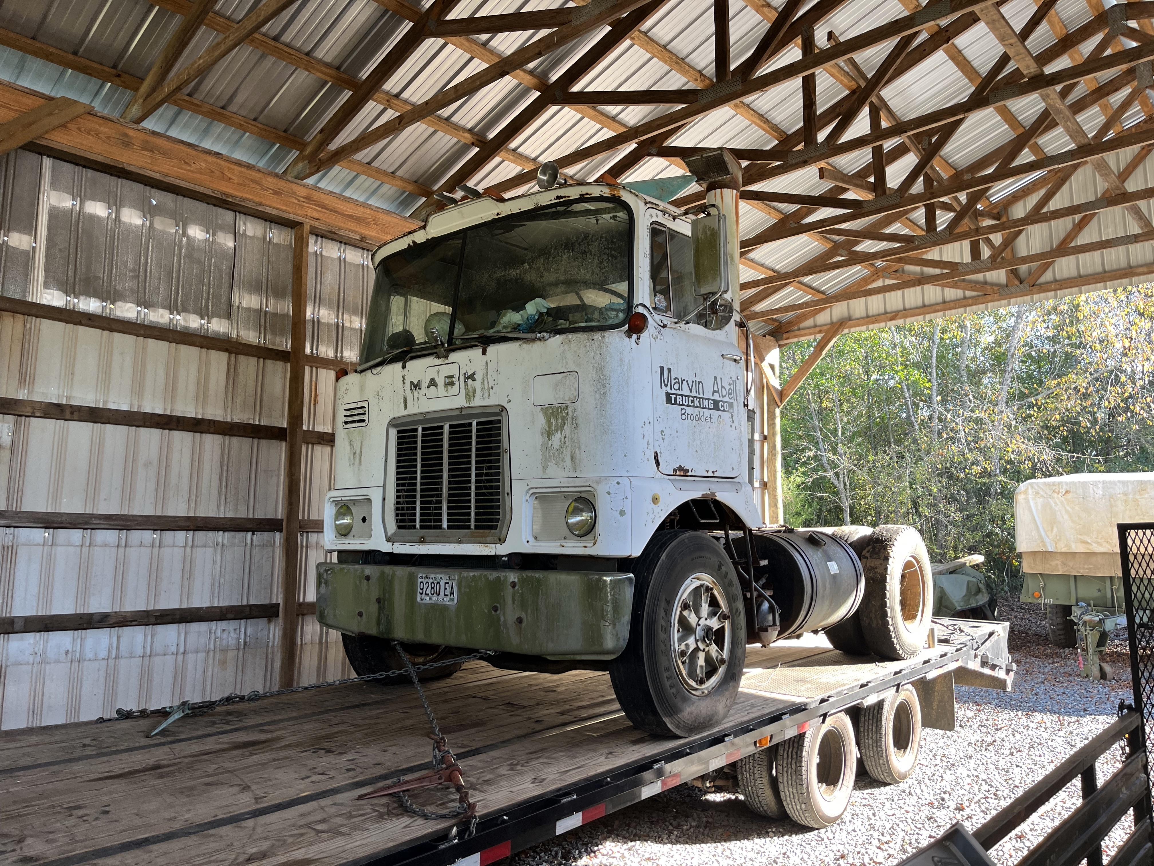

Glad you got it out of there! A few more years with those pine needles and there would have been nothing left of that truck.
Your brake and throttle pedal might be stuck so I would spray some stuff on those asap.
The cab is fairly decent.   Are you familiar with the truck?
