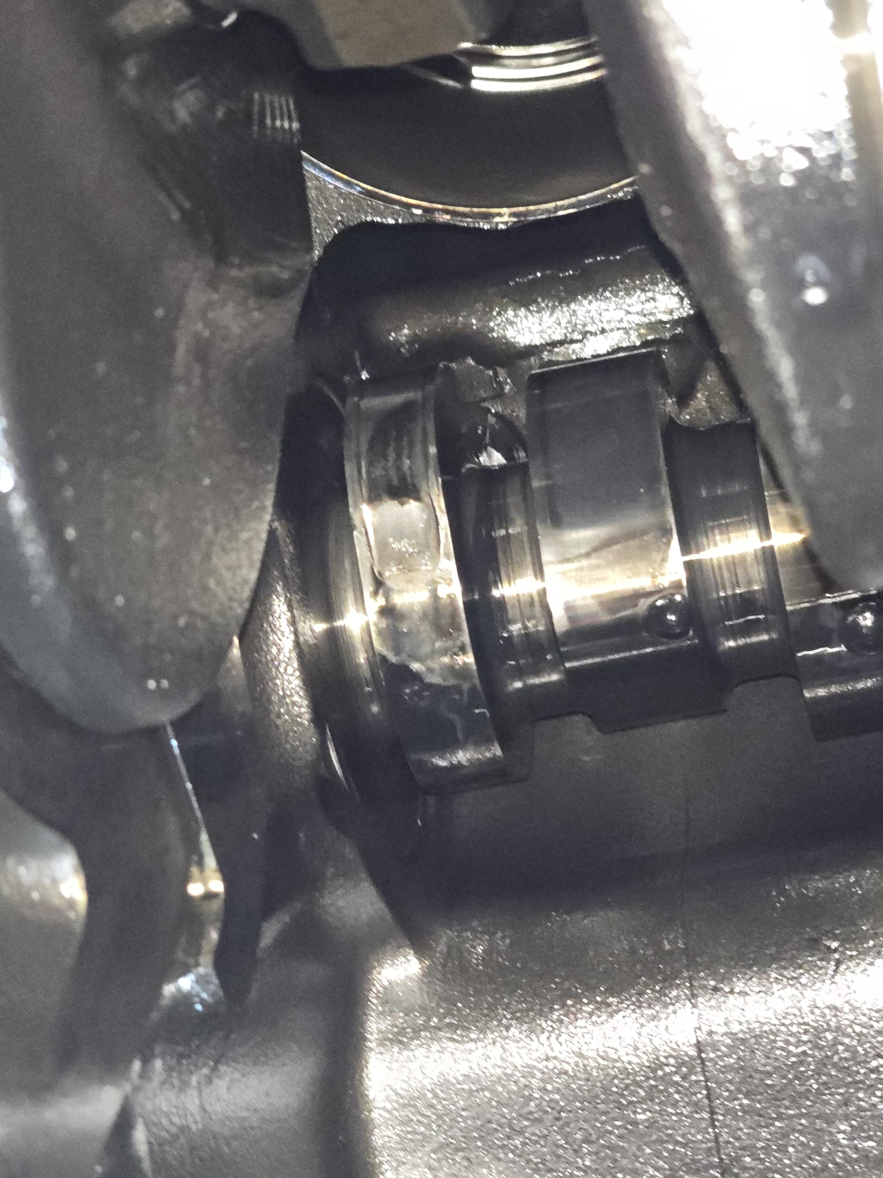

Motor has 700k on it. I think I'm gonna due full rebuild.
I wouldn't replace a cam without all new followers. You got the pan down already, roll rods and mains in it. Cheap insurance

I had a little more blow by than I liked. There is a few more things that I saw that was concerning. I will get you guys some more pics for your thoughts and opinions. Just figured out how to download pics. 😅
