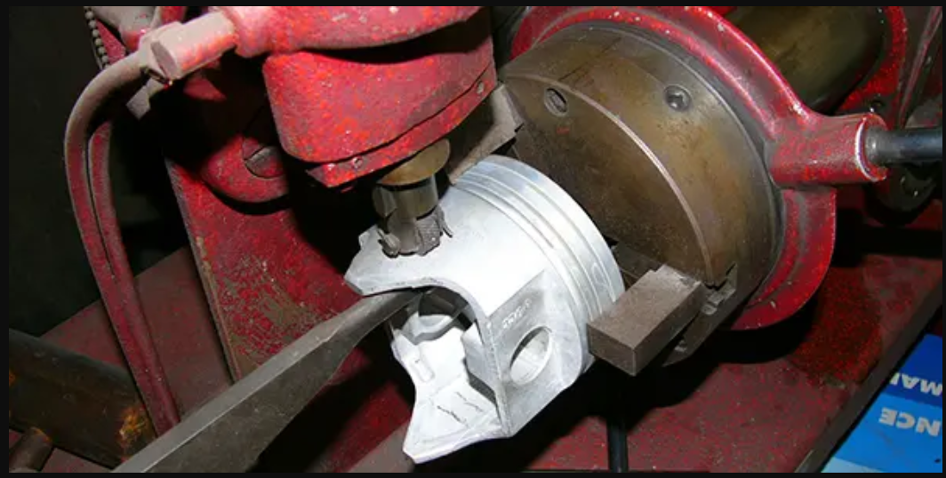

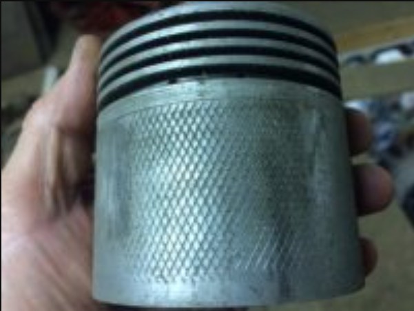

You know I keep seeing these pistonless liner kits more and more, have complete kits with pistons gotten that expensive?
Are we going to end up like back when I was a kid knurling piston skirts?

Haven't seen that done since high school auto mechanics class, along with knurling valve guides.   terry:MackLogo:
