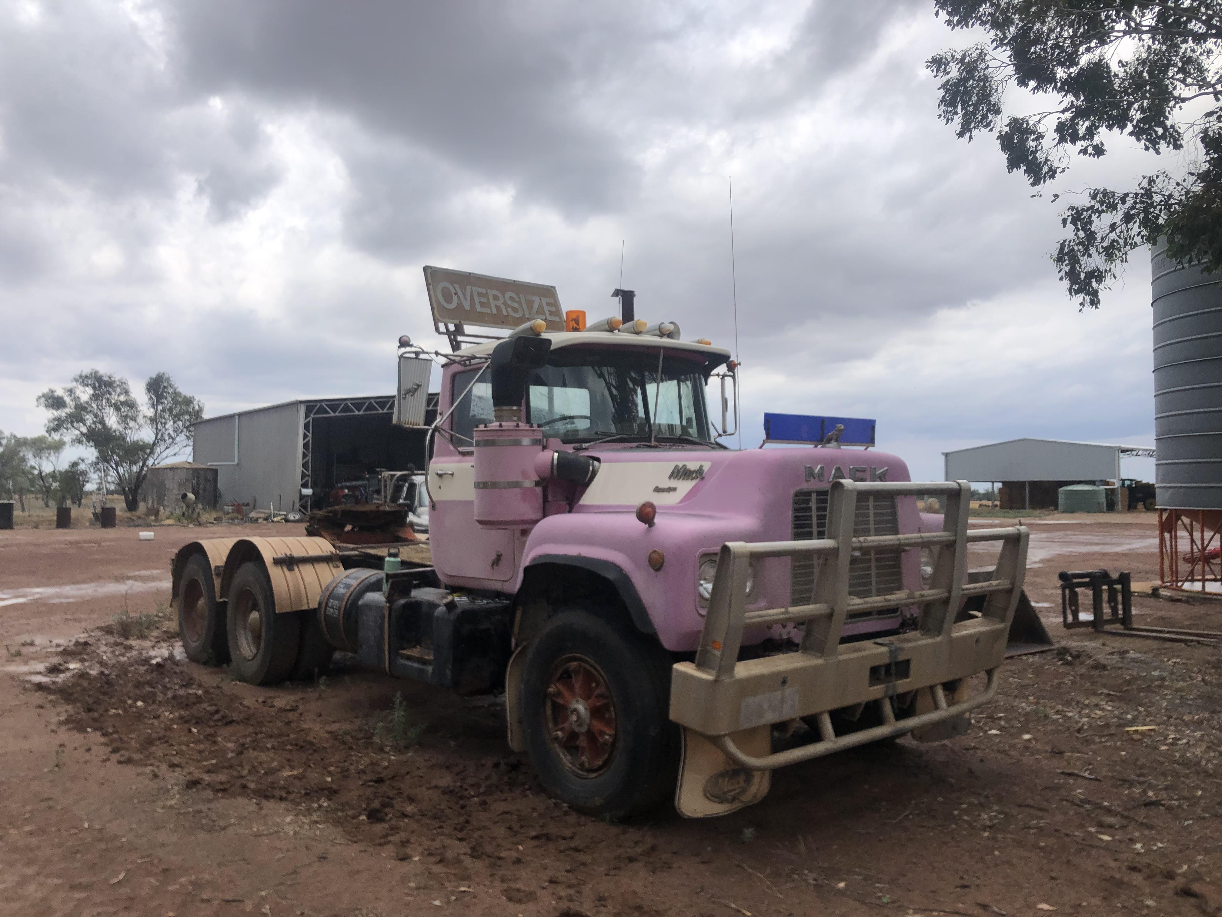

I’ve sent my vin to mack and they’ve come back saying it’s a 1979 R685RST.
can someone confirm what engine/gearbox and rear end these came with from factory?
From what I’ve seen it should have the maxidyne engine. It has a maxi dyne sticker on the dash yet has econodyne on both sides of the bonnet

R685ST is a 237 engine with a six speed, S means six wheel, T means. Tractor But hard telling what had been changed in the mean time.  Terry:MackLogo:

Should be a ENDT675 engine (237)
Either a TRL107 (5 speed) or TRXL107 (6 speed) transmission
And my best guess would be 38,000 pound rears on Camelback suspension. But I would need pictures to say for sure. 34,000 , 38,000 . and 44,000 shared lots of parts. In 79 44,000 would have cones on the axle ends.

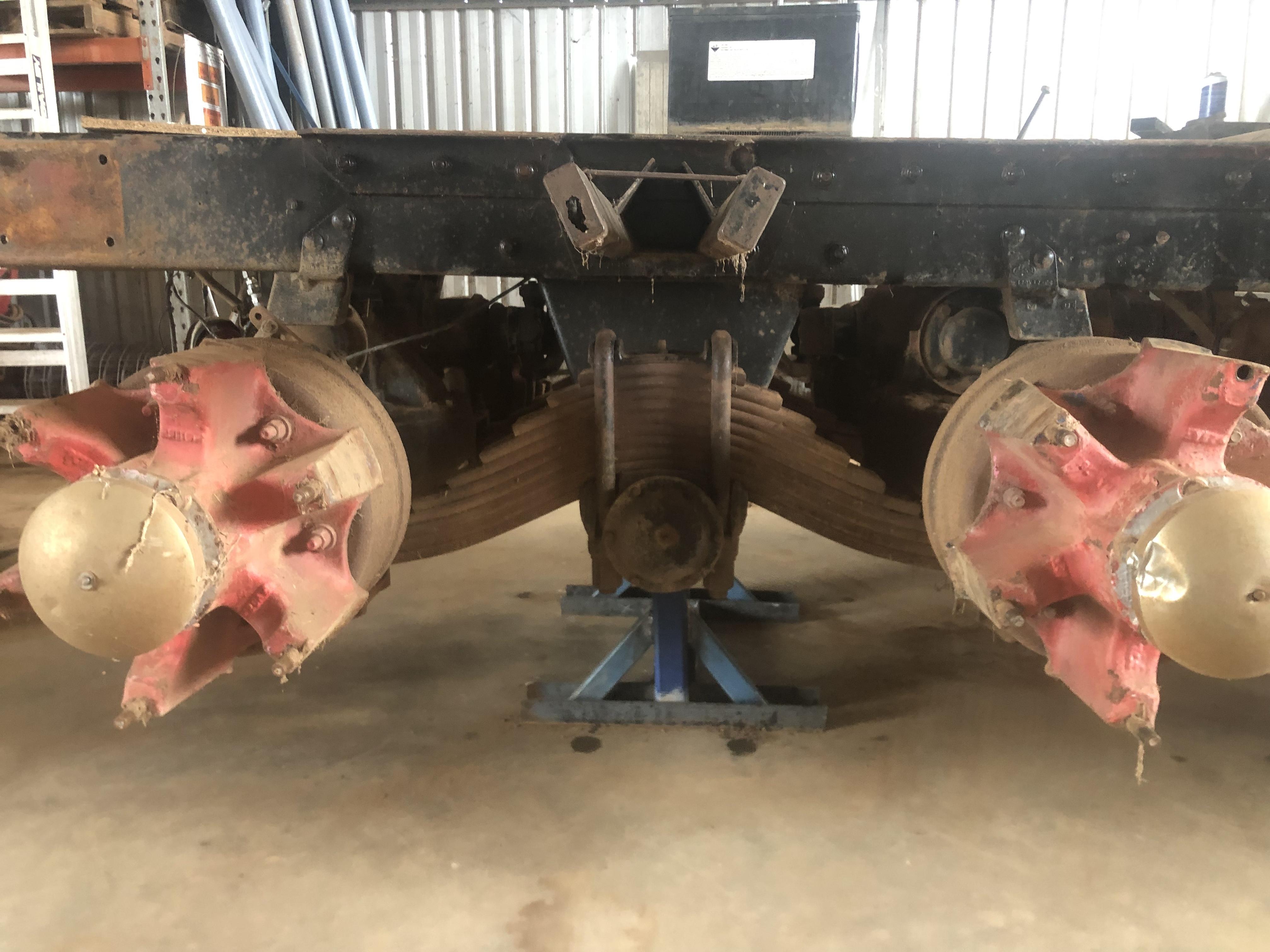

I’ve since removed the chrome caps. But yes it look exactly like that. My parts guy believes it’s had a rear end swap from 34k-44k
10 leaf pack
the diffs have 8.24 ratio stamped on the front of the carrier housing

8.24 ratio isn't going to run too fast if it has one of the two transmissions I mentioned. They are both direct 1 to 1 in high. would make for about a 35 MPH top speed. The drop in from a set of 34,000 or 38,000 will fit right in if you want to change axle ratios. You just have to check that your axle splines are the same some were different. You have the steel case drop in carriers. The torque rod mounts in with a tapered stud. You can use the aluminum cases also but the torque rod bolts on with two bolts, You will have to modify or change them.
This picture is an aluminum case. You can see the torque rod mounting is different from yours

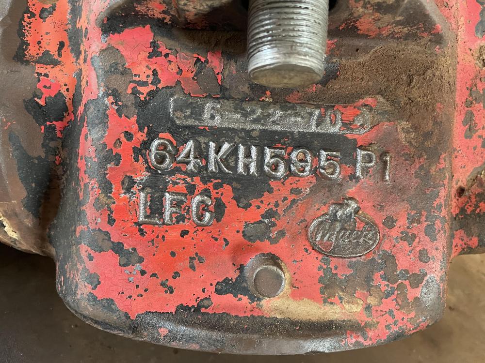

I suspect the gear sets have been changed. Front diff carrier housing is stamped 8.24. Rear is 5.14 or so, however it sits on 100kmh happily in top cog around 1700 odd rpm

That might even be a set of 3.87 ratios. Is it on 11r24,5 tires?

Tape a piece of string on the tail shaft, drive one wheel revolution forward, hop out and count how many times the string has wrapped around the tail shaft
Thats your diff ratio
5.14 will allow 100 kmh with a OD transmission
Paul
https://www.bigmacktrucks.com/topic/74849-1979-r685rst/#findComment-563805
On other makes with single reduction rears, the tooth count is most often stamped in the head of the pinion (rear-rear on a set of bogies) eliminates guess work, like "was that 3.7 times or 3.9 time around the shaft?" Because the gear set is "mated" at the time of mfg, it will be correct. For Eaton 2spds it will be the "high ratio".
Don't know how Mack does it with their double reduction. esp if someone changes the gear-set and doesn't re-stamp the ratio on the housing.
