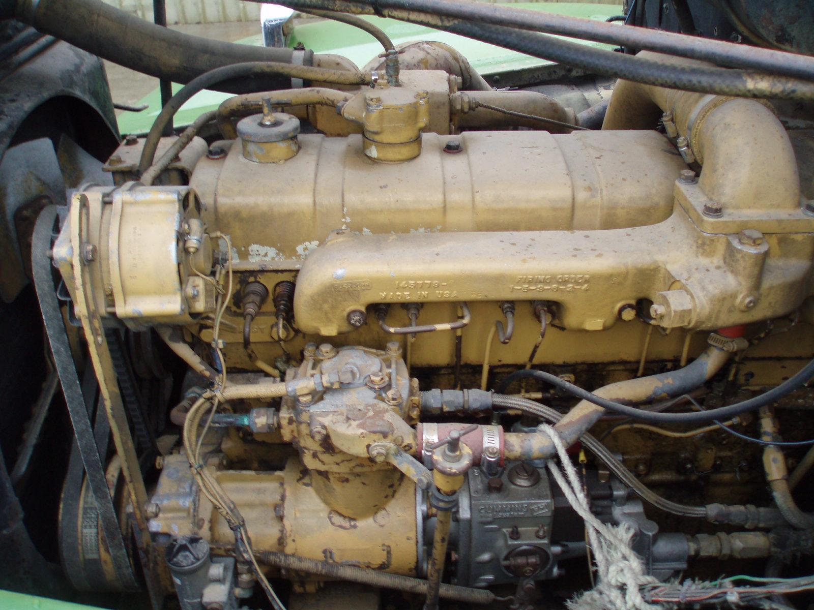

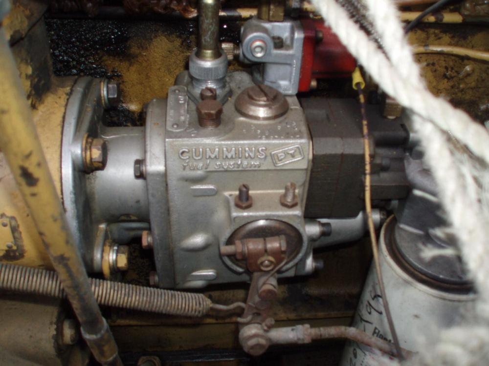

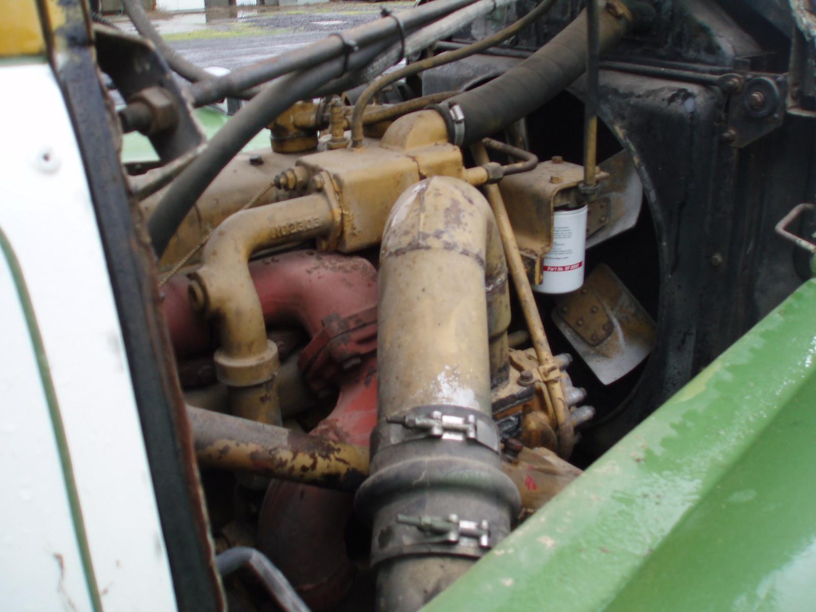

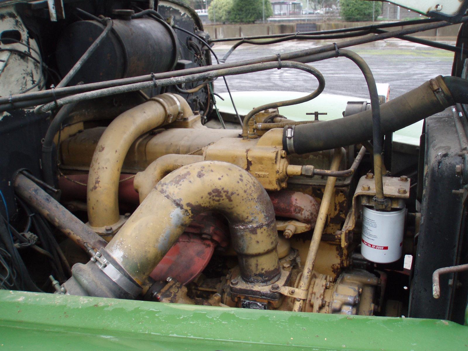

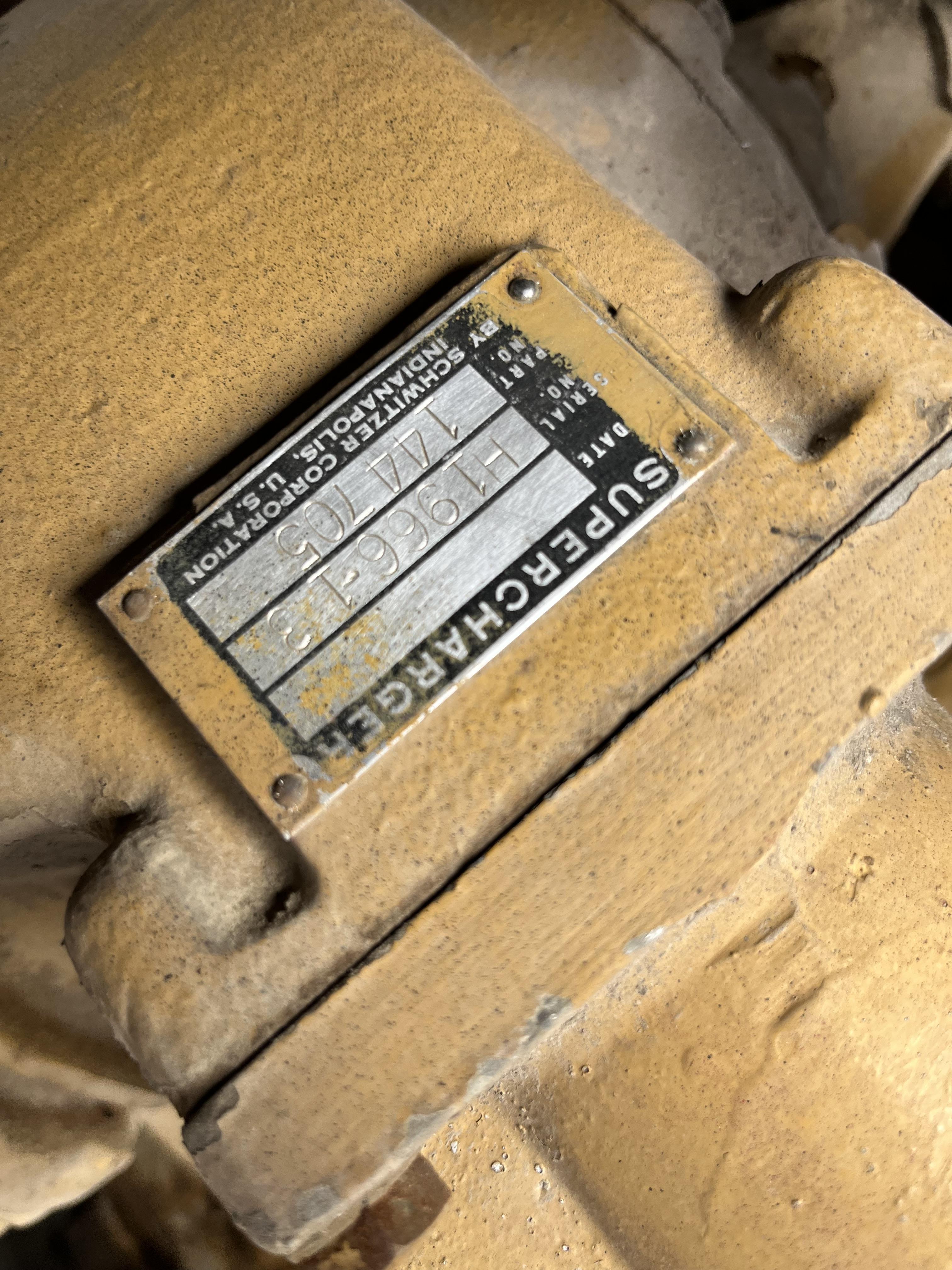

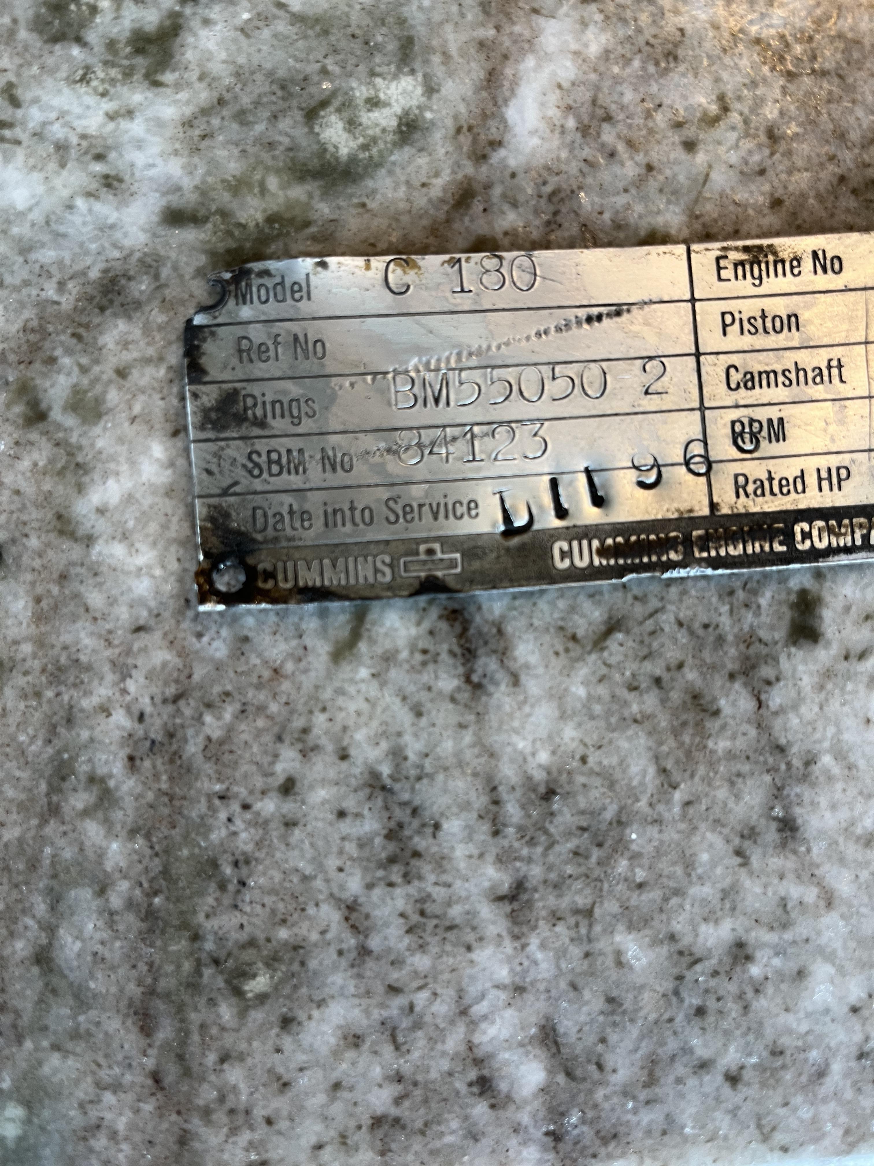

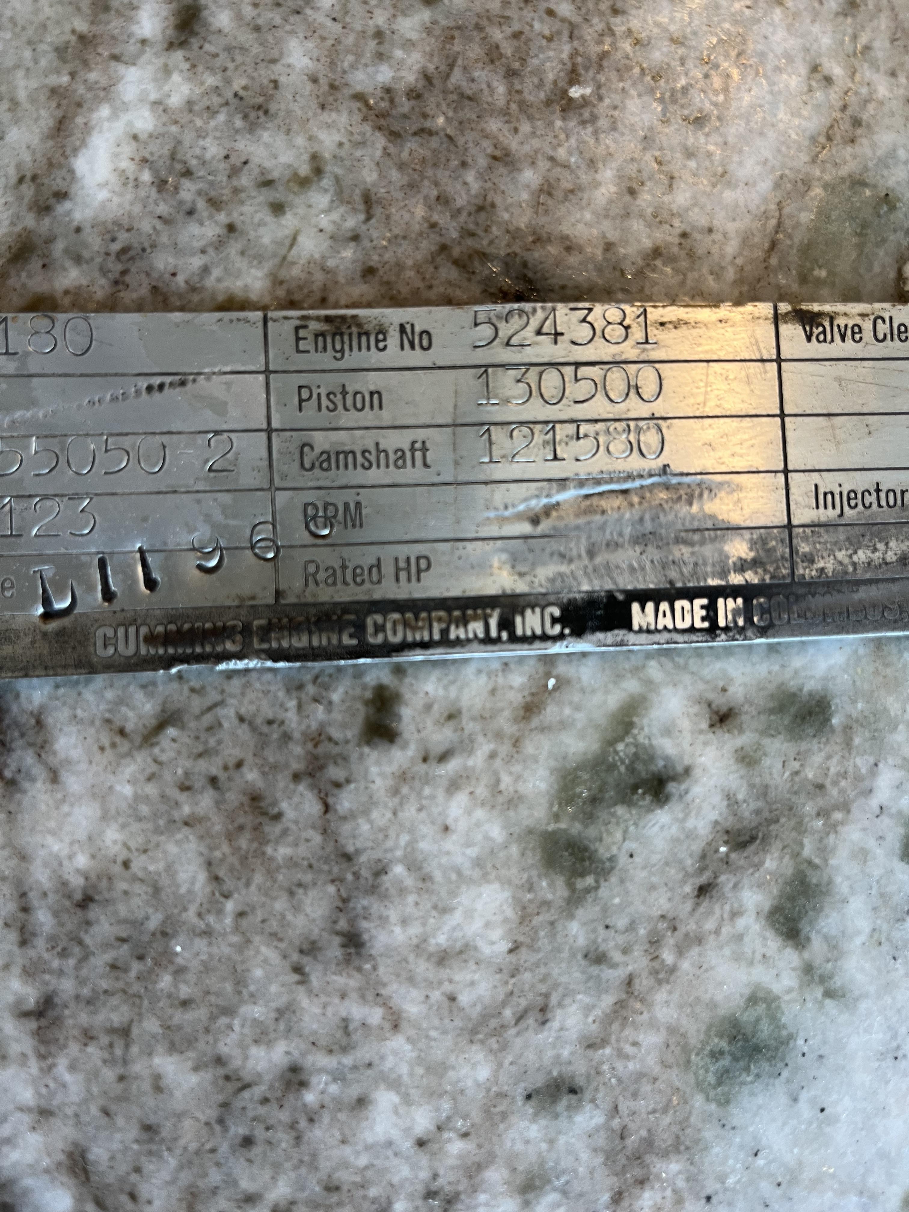

C180. that's 180 horse.   I think they were like 672 cubic inches. Popular in stuff where the 743 wouldn't quite fit.  The supercharger didn't add a lot of horsepower as the C160  didn't have a supercharger. But ????  back in the late '50s early '60s..... they did the deed.

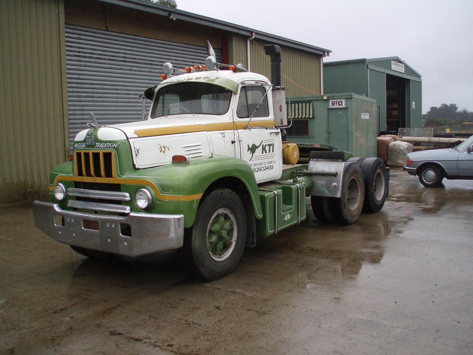

Same Cummins in Inter R200 with 10 spd R/Ranger O/Drive - 1965 model we owned some years ago. It was a US import to Australia.
Have you seen this website?  Scroll around a little it is very complete on international trucks!

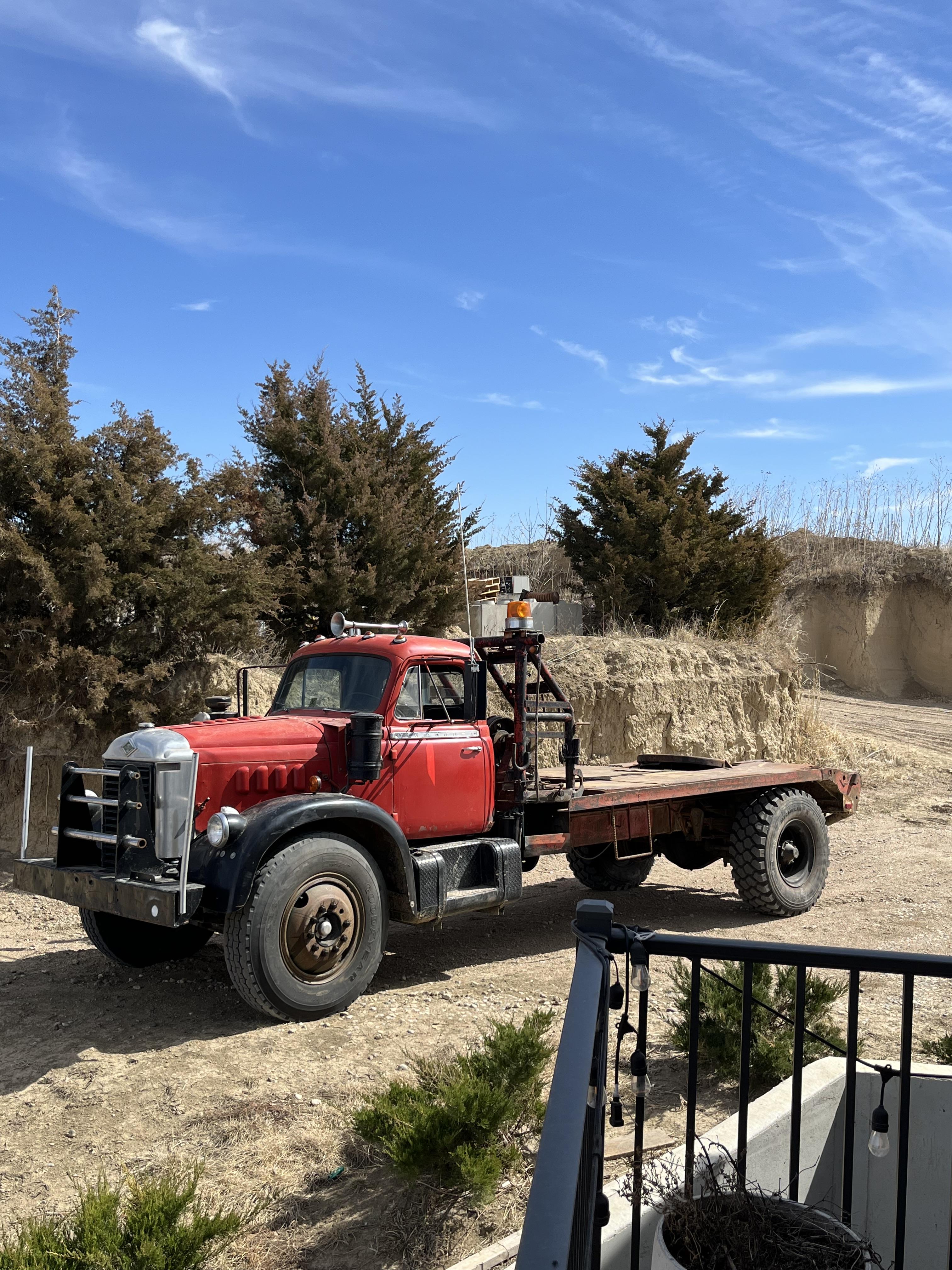

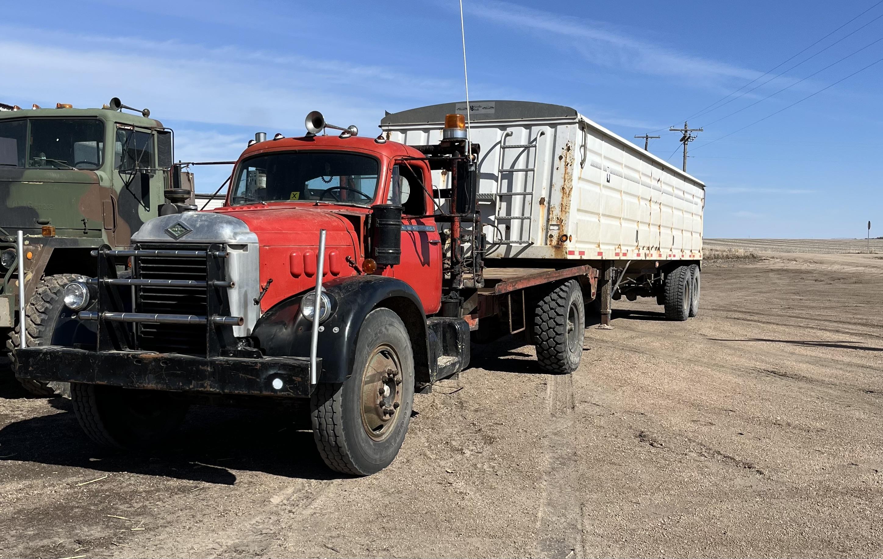

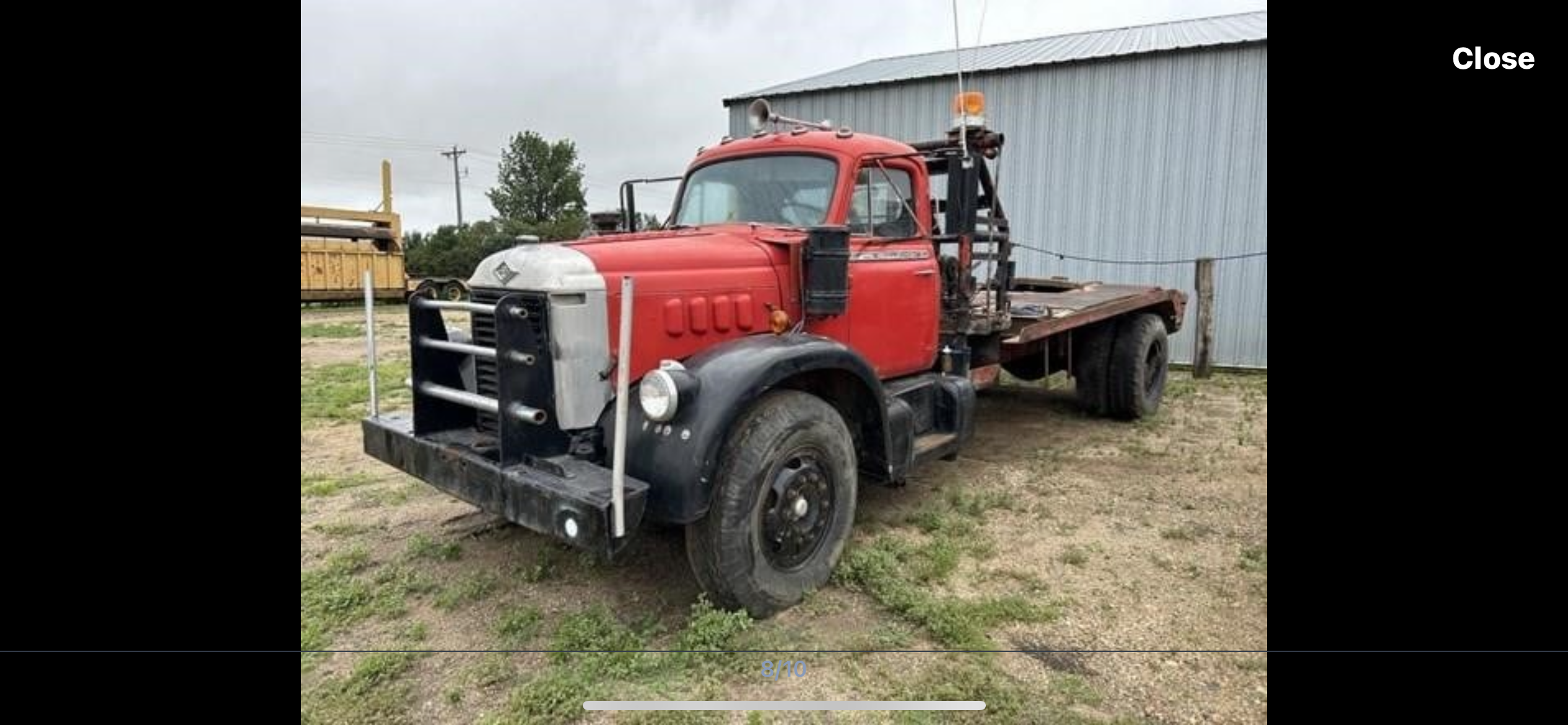

Cool, I like that truck. Love the oilfield body, specs too.

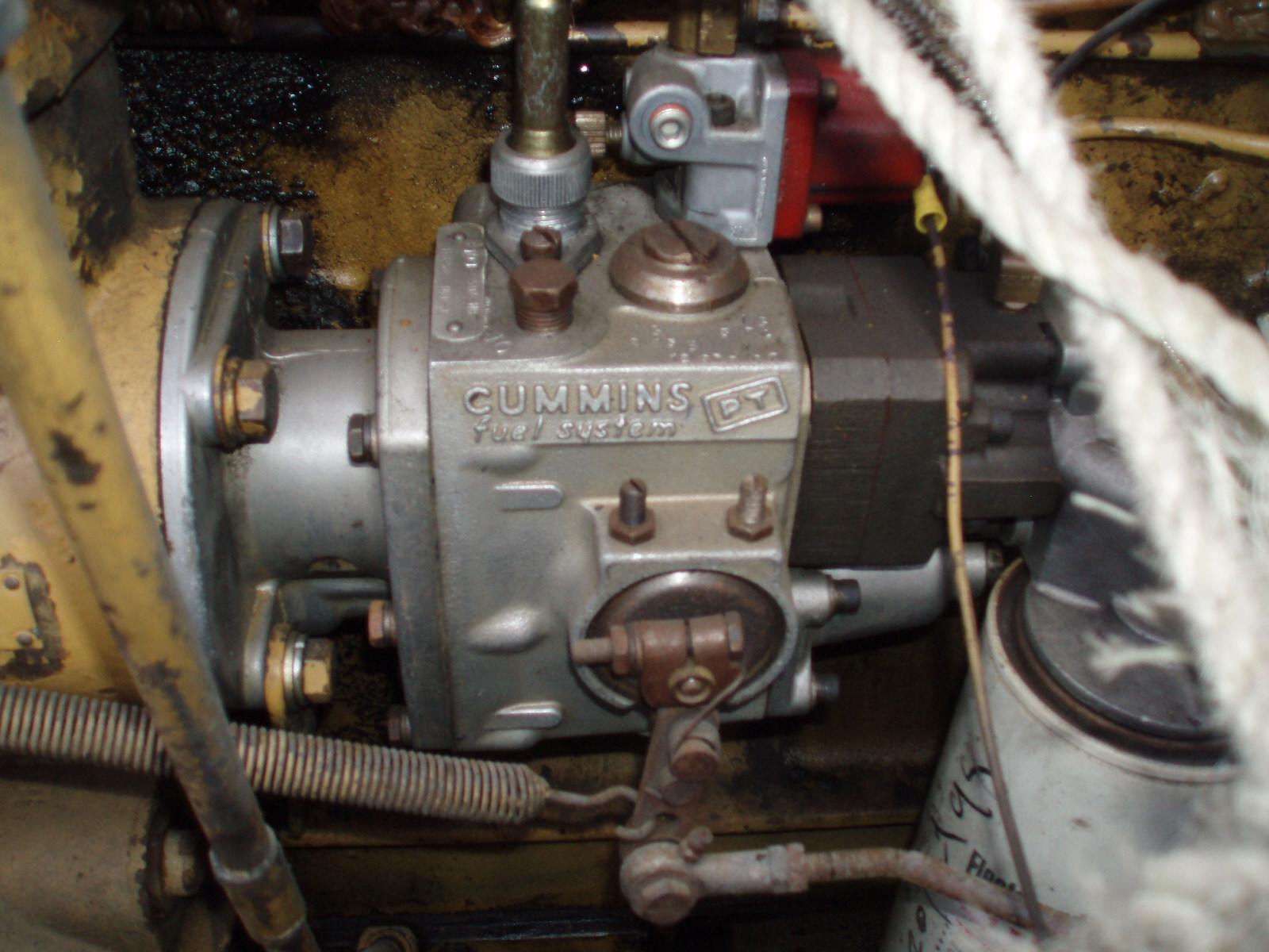

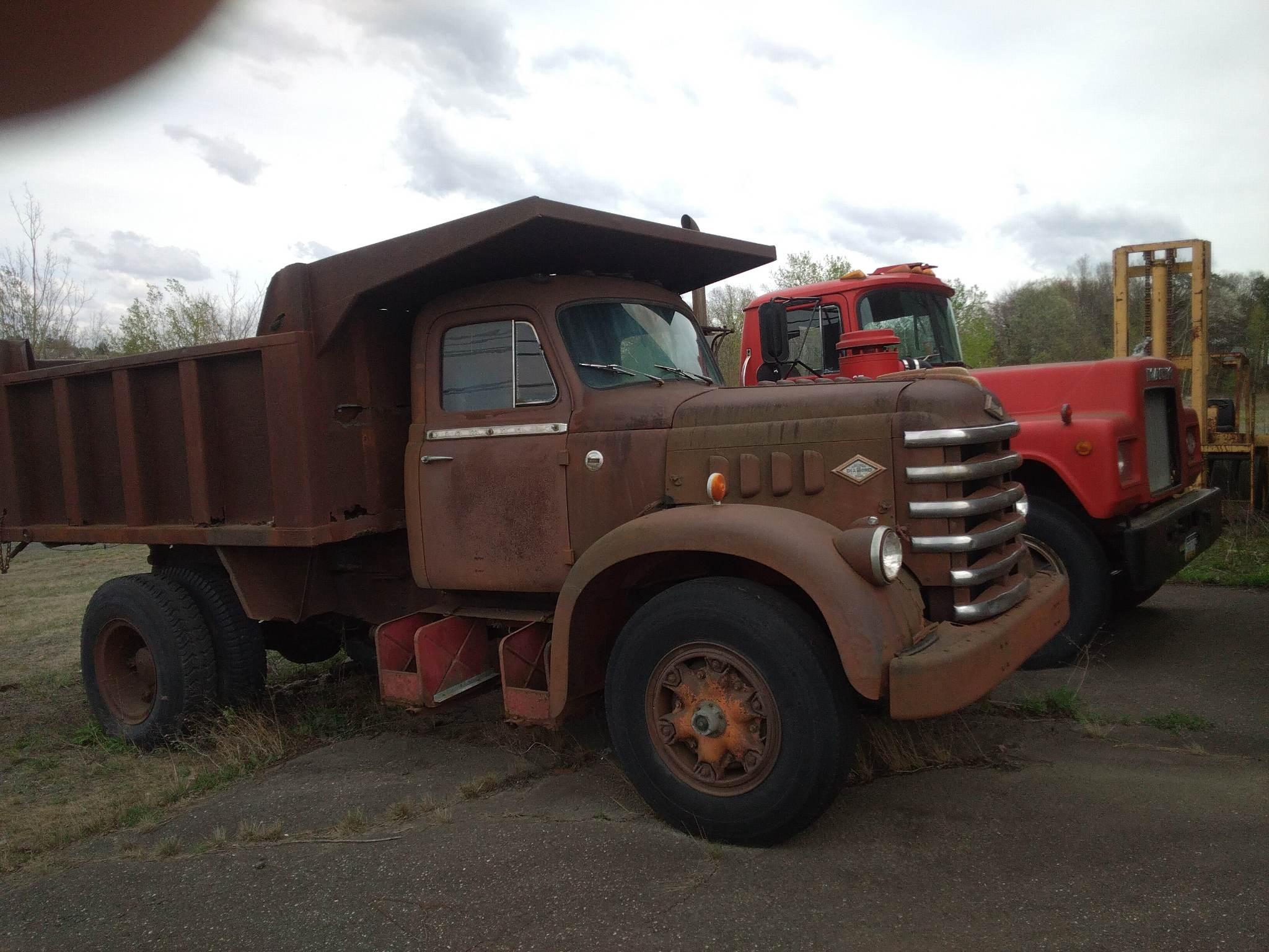

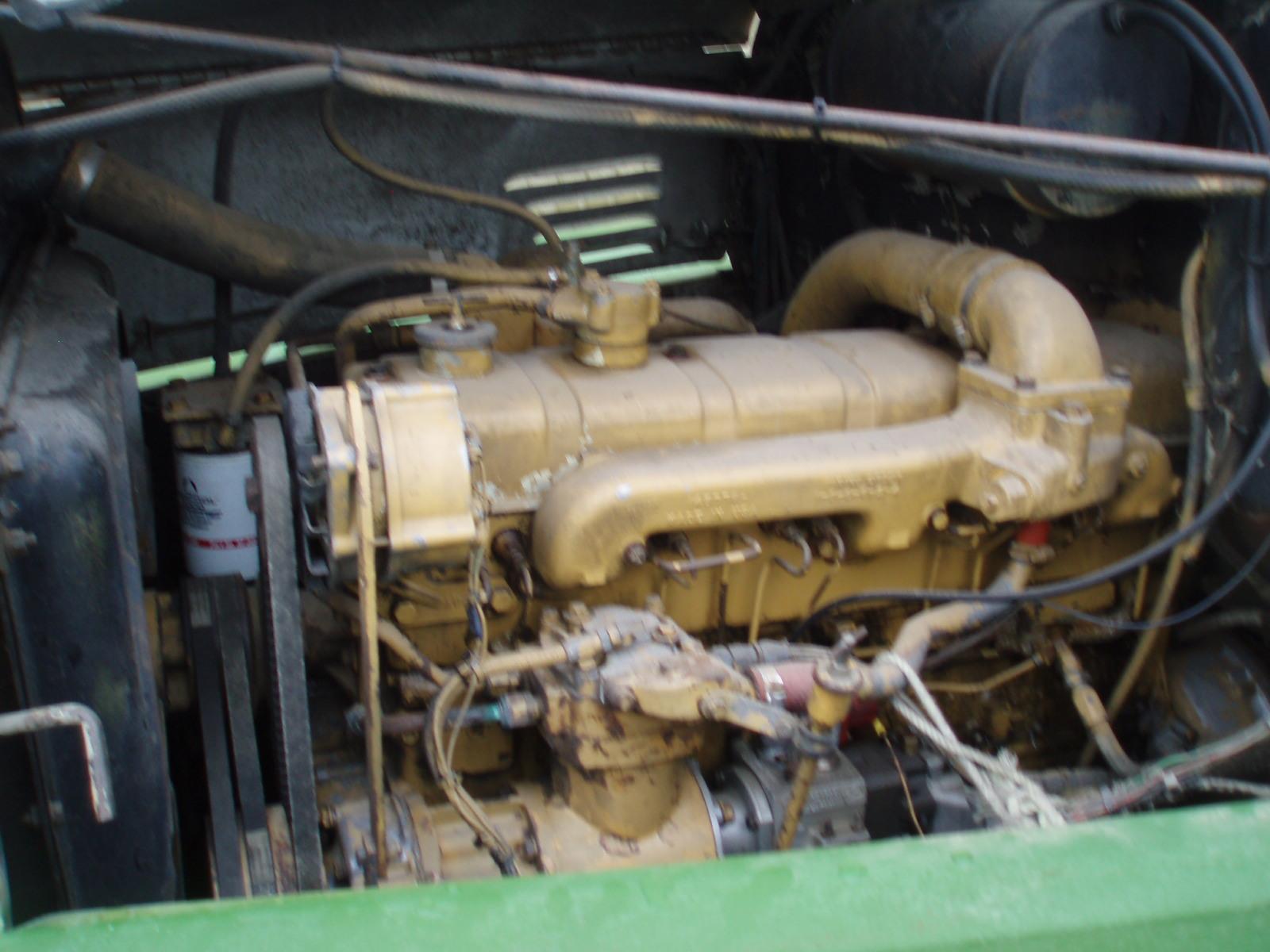

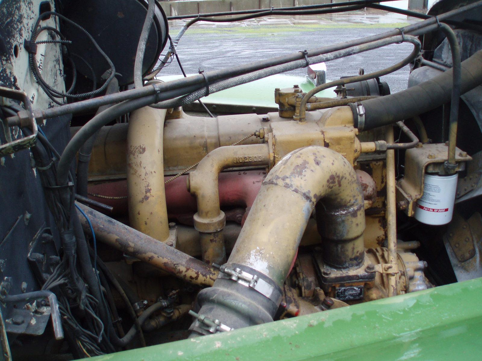

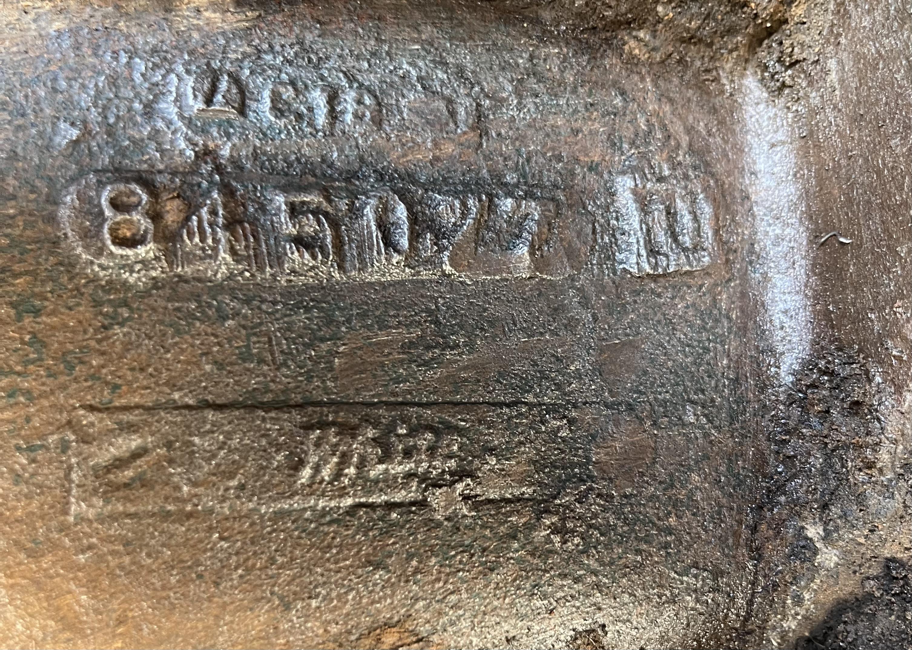

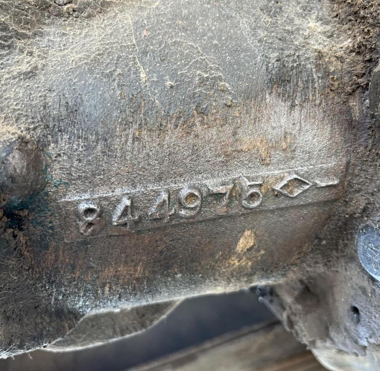

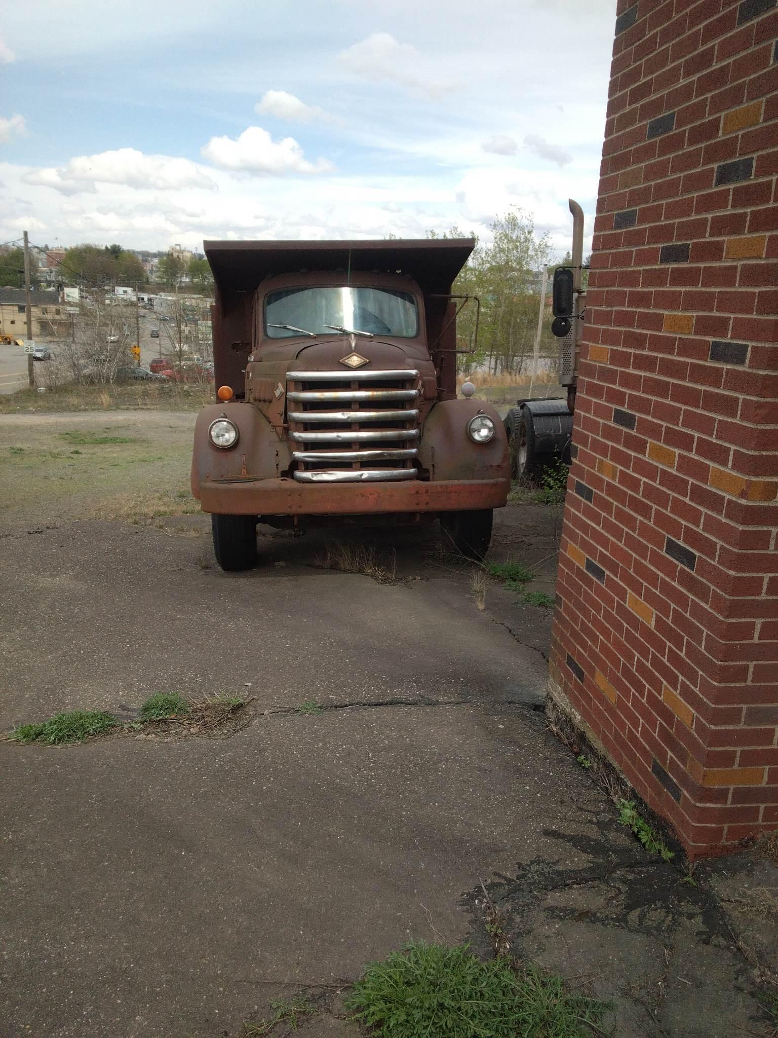

I've got one I think it's a 530. Red Diamond powered

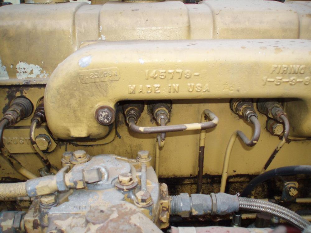

RD's top out at 501 CID.

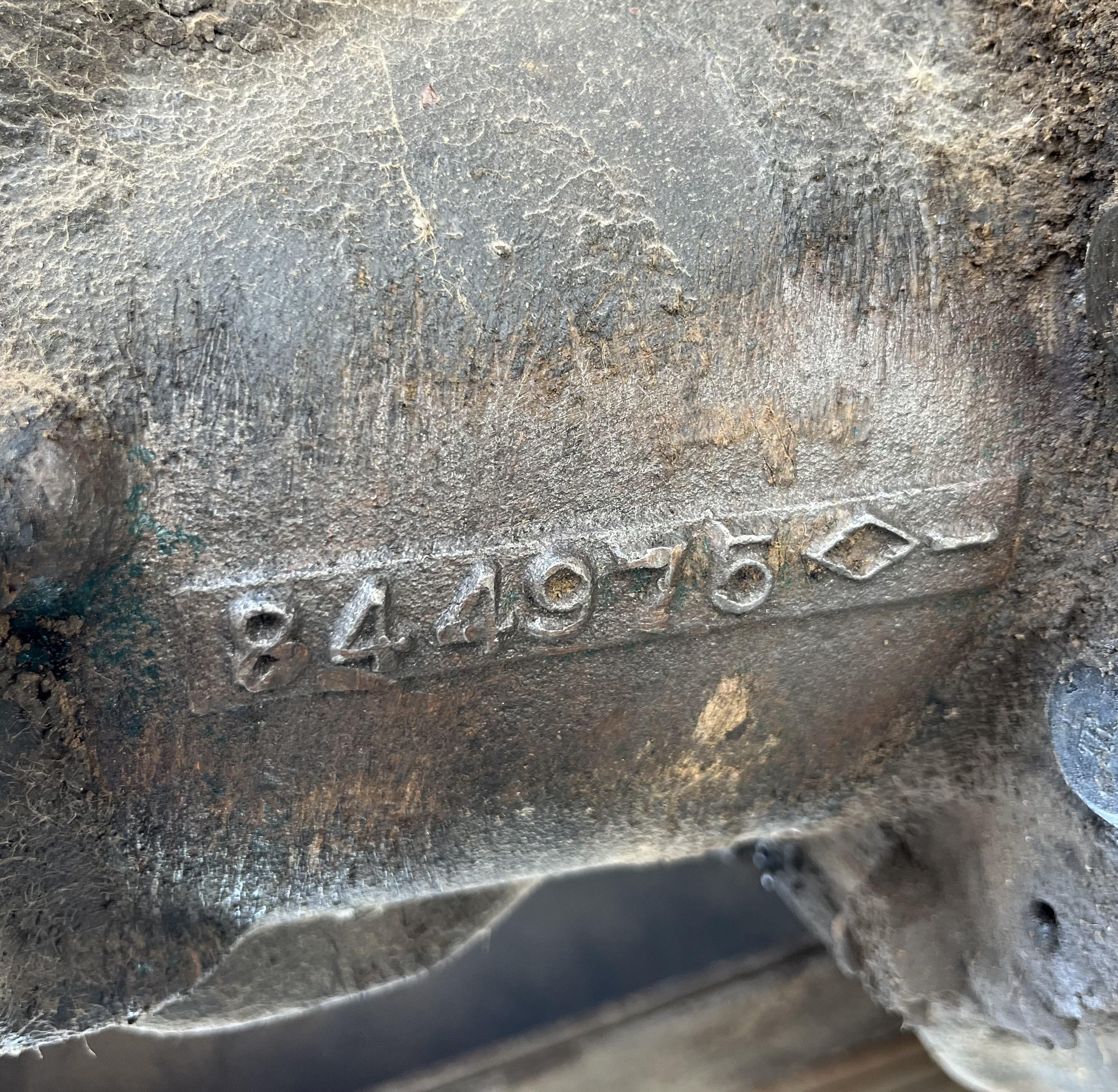

Engine number will be stamped into the block (not head) between #1 and #2 cyl, behind the air compressor. Should start with "RD" followed by the displacement and then the serial number of the block.
https://www.bigmacktrucks.com/topic/74855-1956-diamond-t-730/#findComment-563857
I think one of the old timers told me it's a 450 RD before I dug it out of the weeds. I had a 501 and it had a 4 BBL carb on it. To tell you the truth I haven't even checked to see if it's stuck. Everybody told me it ran. It belonged to a shop right across the street from me. They were losing the property over long term health care bills, and they gave it to me for helping them load out all the stuff they wanted with my backhoe and moving their storage trailers
https://www.bigmacktrucks.com/topic/74855-1956-diamond-t-730/#findComment-563873
35 minutes ago, Geoff Weeks said:
RD 450 and smaller are lined (dry liners) the 501 is not lined.
If it is stuck, dry liners might make the repair easier.
Hopefully it isn't bad stuck, or stuck at all. I rebuilt one like 25 years ago and parts were hard to find and kinda pricey. I think if I was going to tear it down I'd only go as far as rings, bearings, and grind the valves. Hell that was all we did to them when they were in working trucks and they held up until the cabs rotted off the trucks from the damn salt

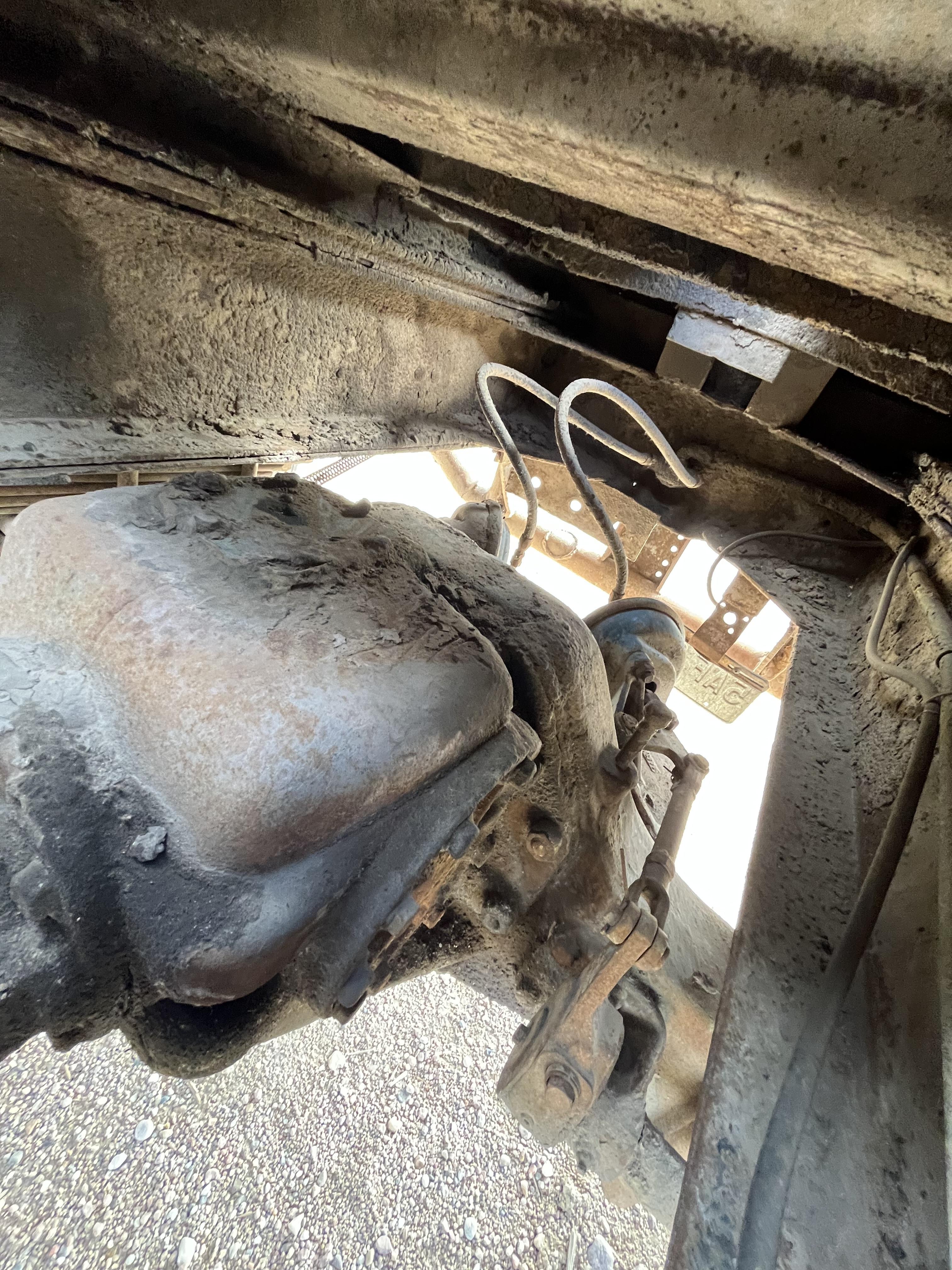

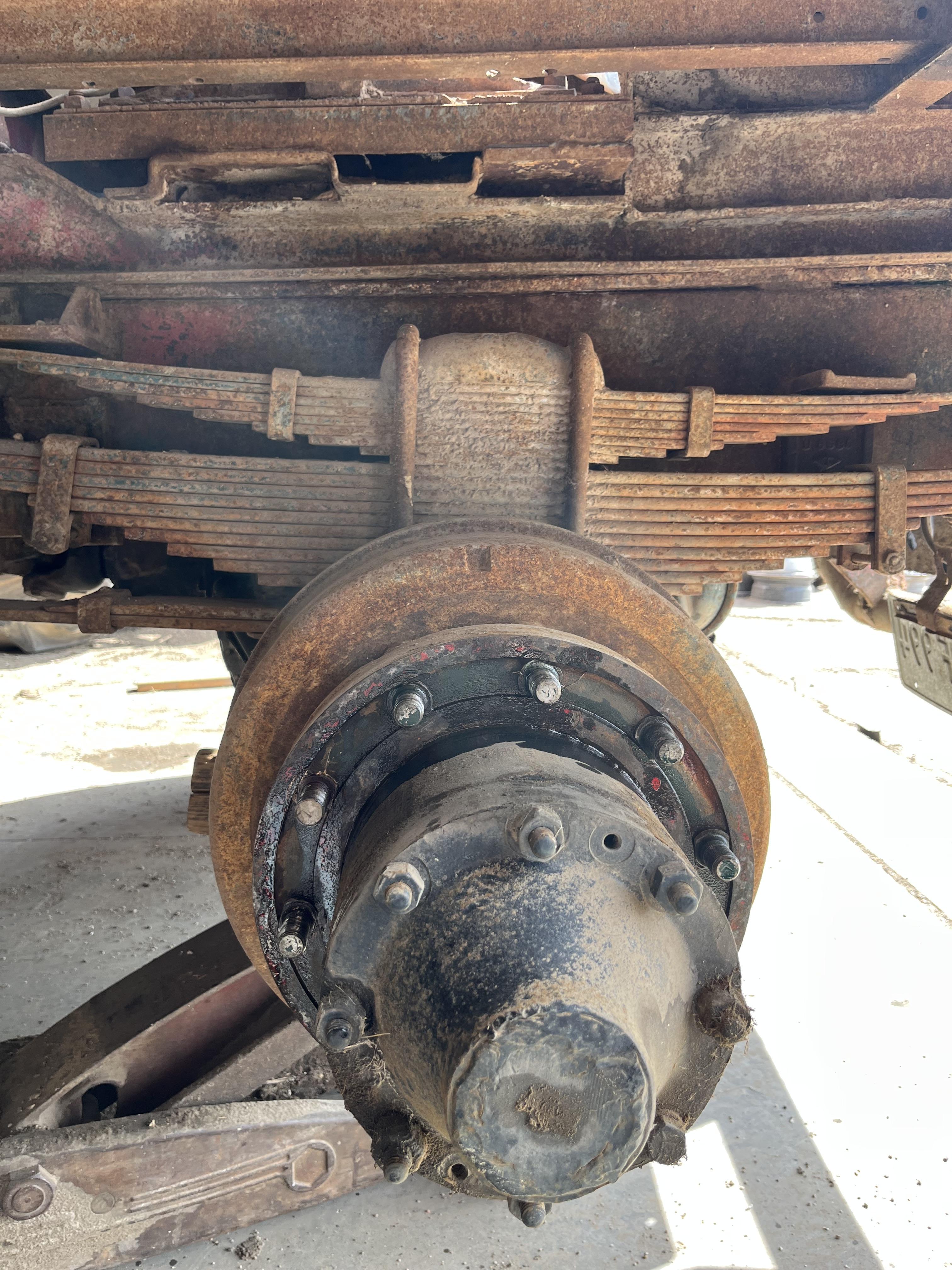

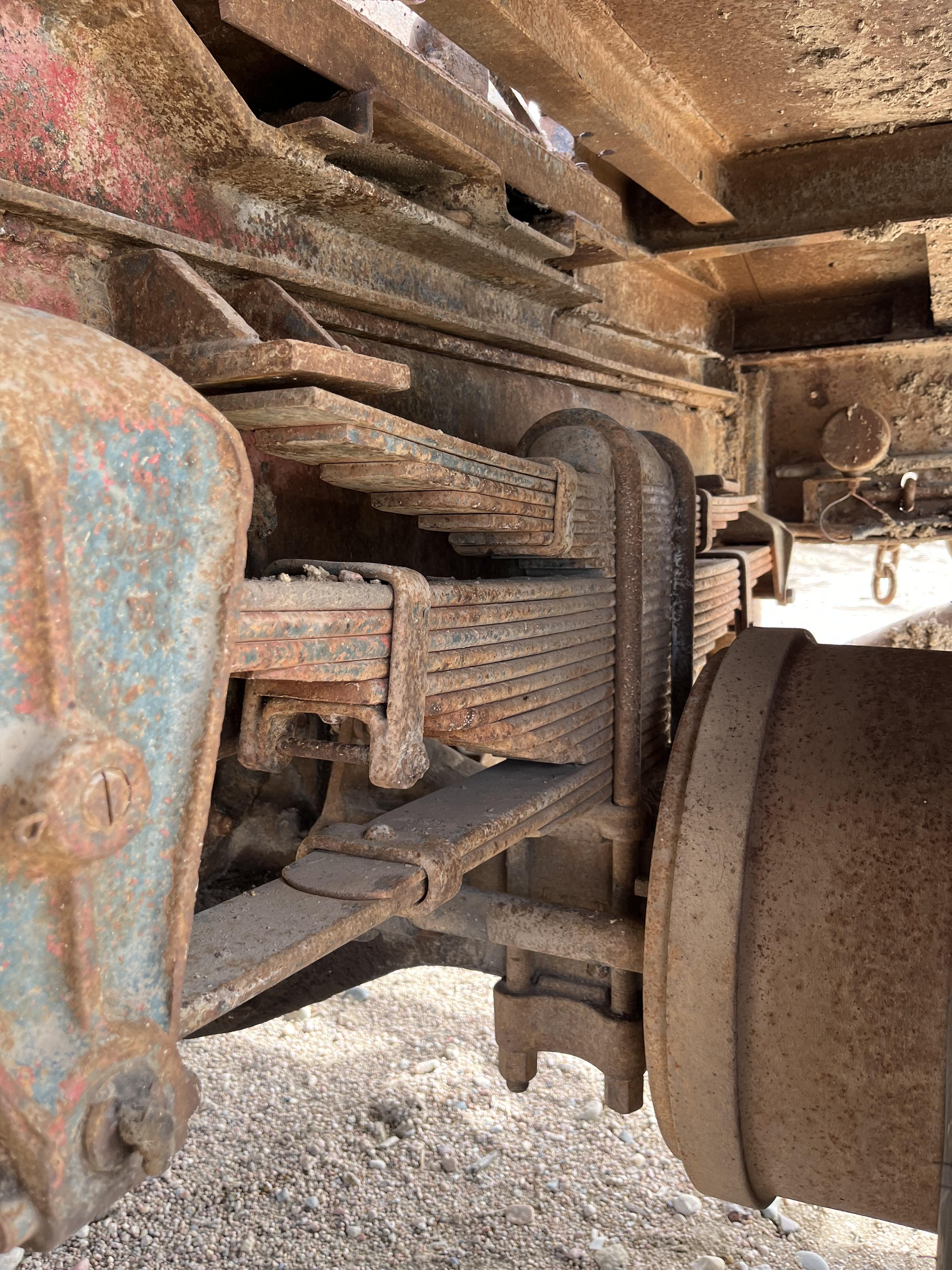

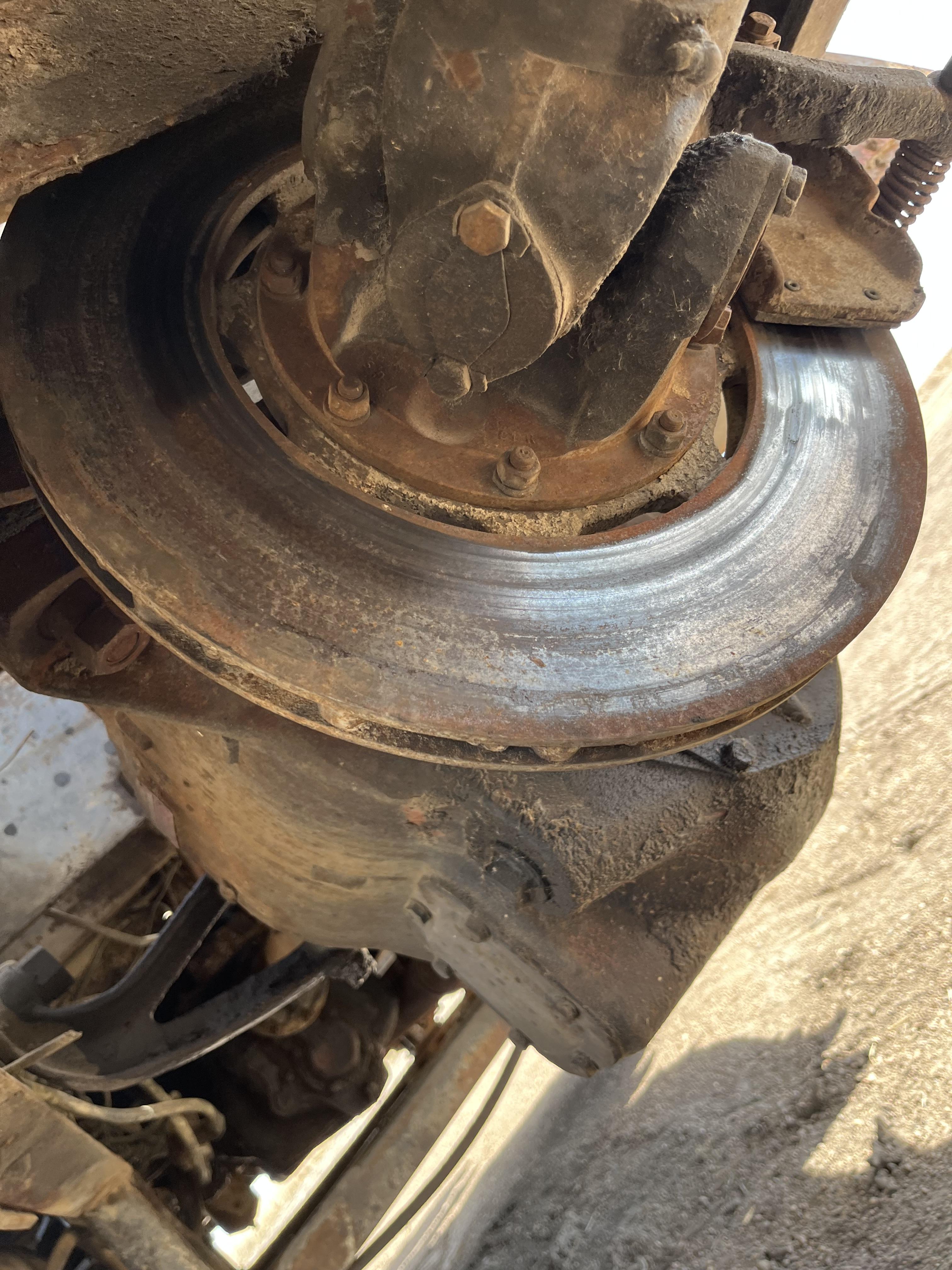

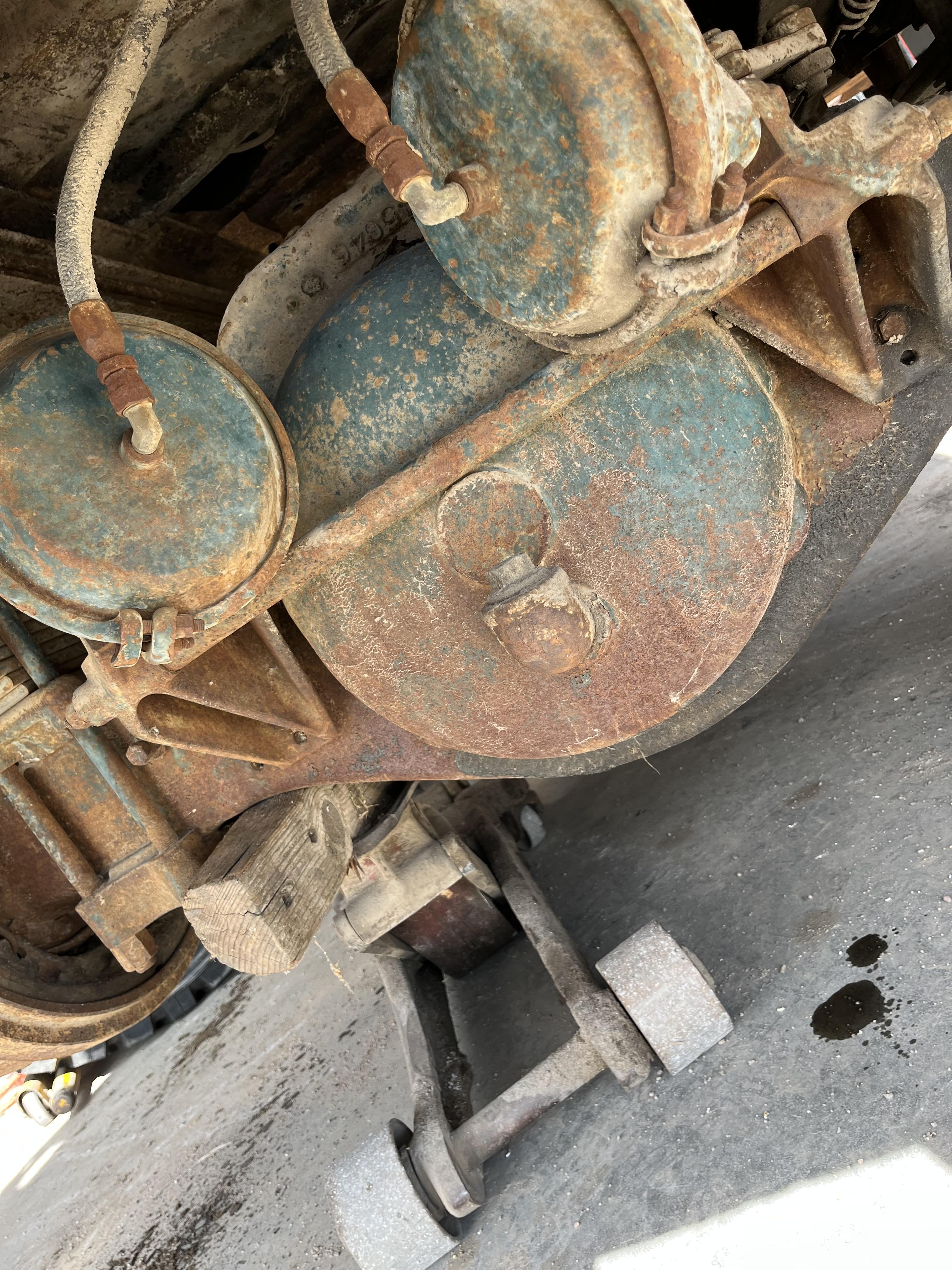

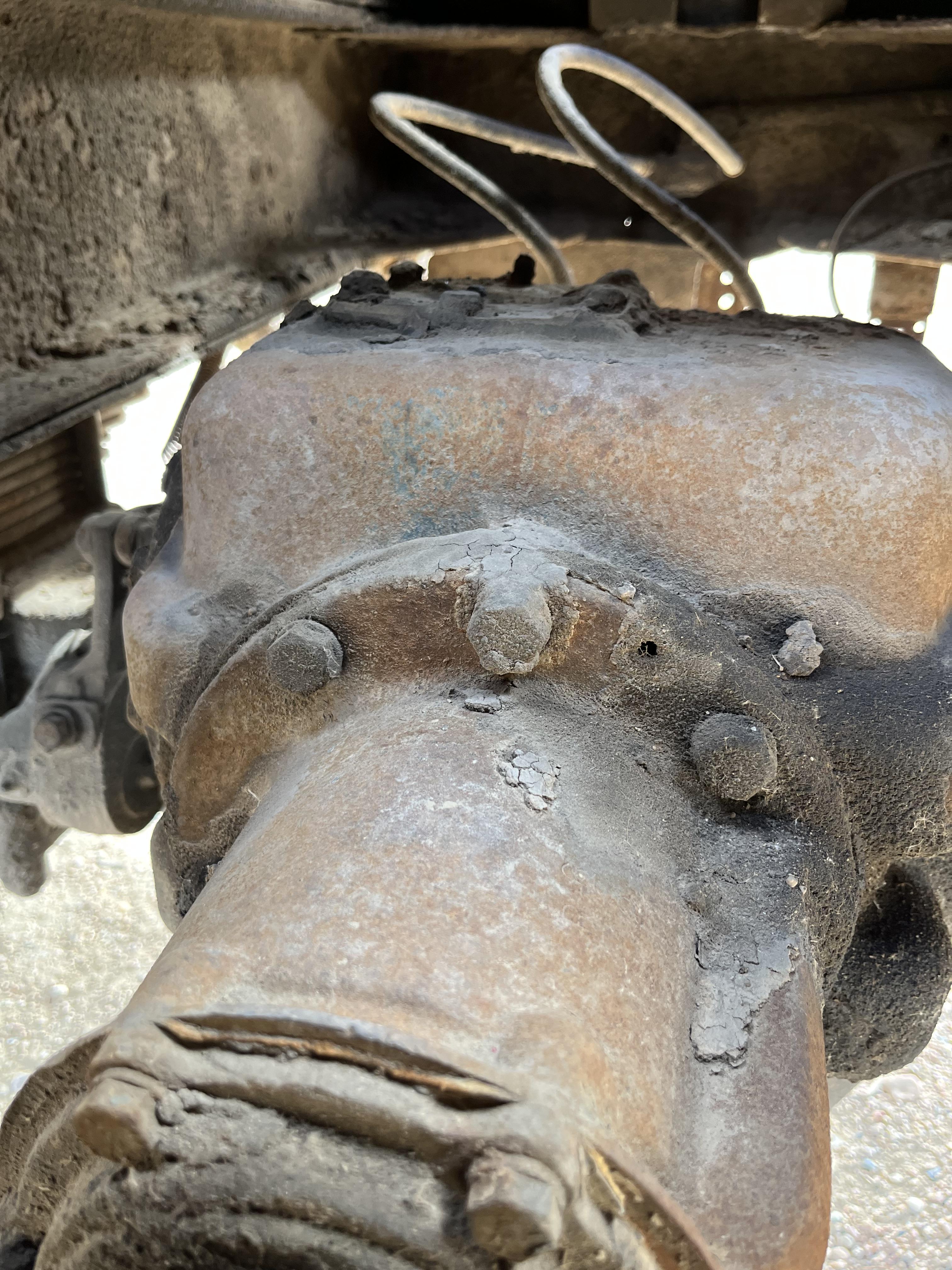

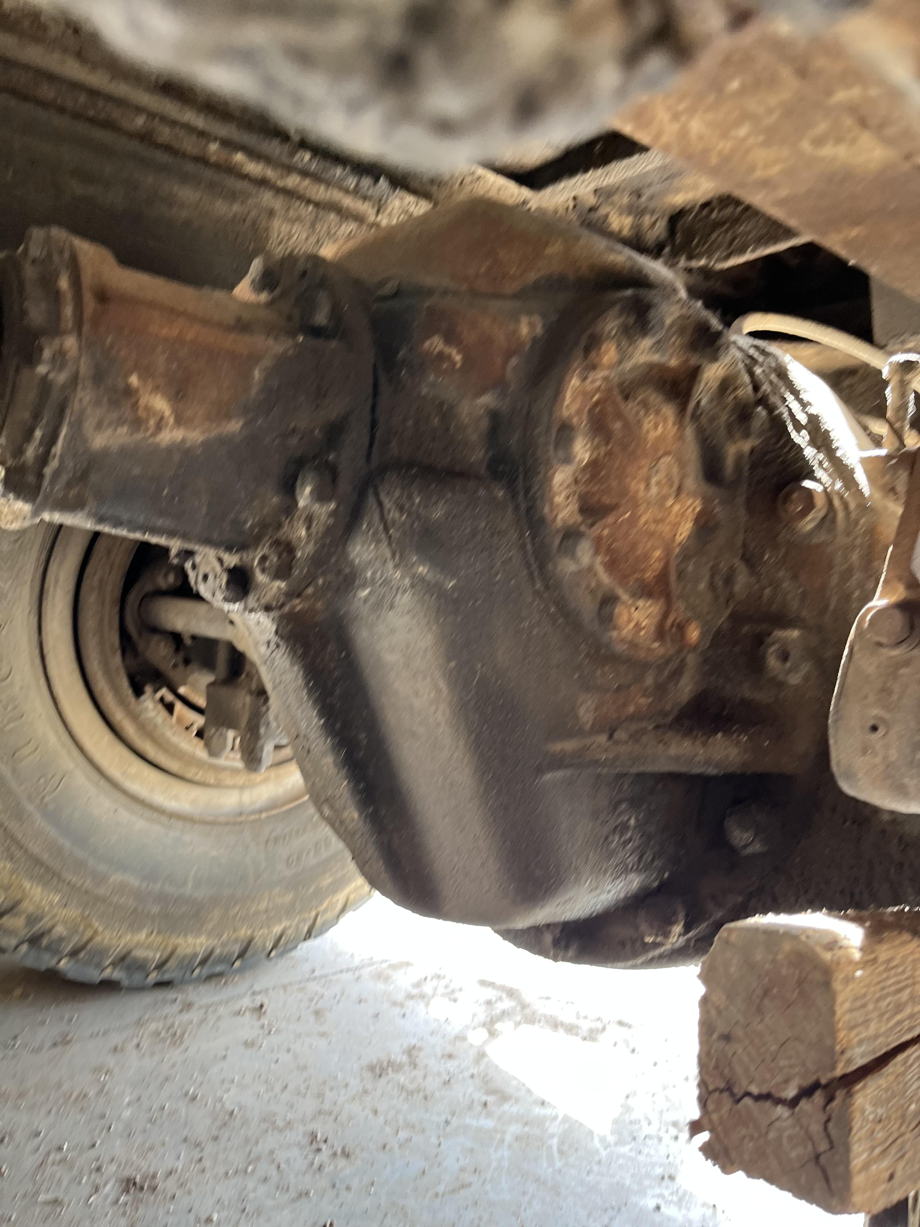

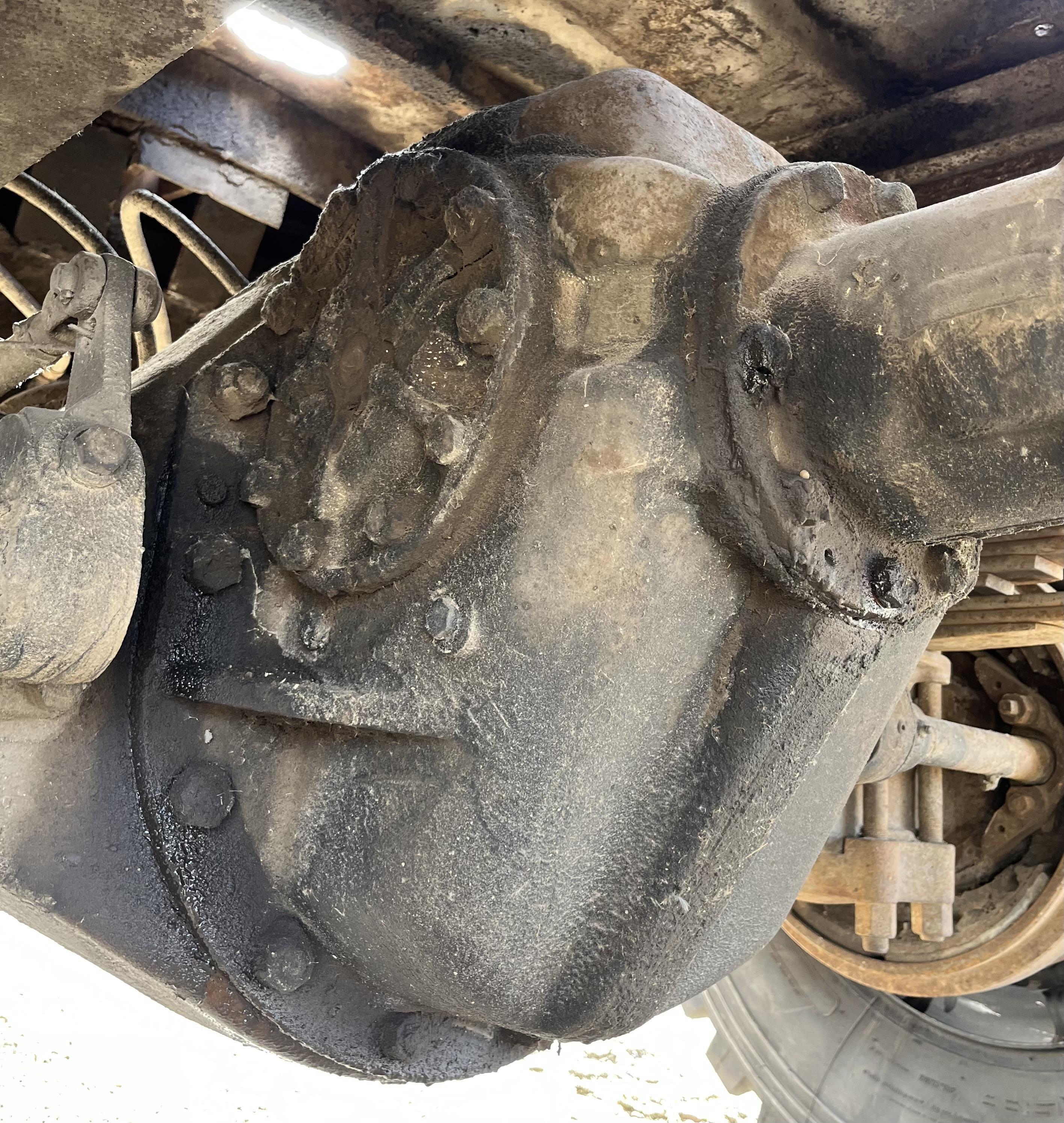

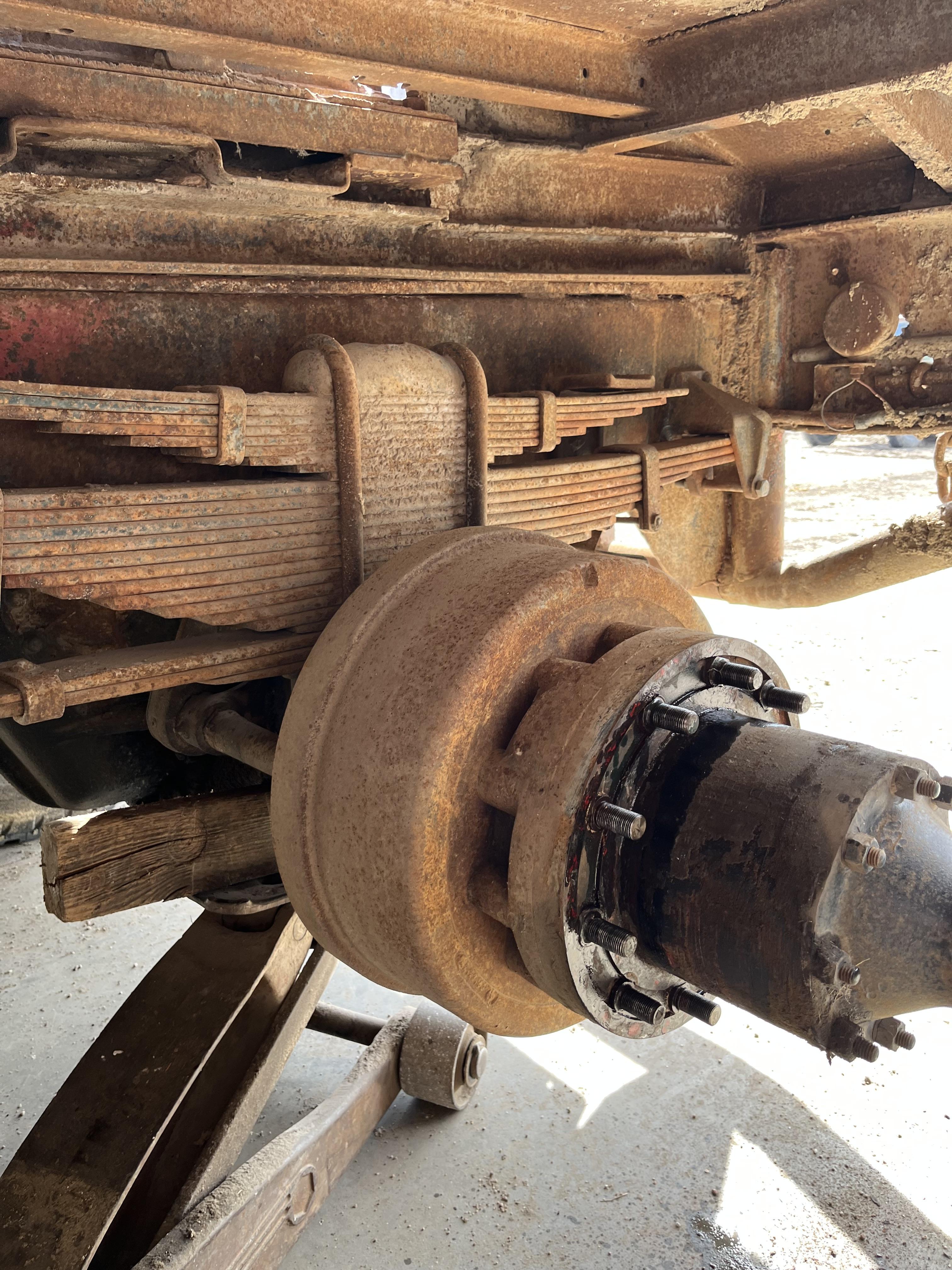

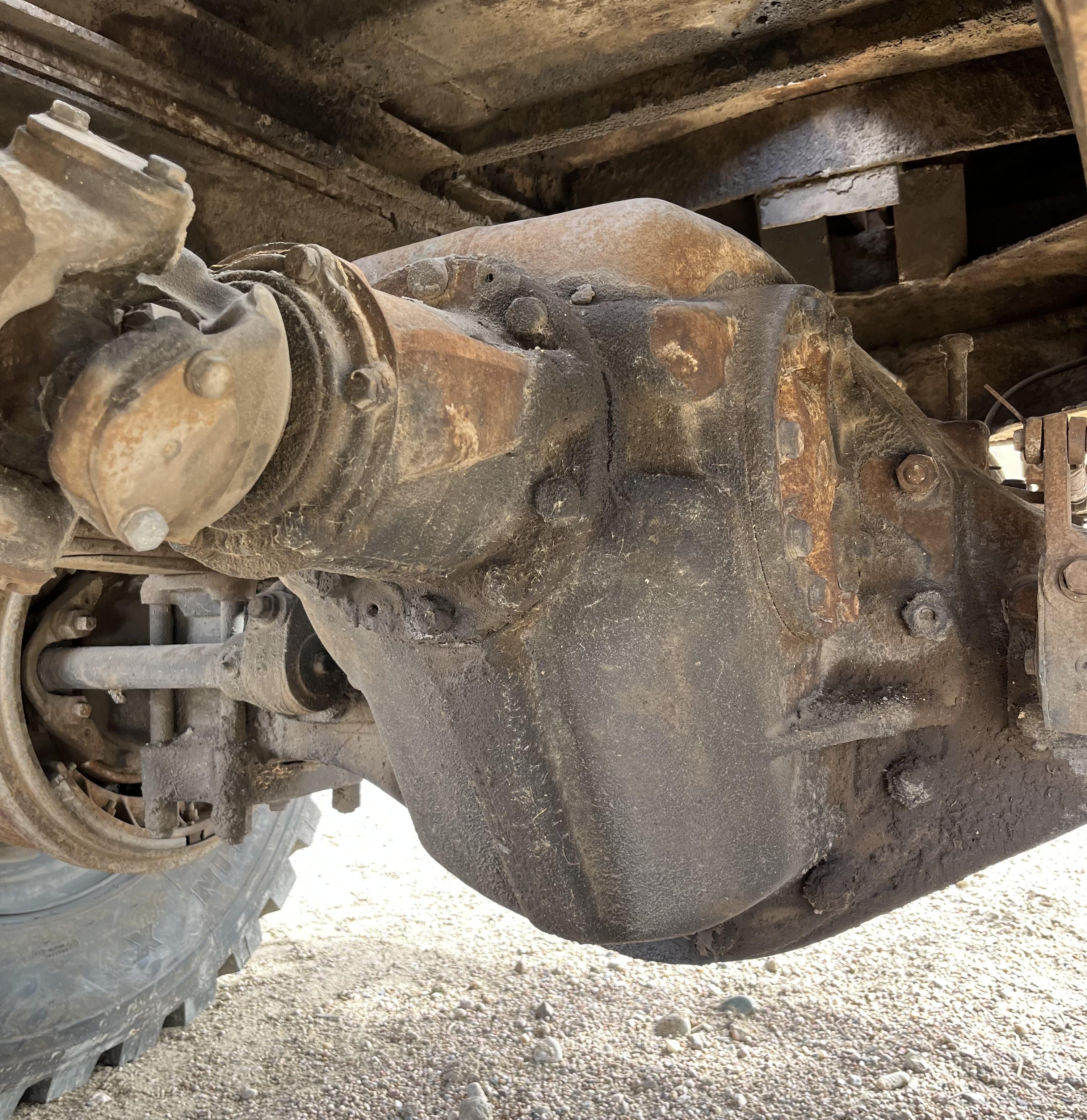

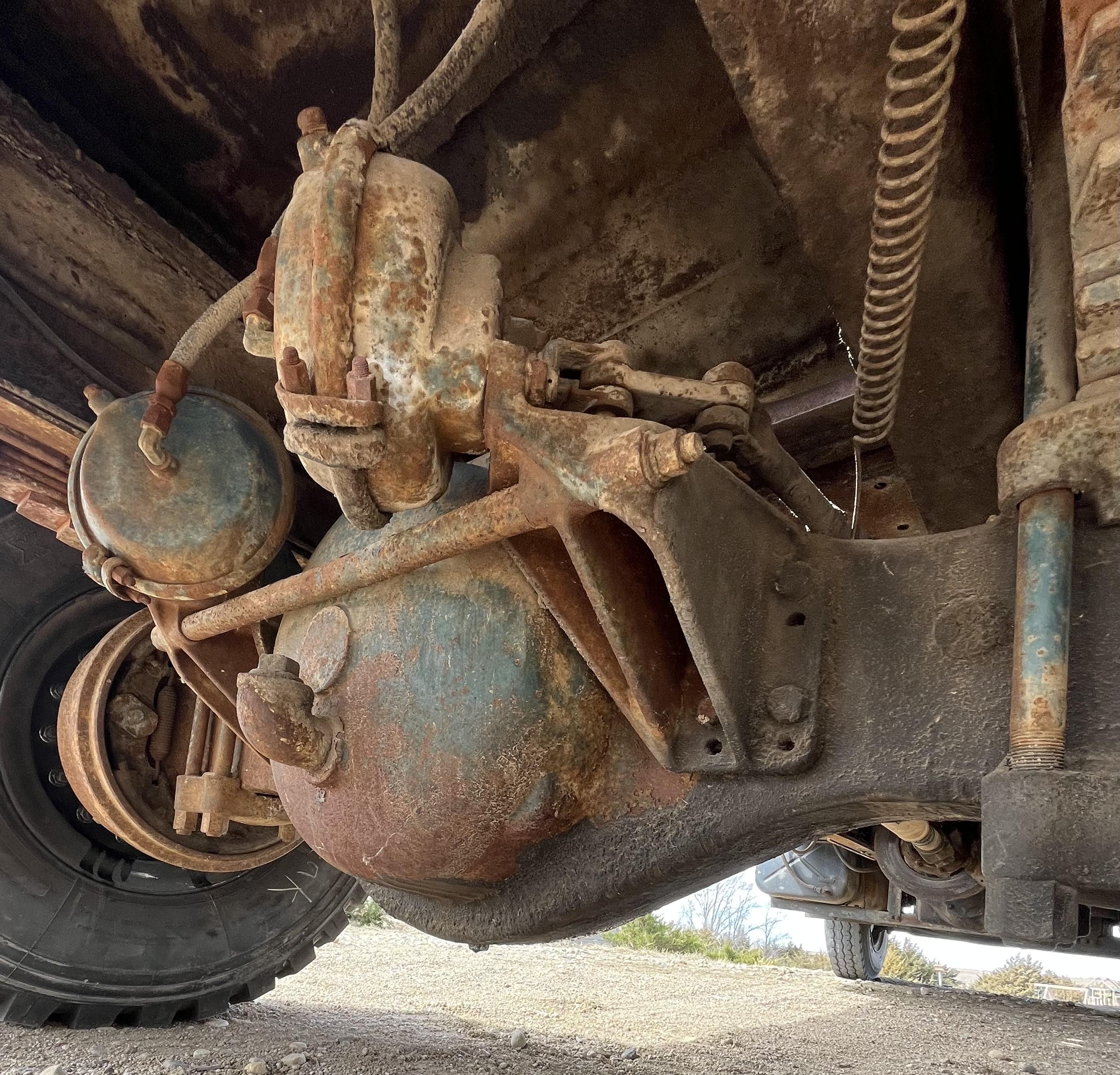

Looks like a Timken "L" series axle. Not exactly sure which one. Double reduction axle. L240 or L245 look like what you have.
I don't have a capacity, but likely far more than is allowed on the roads for a single axle, 25K?
I would say it is original to the truck, right timeframe, right air brake set-up
The U series Timken also looks close, but I don't think it is an exact match.
Looked at my K series IHC book, and they used a U200 that looks like it could be what you have. That would be the right timeframe.
Fairly sure on Timken, just not on what exact model.
