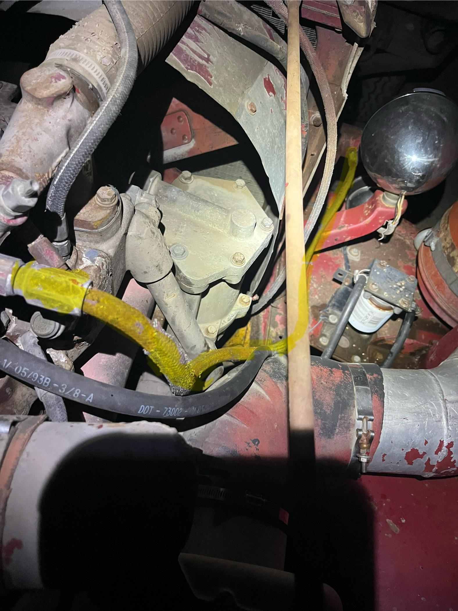

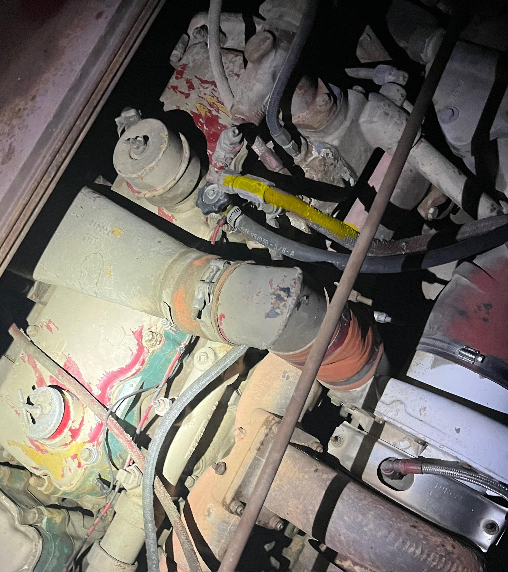

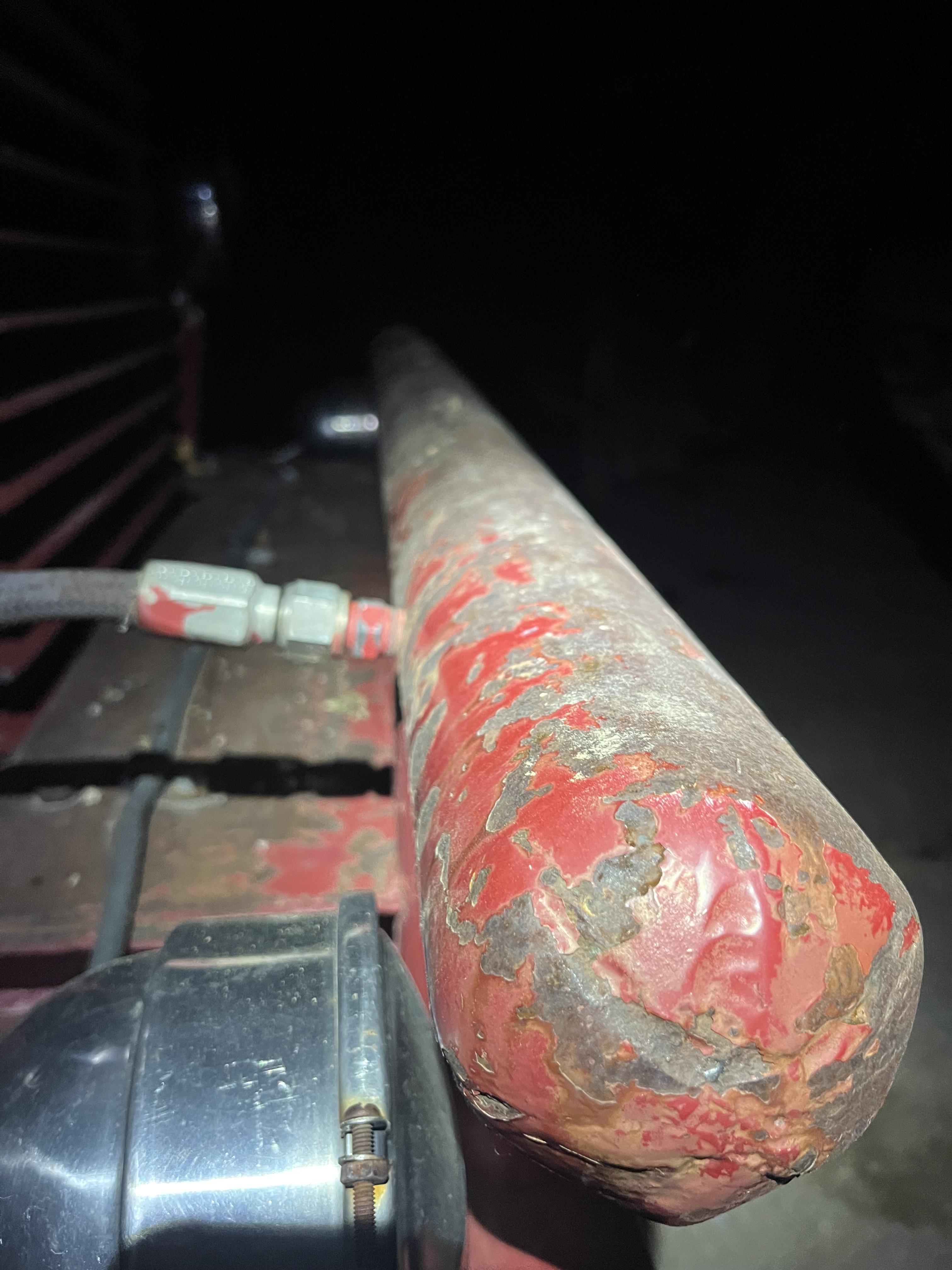

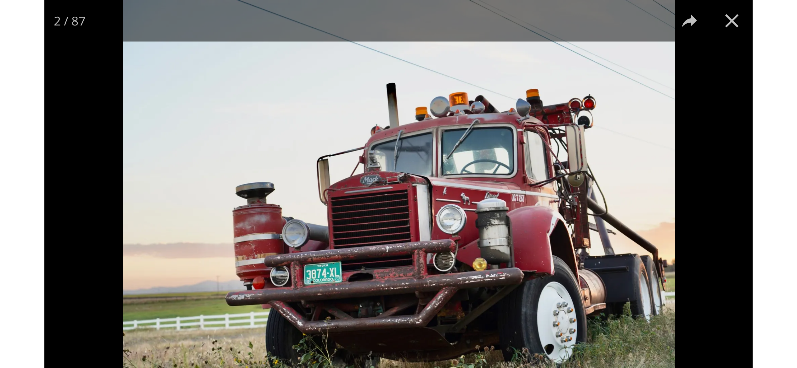

1 hour ago, reb87 said:
It is plumbed into the coolant, definitely to hot to leave you hand on after it is warmed up.  I’m thinking it is acting as an overflow
I'll have to take your word on that because I can't see the whole thing. Your picture only shows a line on the right side of the bumper, so I have no idea what they are trying to do, if there is only one connection and it is a coolant line. It wouldn't act as an overflow, as there is no way to draw it back in.

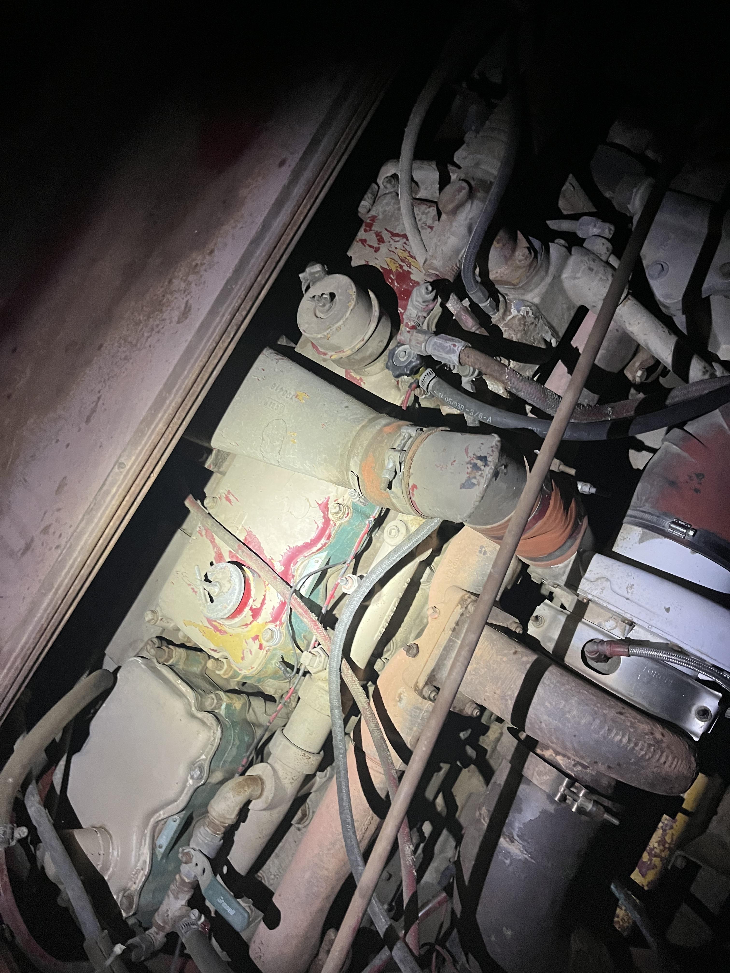

Can't tell what you are refering to on "the right side of the engine. Might be a old style oil cooler or even a coolant filter that was replaced with spin-on one next to it.
https://www.bigmacktrucks.com/topic/74914-1953-mack-lj/page/3/#findComment-565035

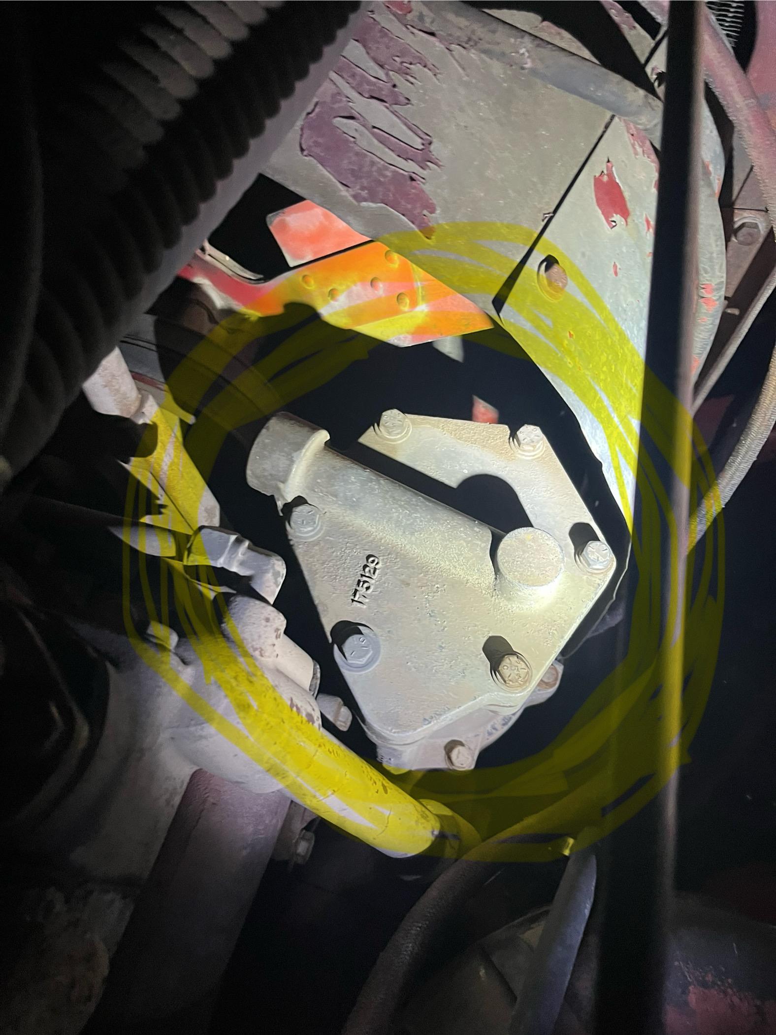

I highlighted the coolant line to the bumper with yellow and circled the device in question at the front right side of the engine
https://www.bigmacktrucks.com/topic/74914-1953-mack-lj/page/3/#findComment-565039
I believe the last picture is an oil cooler.
Thanks for the color on the line, but with only one line to the bumper, I can't see what they are trying to accomplish.
Lots of "bodged" stuff on that truck, so it is hard to say what was done why.
https://www.bigmacktrucks.com/topic/74914-1953-mack-lj/page/3/#findComment-565040
Definitely the oil cooler circled.
https://www.bigmacktrucks.com/topic/74914-1953-mack-lj/page/3/#findComment-565043
That's the oil filter. I pulled the cover off mine and it has a pleated paper element inside (Wix 51954). The cover gasket is like $50 so I just reused my old gasket.

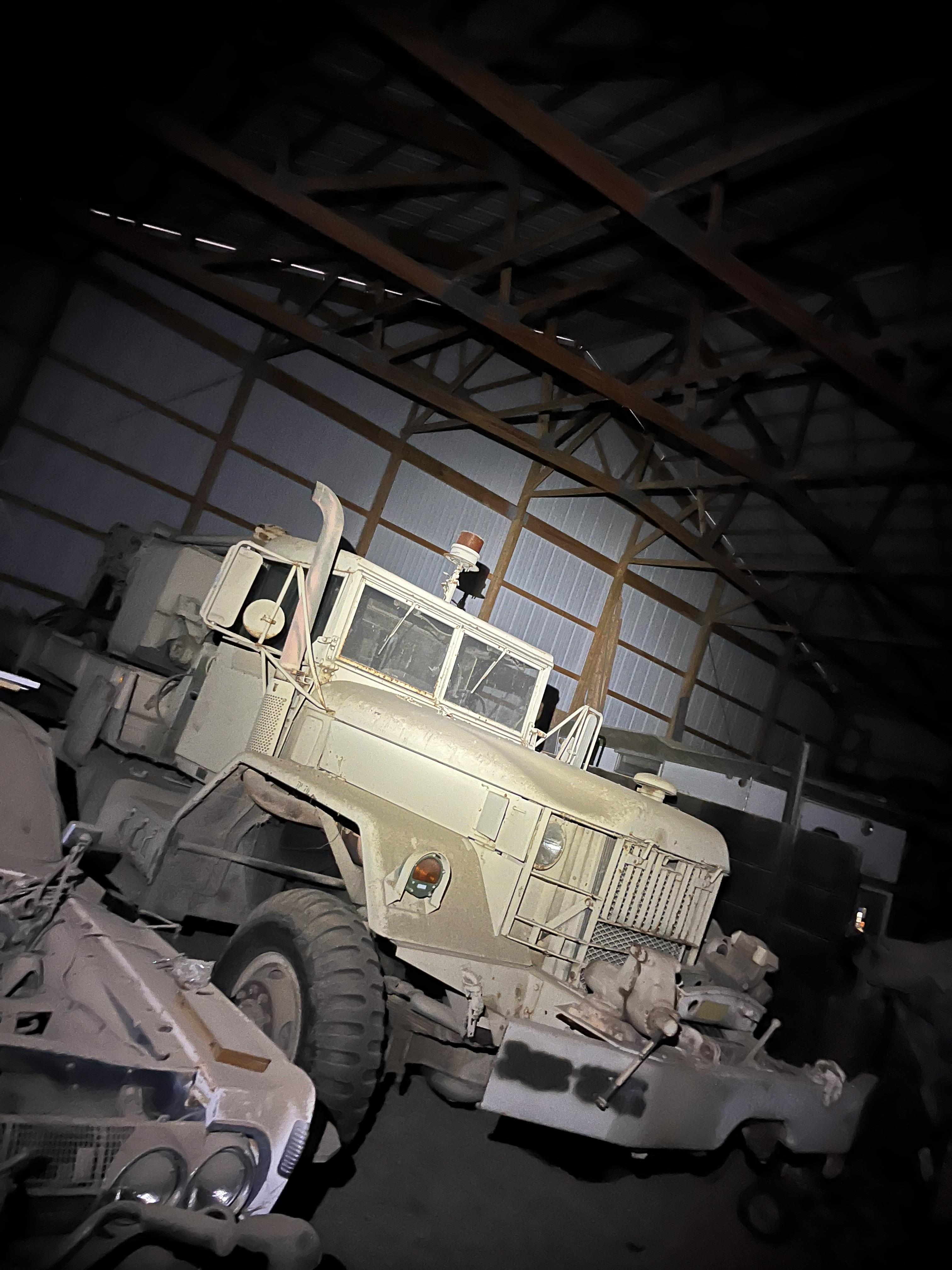

Ive looked at the pictures a dozen times. There is a lot going on with this truck. Lots of ad-ons and such.  Is it a common example of a truck built for what it does, or is there a lot of home made things on it?  Not picking on the truck, just curious.  I like the truck.
https://www.bigmacktrucks.com/topic/74914-1953-mack-lj/page/3/#findComment-565071
I think it is typical of a truck that was used for several different jobs over the years in industries that had motivated people willing to innovate to get the job done.  It’s definitely been hot rodded trying to get more power and gears, air filter put outside the engine compartment in front away from heat, or lubrafiner out front to remove heat,  crazy coolant bumper, whatever it’s purpose it took some time and skill to create and at least dissipates heat.  If it was cracking they welded it, bolted it or wired it.  Safety and liability don’t seem to be at the forefront.  Weight didn’t seem to be a concern, only brute force.  Get the Job Done!
Very much like my Dart Oil Field truck
https://www.bigmacktrucks.com/topic/74914-1953-mack-lj/page/3/#findComment-565079
am I allowed to be confused here :: topic is "
53 LJ  of which is red:: then pictures show military style truck??? who has the bumper cooler?? the milatary always have units built above and beyond needs.
don't blame me blame yukon jack.
There were some that had a "high mount" oil cooler, but now that you mention it, I think those were horizontal, not vertical.
You nailed it I believe. I never had a Cummins that old.
