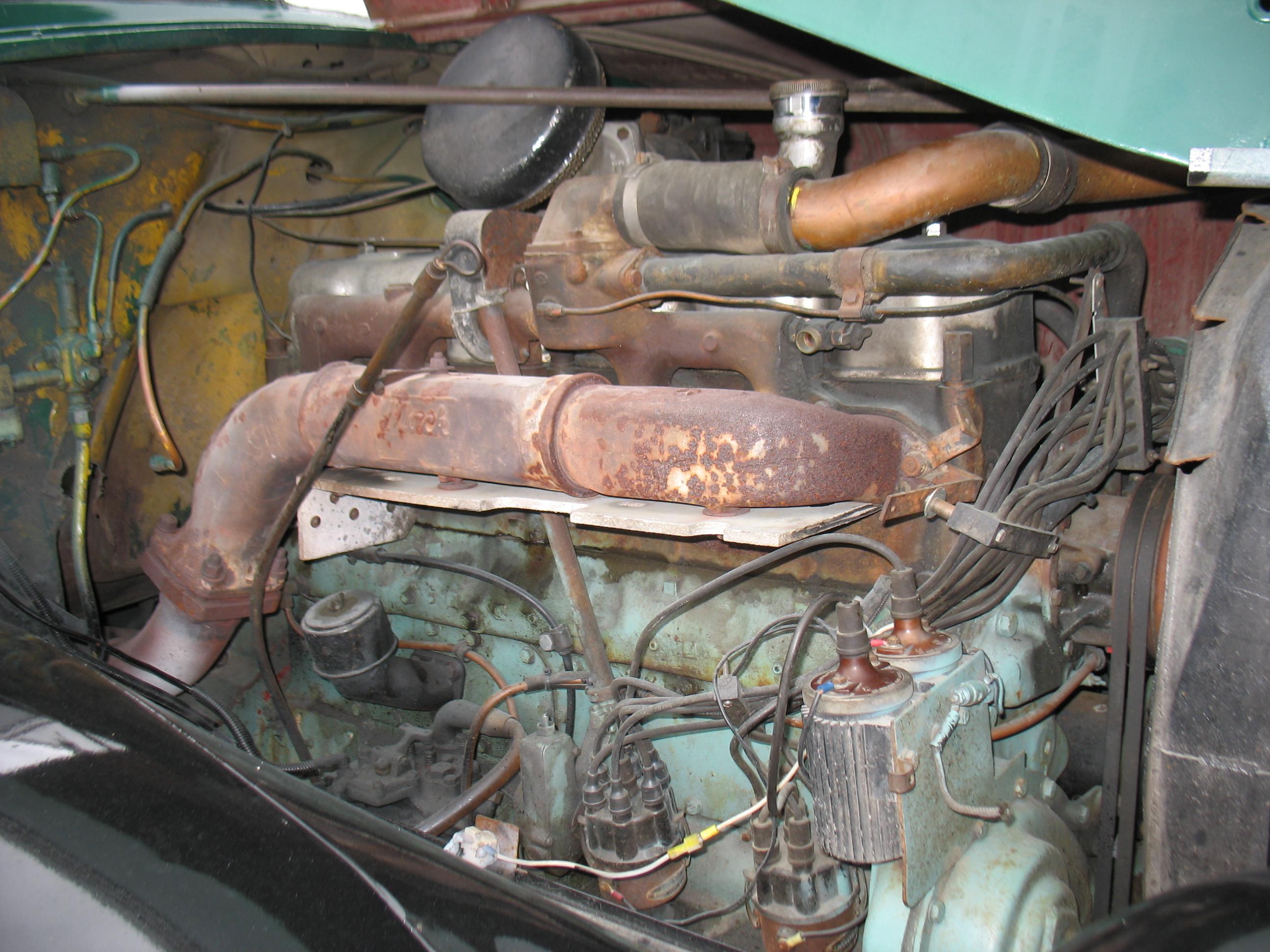

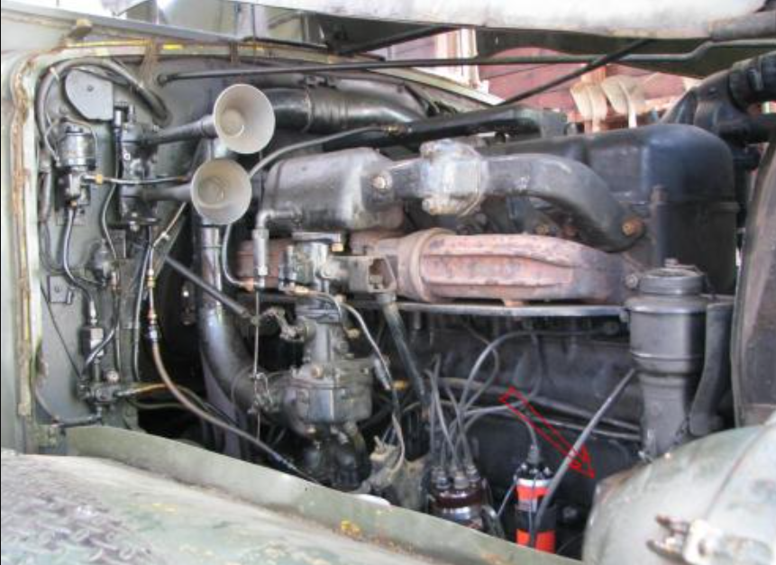

Seems like those dual ignition fire truck heads were significantly different on the 707. Even different sides for intake and water manifolds
Third picture is regular truck engine with updraft carb and single ignition
