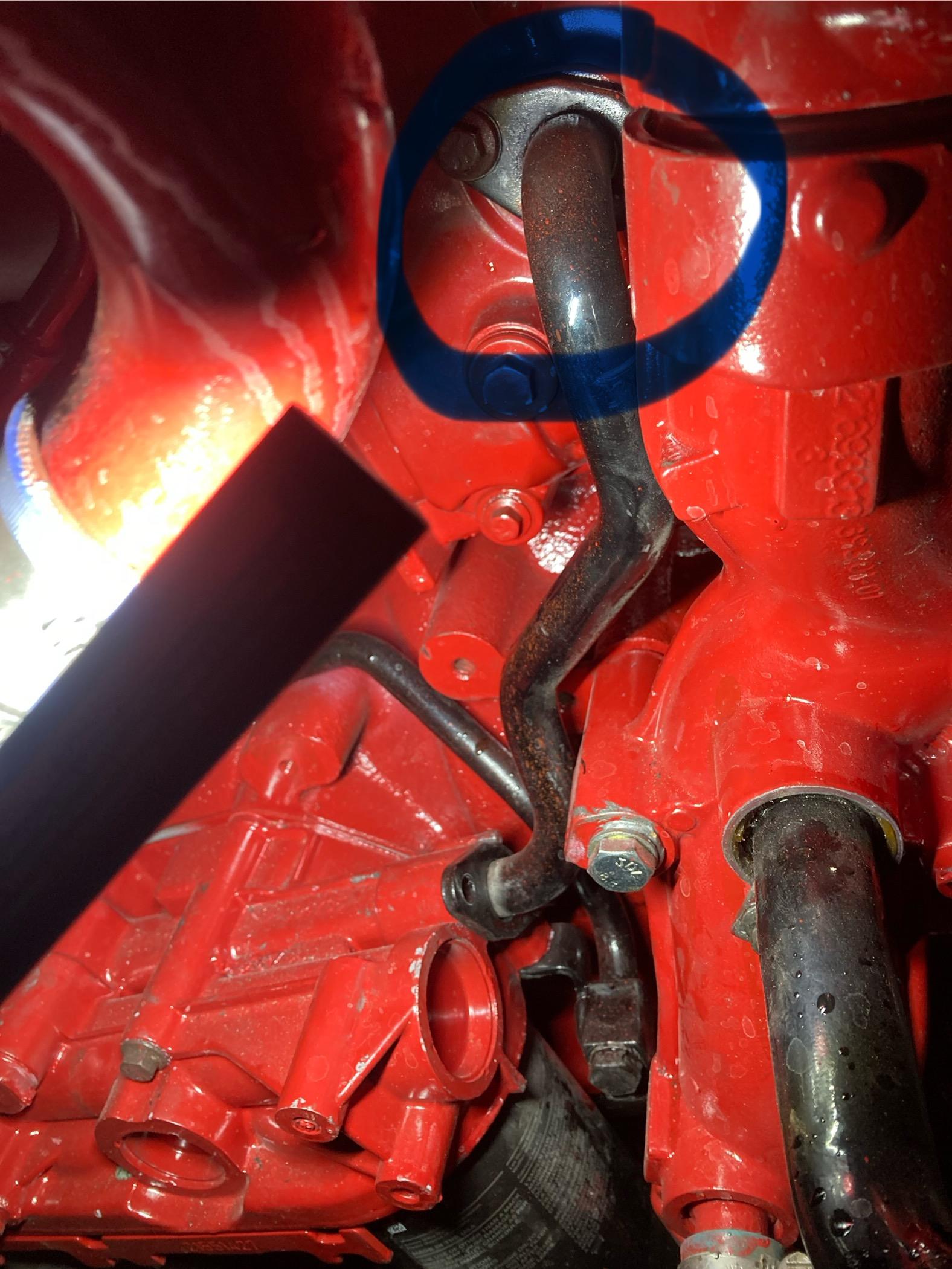

The gasket that is between the cover that hold the oil cooler and the block is leaking on my 2013  cxu 613 Mack with a mp8. I watched like 4 videos on YouTube, they were all leaking in the exact same spot as mine. Apparently it’s a common problem . When I put a new gasket in, do I use any kind of sealant on it?  I will take any tips or tricks. Thanks
https://www.bigmacktrucks.com/topic/74927-mp8-oil-cooler/
There was a design change around your year model. The original MP8 side cover had a grove machined into it and a rubber sealing strip that went into the grove to form a seal/gasket. They updated the side cover to a smooth surface with a metal gasket with rubber seal made on the gasket. I remember replacing the whole side cover to get  the new style cover/gasket because the old string rubber seal was discontinued.
https://www.bigmacktrucks.com/topic/74927-mp8-oil-cooler/#findComment-565350
