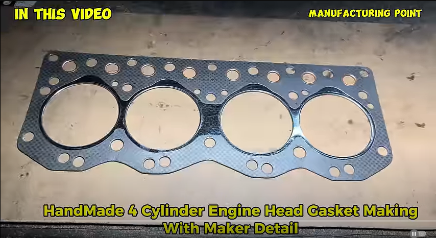

Before you get all dewy eyed over these third world repairs, stop and think a moment. I am not saying they aren't skilled at the labor they do, but for the repair to be viable, there is far more than that.
 I have seen many of these videos, no where do you see the total man hours of labor. Neither do you see the man hour of labor to get the problem broken down to the repair point.
 Now we get into metallurgy where axle or crankshafts are repaired by boring and welding in a plug, then over welding and machining back down to original dimensions. There is no way that shaft has the same strength and ductility of the original, the one that just failed, how long do you think a weaker part with a section that is weaker than the original will last?
 Yeah, I have taken a bend out of a hyd rod, but you know as well as I it is a temporary repair at best.
Not taking anything from their mold-making abilities, but casting an engine part is more than just making a good mold. You need high quality iron alloy to make the cast.
What does a good mold make get paid in the US?  then add up the hours involved and that off the shelf with warranty starts to look cheap.
Between exchange rates and labor costs it leaves the 3 rd world little choice, but that doesn't make it a good one.  How many of you are willing to stand behind and warranty a re-welded axle shaft?   A re-cast cyl head of unknown  metallurgy?
It isn't because we are all "pansy's" in the developed world, it is because we have better options.
Pull those craftsman out of there back ally shop and set them up here, and you wouldn't be able to afford them.
Yes, it is impressive what they can make out of nothing, but that doesn't make it suited to the job, It may look exactly like the part, but it will not be of the same caliber.
How many of you have bought a cheap "Harbor freight" vise only to have the casting break the 1st time you hit or crank down on it? Yeah, it "looks the part" but can't do the job!

I kept the double decker buses running in Chicago, parts? they were obsolete in England, and not many around, then air freight to the US.  Most things could be made, but I would never weld a broken axle, There are repairs that are sound, and those you do, but there are those that can't be made to the standards required for the job.
 Make my own headgasket, yeah, I've done that. build up a waterrail and re machine, yeah I've done that. But weld a broken axle or crankshaft, Yeah, I'm smarter than to do that!
We always had one or two waiting on something that could be used as parts for another until the missing parts can be sourced.
Emergency repairs to "get you out of the hole" will come back to bite you if you don't address the problem. I changed out an exhaust valve spring in the field, only to not be allowed to address the real problem once the work day was done. It needed the head to come off, and the guides replaced (they were so bad exhaust gases passed up the guide into the rocker box).  Always time for emergency repair, never time to do it right. head of valve snapped off took out the bore, piston and head.
I don't get that hydraulic cylinder repair at all, what is burning oily rags underneath it supposed to do? And there at the end they realize it cannot be straightened and the video conveniently cuts away.
While the head gasket and casting videos show some real skill I think most of these videos are just view farming to entertain kids with low attention spans.
