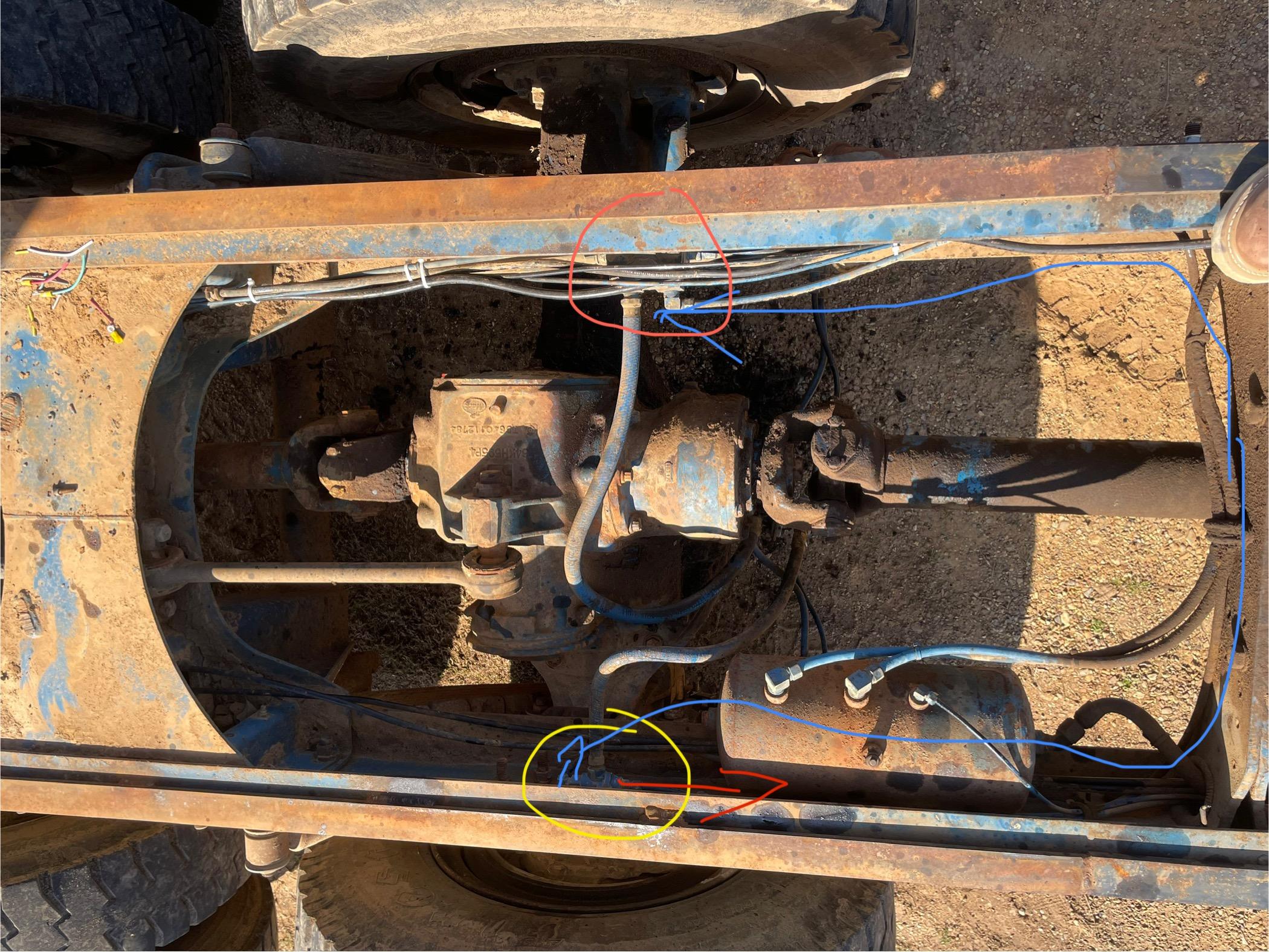

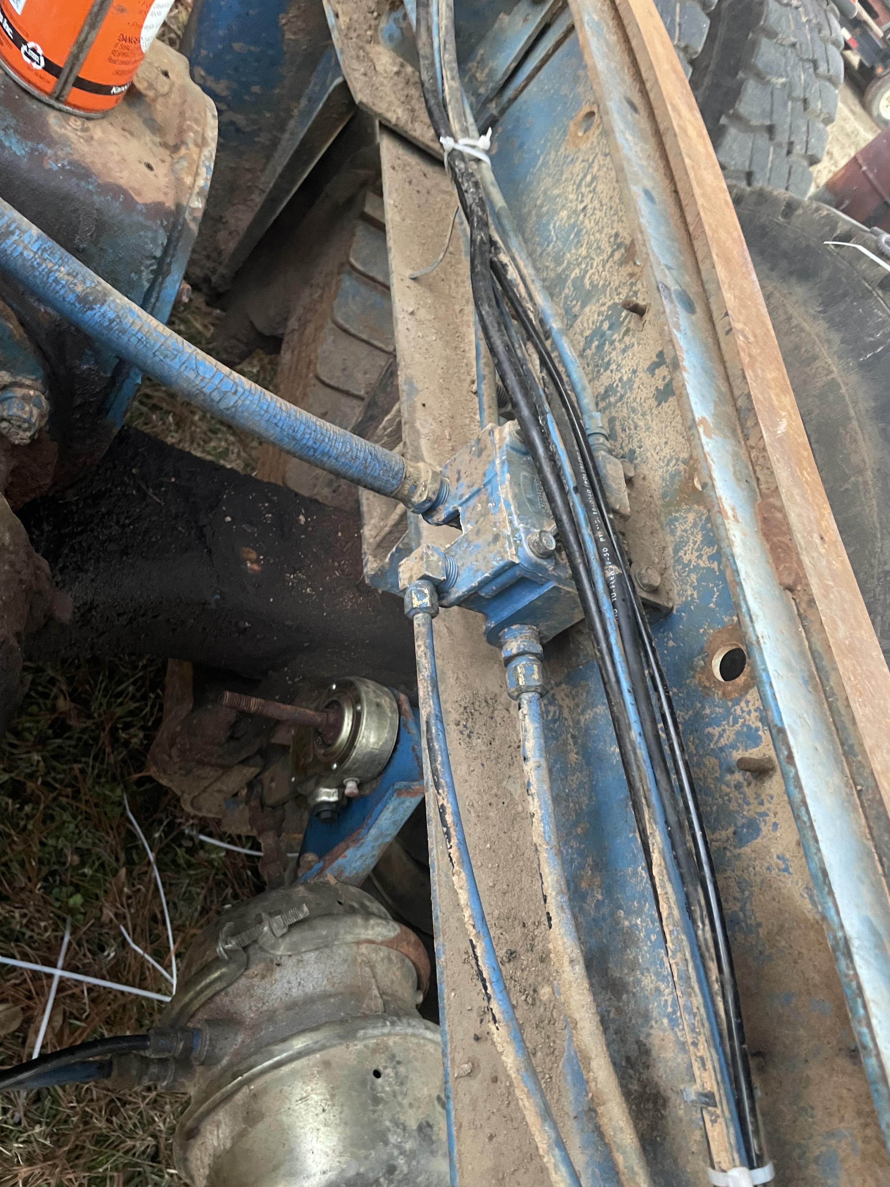

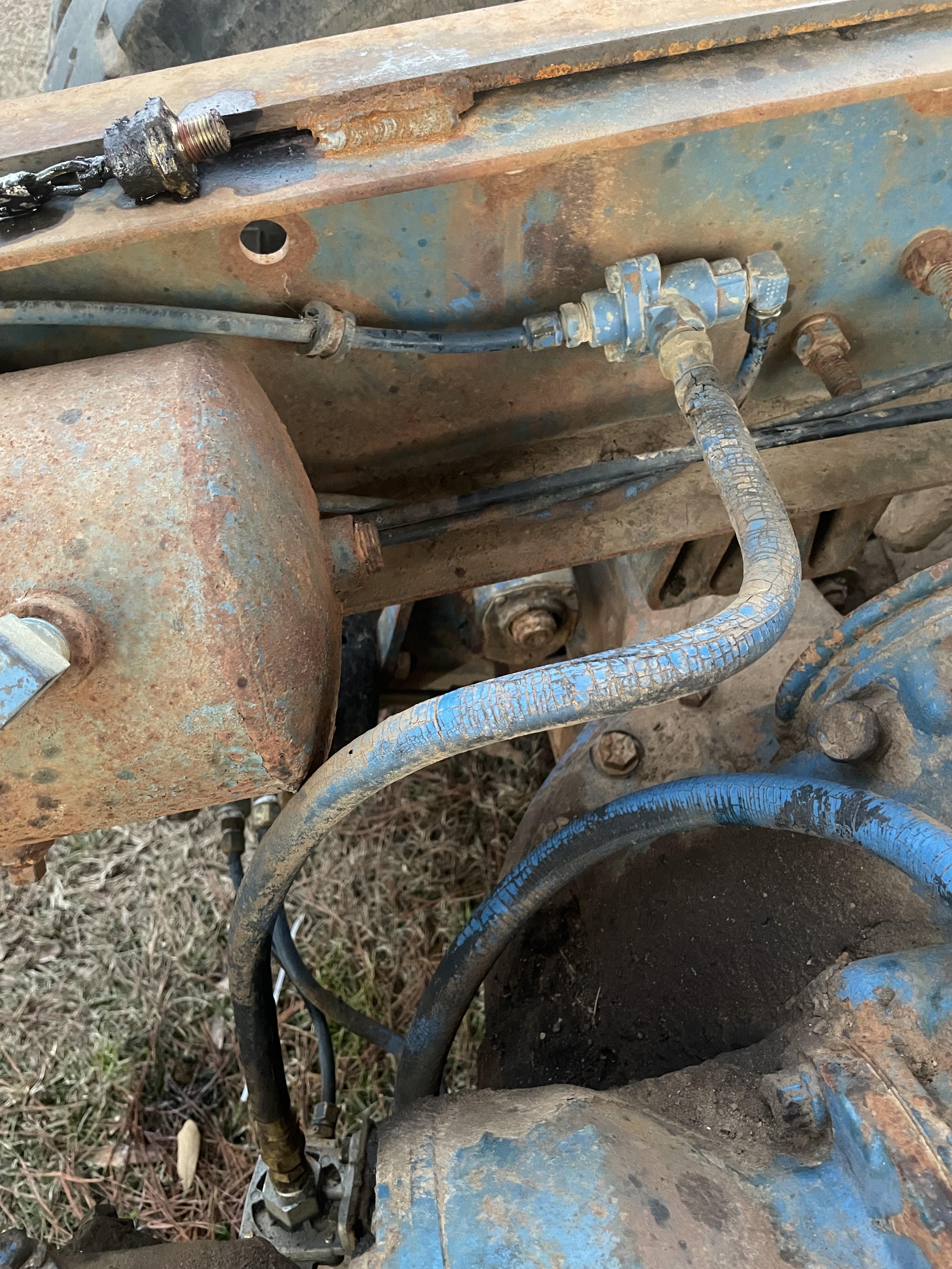

Have you disconnected the QR1 valve before the maxibrakes to see if the line feeding it gets air when you push the tractor parking valve? If it doesn't, trace the line back from there, maybe a section of the line is crushed or collapsed on the inside. Hopefully someone didn't work on the truck before and hook something up wrong.
