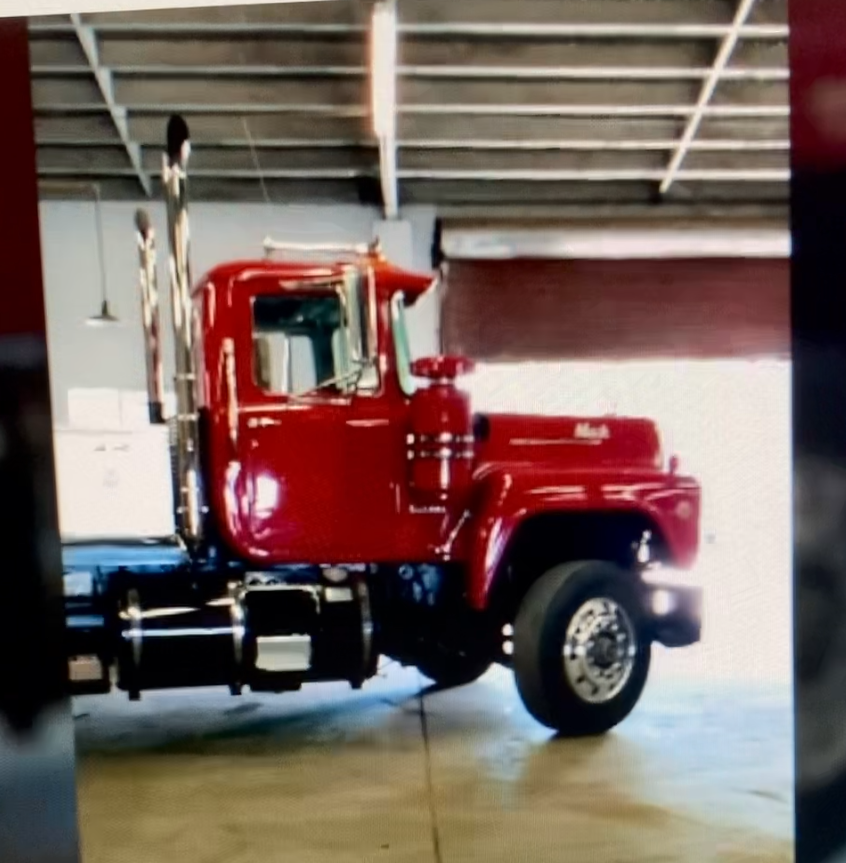

That truck in my profile came from Norm Taunton in Galt, California.  Terry:MackLogo: B733
Edited by terry
I think we had this conversation a while back I’ve bought a lot of parts from him and sent a lotta guys over there I met him in Fontana California at an ATHS around 23 years ago he was driving his N model last time I saw him he just bought a gorgeous R model that didn’t need any thing I have pictures of it
off topic. how is Norm doing. I have not spoken to him in a few years now. my last visit with him was probably 8-10 years ago now
I haven’t seen them either. I think the last time I was over there I was on vacation about six years ago. Somebody on here just talked to him recently because I sent him over there for something guy was looking for a  bulldog, long eared within a year or so he was still with us.

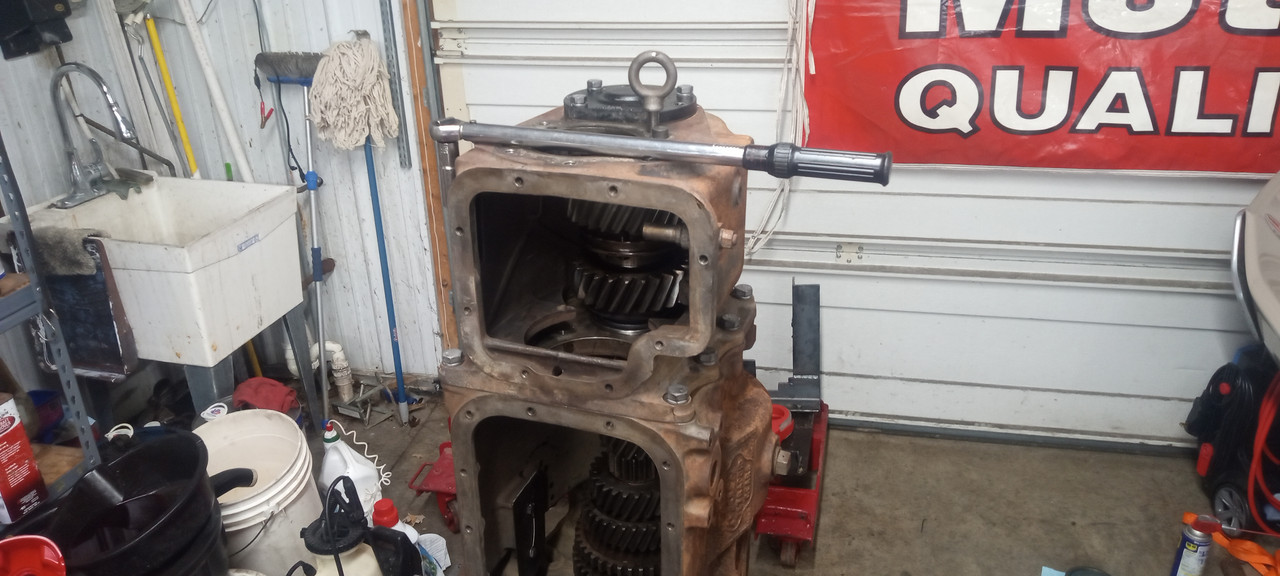

Is bearing pre load between.003"+.006"? Are you able to buy shim paper and cut your own shims.  Ive done that a couple times.. just need a scissor..
Countershaft is by torque using a fish scale and pulling a rope wrapped around the shaft.  8-11# pull if I recall.  Mainshaft is +.001 Freeplay I think.  Have to go out and read specs.
I'll make shims but Kevin All is sending me a few pieces so I asked if he had any shims laying around.  He said he had a trans with back box already off it.
Larry
Given that somebody had been in there before (by the block oil to the bearing) I wouldn't trust anything. If I am the first inside since build, most times the same shims can go back and be correct.
A local gear shop I used (past tense) was sending re-bearing pinions with 0 pre-load on the bearings! fortunately I saved the old spacer. They claimed I didn't know what I was talking about, and pre-load would burn out the bearings!
So using my 13% :) Building the mack transmissions I used to build,  re-used bearings were set to .002"-.005" pre-load, and new bearings were set to .003"-.006" pre-load..
I beleive Eaton uses end play,  i suck at those. I can kick the crap out of of the back boxes on many models, but sick at building the main boxes..
