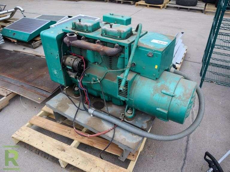

These JC ONANS are great too, run them on propane because you can store it forever. I had one on natural gas run a whole police district in Philly for 3 months when a primary fuse blew on the pole and nobody really noticed until the Onan shut down for low oil. Picture is of a Onan 12.5 JC , But the JC series comes in a couple sizes I think a 6.5 is the smallest and something like 15 is the largest. And the KW rating is real, not  like these 3600 rpm units with their BS ratings
my 17.5KW is a RDJF, the king of the Onan diesels.
it came from North Bergen DPW. it was the backup power plant for the high pressure sewer pump .
never used for anything but run time once a month for 5 minutes a month, for 40 years.
power went out ONCE in the 40 years it was in service, and it ran for 2 hours.  the other 4 hours were put on it by the guy i got it from. he bought it from the town to use in an automotive shop he was starting.  was there 6 months when the building owner sold it and the new owner kicked him out.
the new building he found already had a generator, so he no longer needed this one

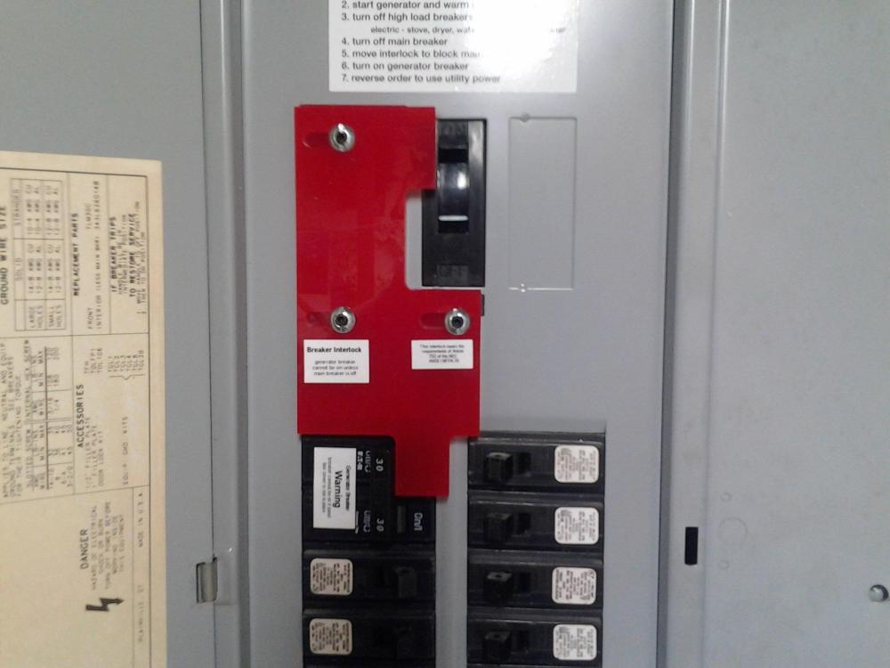

There is no reason to use a suicide cord when interlocks for your breaker panel are cheap. They are only like 50 bucks

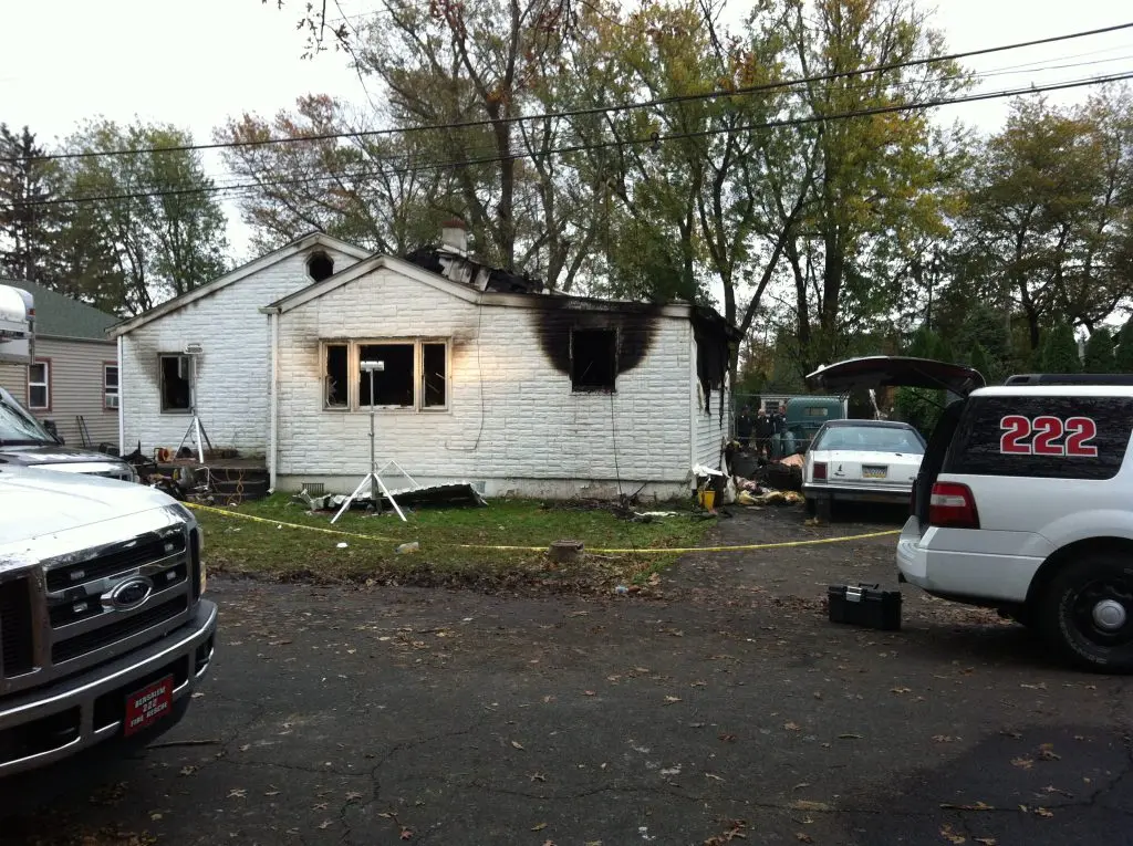

Here is what a suicide cord did to John Griffin's (Big Time Brockway collector from Philly) Daughter in law and her mother during Sandy. BTW some of the members here knew John
Quote
Two women died in an overnight electrical fire in Bucks County that authorities say appears to have been storm-related.
Officials say it happened early Wednesday morning at a home on Marion Avenue and Street Road in Bensalem. Two women were inside the house when the fire broke out.
Jeff Moran, a spokesman for the Philadelphia medical examiner's office, identified the victims as 64-year-old Kathryn Griffin and 90-year-old Helen Markert.
He said they were both pronounced dead at Aria Health-Torresdale in Philadelphia, where they were taken following the 3 a.m. Wednesday blaze.
Three volunteer firefighters were reported injured battling the flames, which were first spotted by a passer-by in the Bucks County community.
Flipping a main breaker is free... I personally think impossible to forget how and/or improperly execute the sequence of back feeding your main panel without a transfer switch or interlock contraption. This Isn't Quantum Physics. So long as the "suicide cord" is sized for the max amps the generator can provide or better yet sized for 15% more amps than the 240V double pole breaker your backfeeding through there is nothing to worry about IMO.
