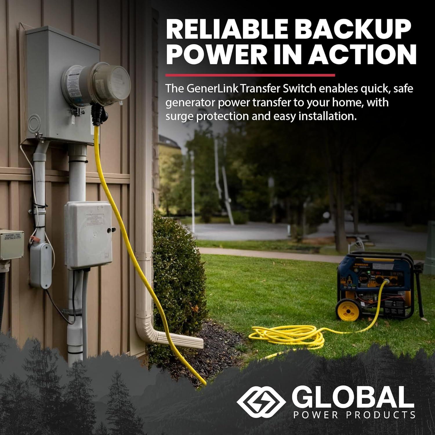

Here is the quick and easy transfer switch, power inlet solution. But they are like 1000 bucks, Only takes about 10 minutes to install

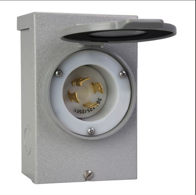

On the topic of electrical wiring why did we get away from the 3 prong 220 plugs and outlets? All our 220 stuff still has the old style but our new generator has the 4 prong style. I get that the new 4 prog stuff had an interlock and is safer for idiots but its that the only reason?
Bob, this plug also separates the neutral and the ground wire. The older plug caused folks to connect the white and green wires together. The green wire now goes to "Earth".. As a (not an electrician) this is the best way i can describe it..
yes, the 4 wire separates the ground from neutral.
which then get reconnected in the power panel.

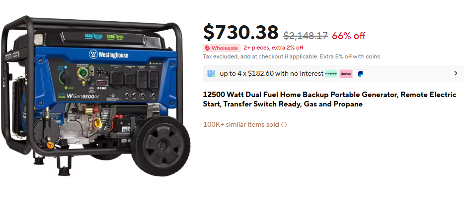

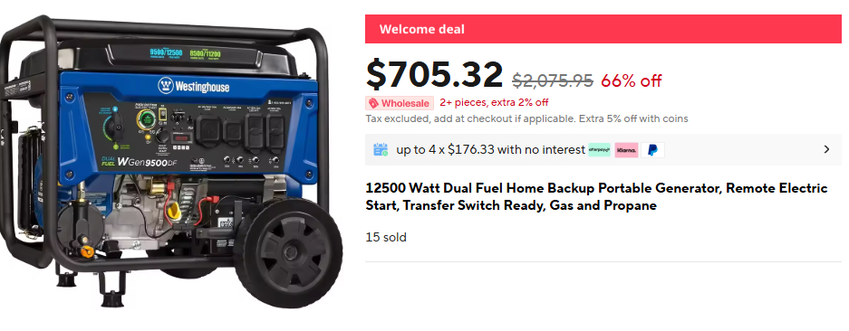

Yep, after much research- ok, I looked around on the interwebs a little bit- that's what I decided would be best. You can even order Westinghouse generators from Amazon, and all the reviews of Westinghouse generators were good, on several different sites. And a smaller one that you just run a generator cord in through a window or door is around $600. It said you could run several extension cords from the generator cord safely to power the refrigerator, freezer, coffee maker, etc.  Or a still smaller and cheaper unit that they recommended running the refrigerator for an hour, then the freezer for an hour, then the "something else". I'd get one bigger than that, but yep, the gas powered portable is the way I'm gonna go.
https://www.aliexpress.us/item/3256807974658564.html?src=google&pdp_npi=4%40dis!USD!2095.78!730.38!!!!!%40!12000044040687552!ppc!!!&src=google&albch=shopping&acnt=708-803-3821&isdl=y&slnk=&plac=&mtctp=&albbt=Google_7_shopping&aff_platform=google&aff_short_key=UneMJZVf&gclsrc=aw.ds&albagn=888888&ds_e_adid=&ds_e_matchtype=&ds_e_device=c&ds_e_network=x&ds_e_product_group_id=&ds_e_product_id=en3256807974658564&ds_e_product_merchant_id=5507959052&ds_e_product_country=US&ds_e_product_language=en&ds_e_product_channel=online&ds_e_product_store_id=&ds_url_v=2&albcp=20542171673&albag=&isSmbAutoCall=false&needSmbHouyi=false&gad_source=1&gclid=CjwKCAiAhP67BhAVEiwA2E_9gwnAfdpv2Vp0ag1bv4zEEqqX6isPbkYU5Ezo6G8jsqw75s5PvHl3HBoC2FgQAvD_BwE&gatewayAdapt=glo2usa

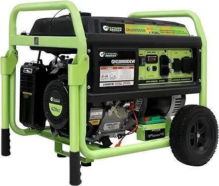

That is a lower price than my 10,500 watt unit that i got from Amazon in 5 days.  Nice find JC..
I agree joey I just went thru the skunky gas issue with mine I wish I had gotten the  propane option at that point! How ever got it running again!
Actually, my genny is now $800.00 i paid $1,100.00 a year and a half ago.. its a dual fuel model with electric start and the battery came with it
