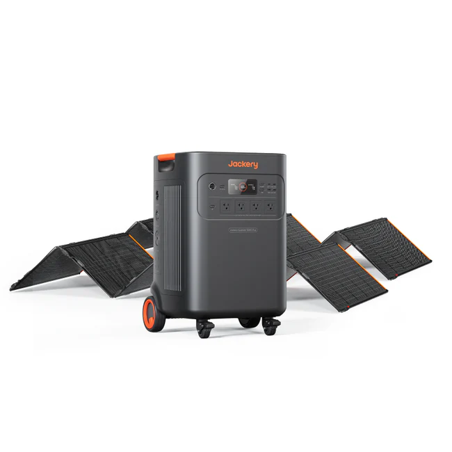

I can never talk people out of buying these things. 5 kilowatt hour capacity for like 4000 bucks. If you are careful maybe, just maybe running nothing but the bare essentials you might get 6 -8 hours out of it. And they include "fast charging solar panels". Yeah, like 500 watts of solar. Maybe if your idea of fast is like a week to charge the damned thing.
I mean I guess if you live in an apartment in a high rise somewhere, it's the best you can do ,BUT,,,,,,,,sg5000plus_650x.webp.e0ee9dca18a538509508fe65d426f0d3.webp

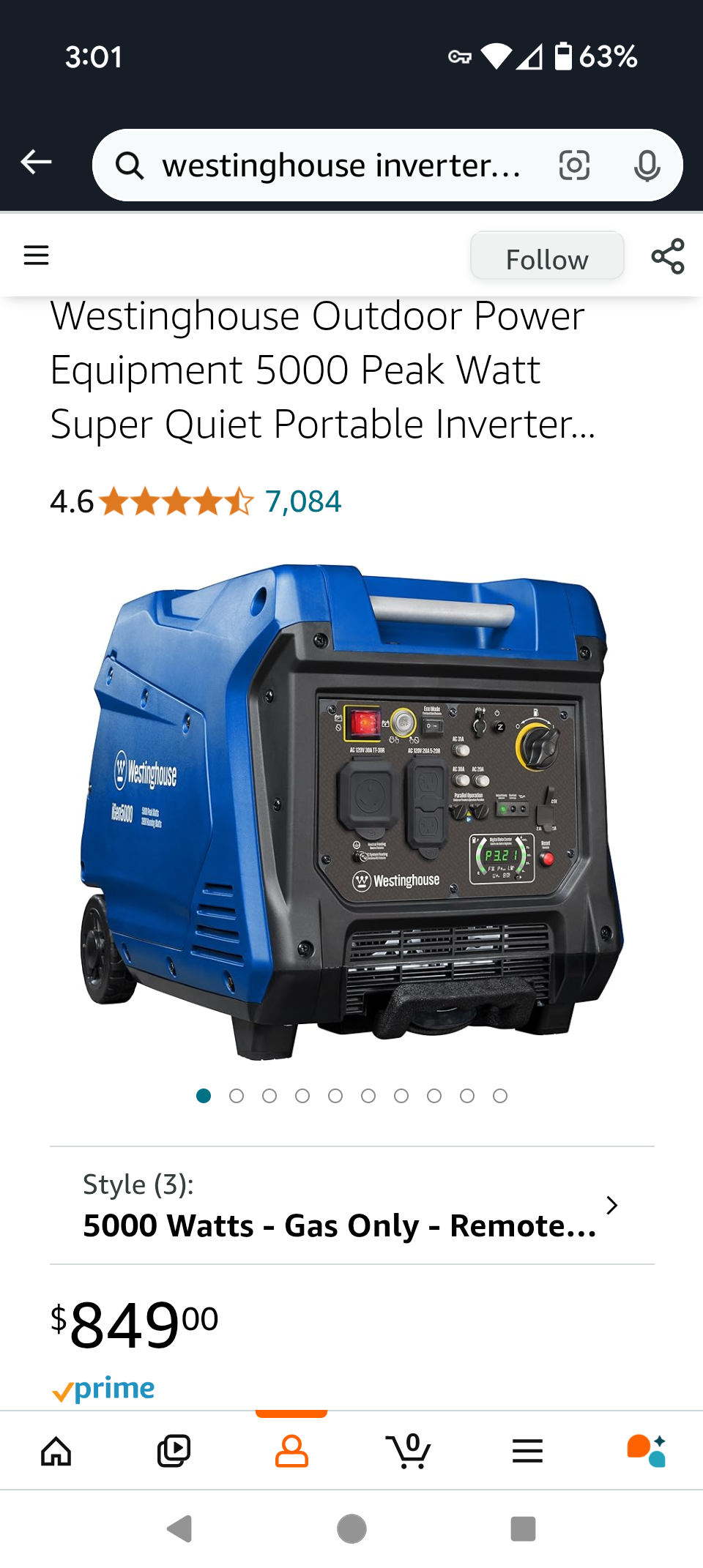

Thank you for the kind words, I don't know about all that, but I did "buy now with one click" on this one.
agreed. it is unbelievable how many people ask me about those "as seen on TV" solar generators because i have 7 different size generators.
i try to explain they are not generators. they are battery packs.
and if it is "as seen on TV" it is about as useless as teets on a bull.

that is a pretty good unit. when you get it running,  turn the fuel valve off and see if it shuts off, or stays running until the carb runs dry.
if it does not stay running open the cover and unplug the kill switch hooked to the fuel shutoff.
this way you can let it run and drain the carb after use before you put it away.
ALWAYS put it away with a dry carb.
And ALWAYS use non-ethanol gas!
1 minute ago, Brocky said:
AND ALWAYS Use ethanol  free gas whenever possible!!!!
I was posting that very thing when you were.

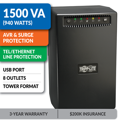

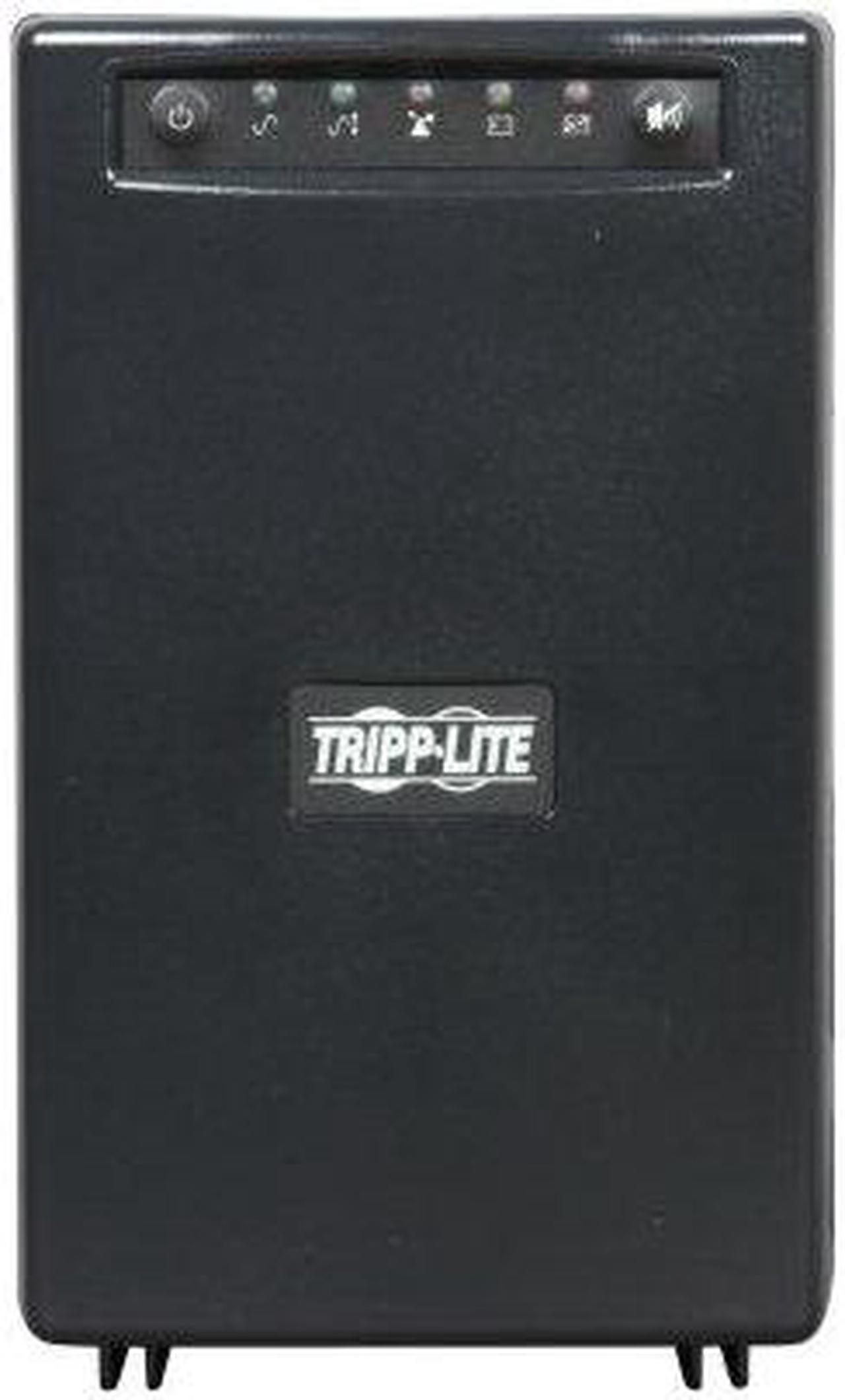

I used to have a triplite 1500 with lead acid batteries that I trash picked. Probably from the 90's, Worked really good, had lots of capacity. Batteries got weak in the early teens before I moved up here. Not sure where it went
Todays U.P.S. units are solid state, and offer surge protection, Hertz balance, and back up power for a short time keeping her computers powered up, while he cranks the Genny..
This was a pretty fancy commercial unit. It detected over and under frequency, under and over voltage, and sine  wave distortion. It would alarm and take the load, indicator lights on the front to let you know why
It was this model, but it was white
