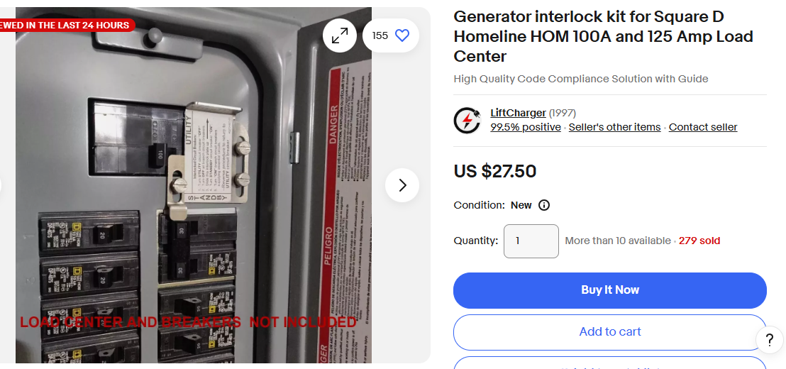

Really an interlock is cheap. I spend that much on a white pizza with spinach and ricotta. The worst case when installing one is you have to move a breaker to a lower spot to make room for your generator breaker. Like an hour of work tops
