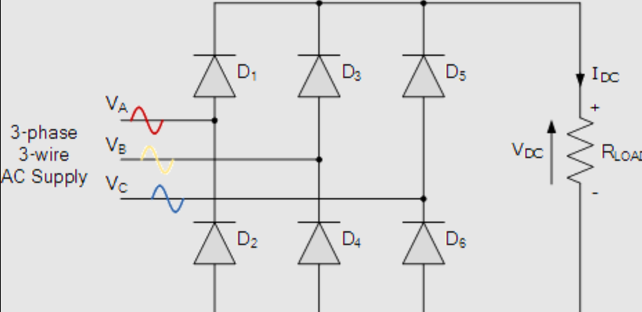

With those ebay diodes haw are you going to end up like this. You need 3 diodes going one way and 3 going the other.
You know I was just thinking, being that it is a 3 phase source, the current on each phase should be ( the dc current output divided by the square root of three)
So each individual diode is not really carrying the full DC current
