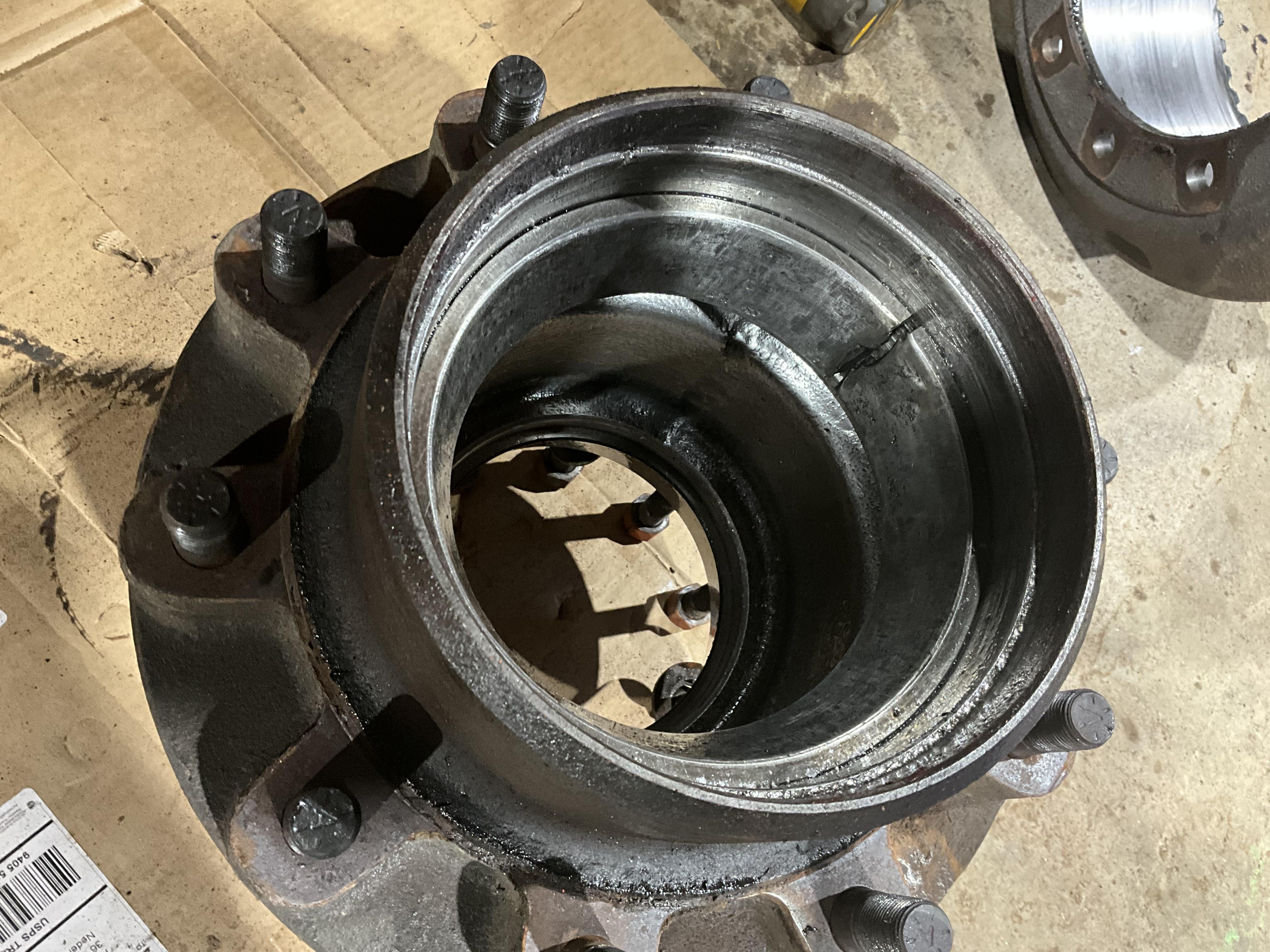

Measure the hub, I can see the bearing is busted but can't see the hub damage

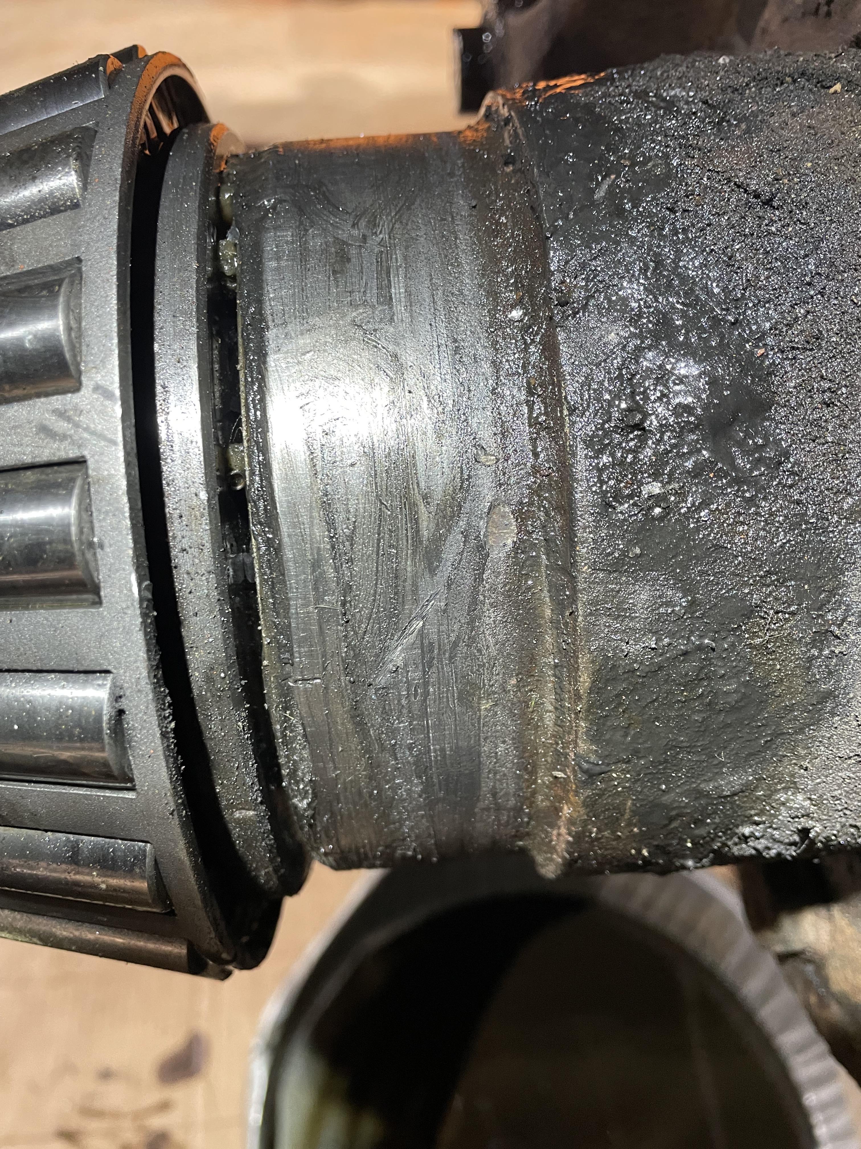

Can clearly see the axle damage

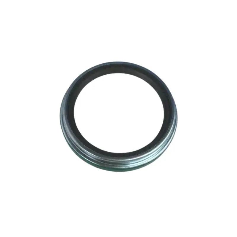

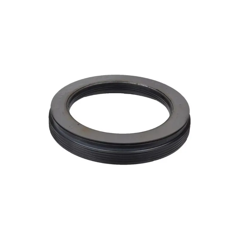

A seal like this will probably work fine here as the rubber bit doesn't spin

I just realized I mis-read the 1st post, It isn't the hub that is cracked, but the bearing race. Knock out the race and inspect where the bearing goes. Get a new set of bearings, or at least an outer race, and see if it will press firmly into the hub. If so, you are good to go, if not you can look to replace the hub or have it built up and re-machined to hold the bearing.
Building up and re-machining will cost a few bucks, but everything you have can be re-used.
 New hub means new drum and may be new wheels.
If your lucky it will hold a new race and can go back together.

Thats quite possible. He will just have to fit a hood race in there to see. It may have spun a groove inside the bore, we dont know yet.  Im still surprised a replacement hub cant be found in the parts lookup system .

I had hubs "spray welded" and re-machined before with good results. Often the amount of metal needed make a sleeve difficult and over-boreing  effects the seal area also, so sleeve would have to extend out to there.Hub is thin at that area. If you have go with machine work talk to a few machine shops to see what they recommend.

I didn’t know there were sleeves available! I JB welded it in (I know….) just to get it out of the shop, as that’s worked on excavator bushings pretty well for me to avoid line boring. I will have to go this route once it starts leaking again.
SKF has a line of speedy sleeves. When you can, measure the diameter of the spindle where the seal goes. Use a caliper. The part number of the sleeve contains the measurement..
