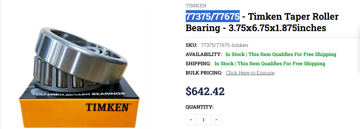

$642 Holy Chit. is it made out of gold or something?

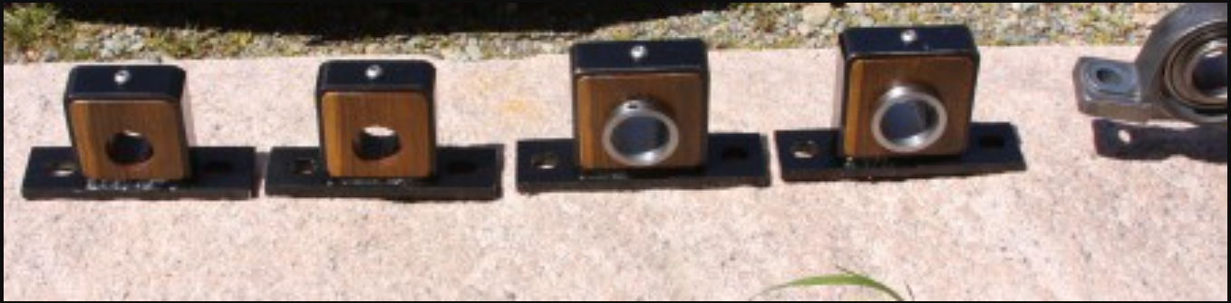

Pretty soon we are going to have to go back to hardwood bearings lubricated with possum grease

I hadn't finished my coffee before I posted, so made a mistake.
However, there are many options. The shaft size is 3.75 and the bore as it is now is 6.75, You could have a sleeve made to bring the O/D down to 6" and get a real common 594 bearing. That make the sleeve thick enough to not be a problem.
The shaft size has more an effect on the load capacity then the OD of the bearing.
It is even possible that someone in the past bored out the hub to make a repair and put that odd ball bearing in there.
A good machine shop should be able to fix you with something that is a permanent repair.
You need to measure the seal diameter at the spindle, if a common size, the best thing would be to press in a sleeve in the hub to take a common bearing and seal.
Janka Scale Scores:
Lignum Vitae =4,500
Hard Maple, Sugar Maple 1,450
Lignum Vitae is 3 times the hardest of Maple bearings and is self-lubricating. Maple bearings are currently impregnated with oil, grease, or wax that can’t match the lubricity or low friction that Lignum Vitae offers. If you are using Maple bearings as a screw, roll or conveying machinery bearing for agriculture try Lignum Vitae wood bearings and enjoy much longer life from the bearing, less downtime and better operation.
