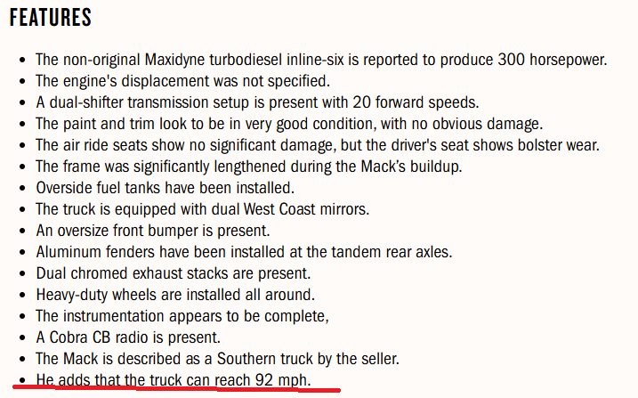

Looks like it bid to $10300 and was a no sale. Now asking $21000.

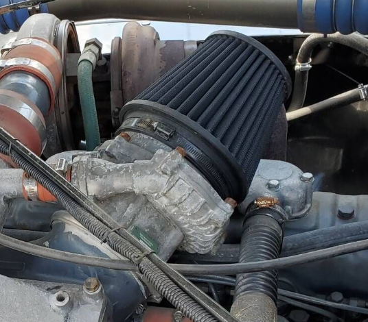

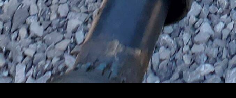

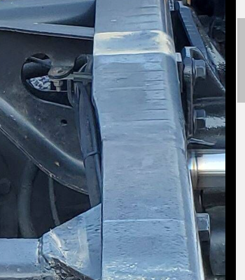

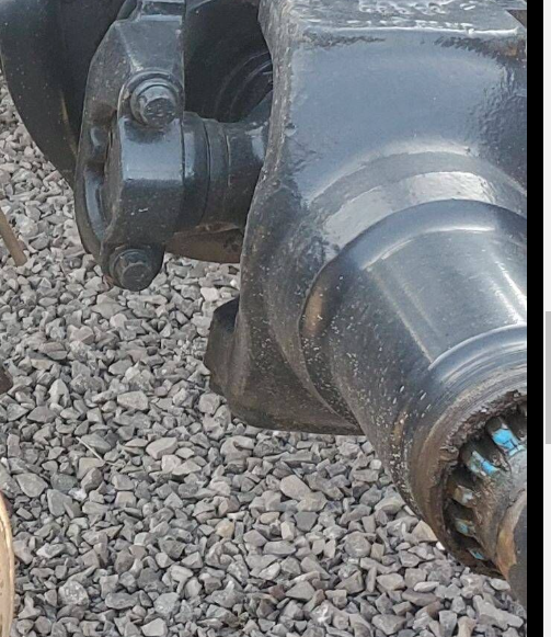

Not worth anything like that. Too many things done wrong. He states that it will run 92 MPH (Geared Wrong). Frame stretch looks hacked. Air ride is from something with wider frame rails, and I'm not seeing any overlap or fish plates. Drive shafts were all made a little short (Look at the spline engagement). Tip turbine intake is hot underhood air. Too many signs that he didn't know what he was doing, so I'm sure there are other problems

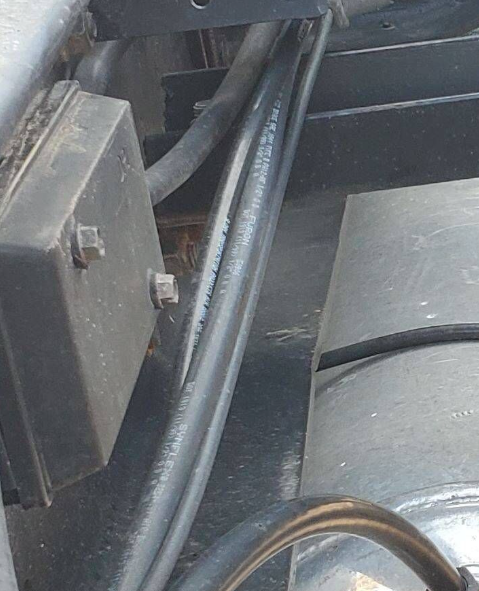

Rears must have like a two something ratio. Every "Custom" Truck I see is poorly engineered and hack work, covered up by paint and chrome. I can think of one that came in for inspection that had the frame flanges notched to put a headache rack on it that was for something else. Looked good from across the lot though. Just don't crawl under them
Oh, and like always with "customs" all the lubrication points are bone dry

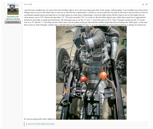

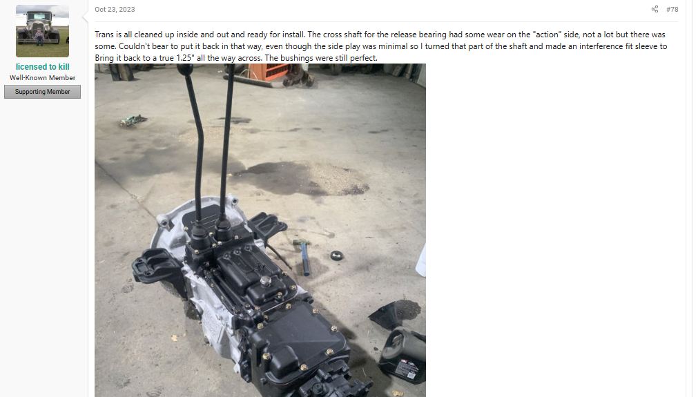

Perhaps you can post some pics of your truck builds to show us how it’s done?  BTW, “custom” trucks (and other vehicles, like classics, hot rods, restomods and all other vehicles that are/were built to be special to the owner) often have “dry” looking grease zerks because the owned wipes the zerks clean after greasing. “Show” vehicles often get a lot more detailed attention than daily drivers or work trucks, oh, and the definition of what constitutes a vehicle worth wiping the grease off the zerks is entirely at the discretion of the owner.

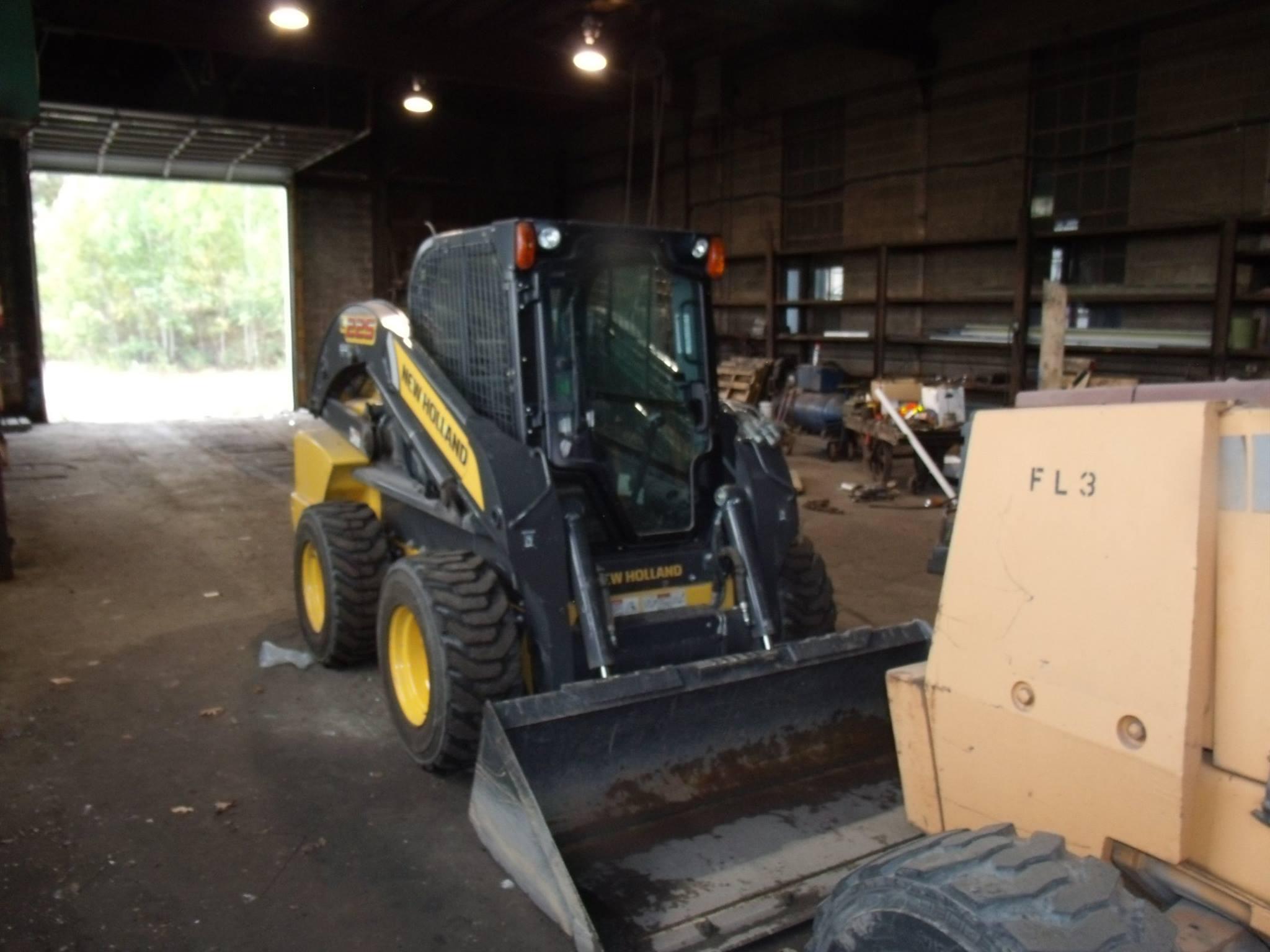

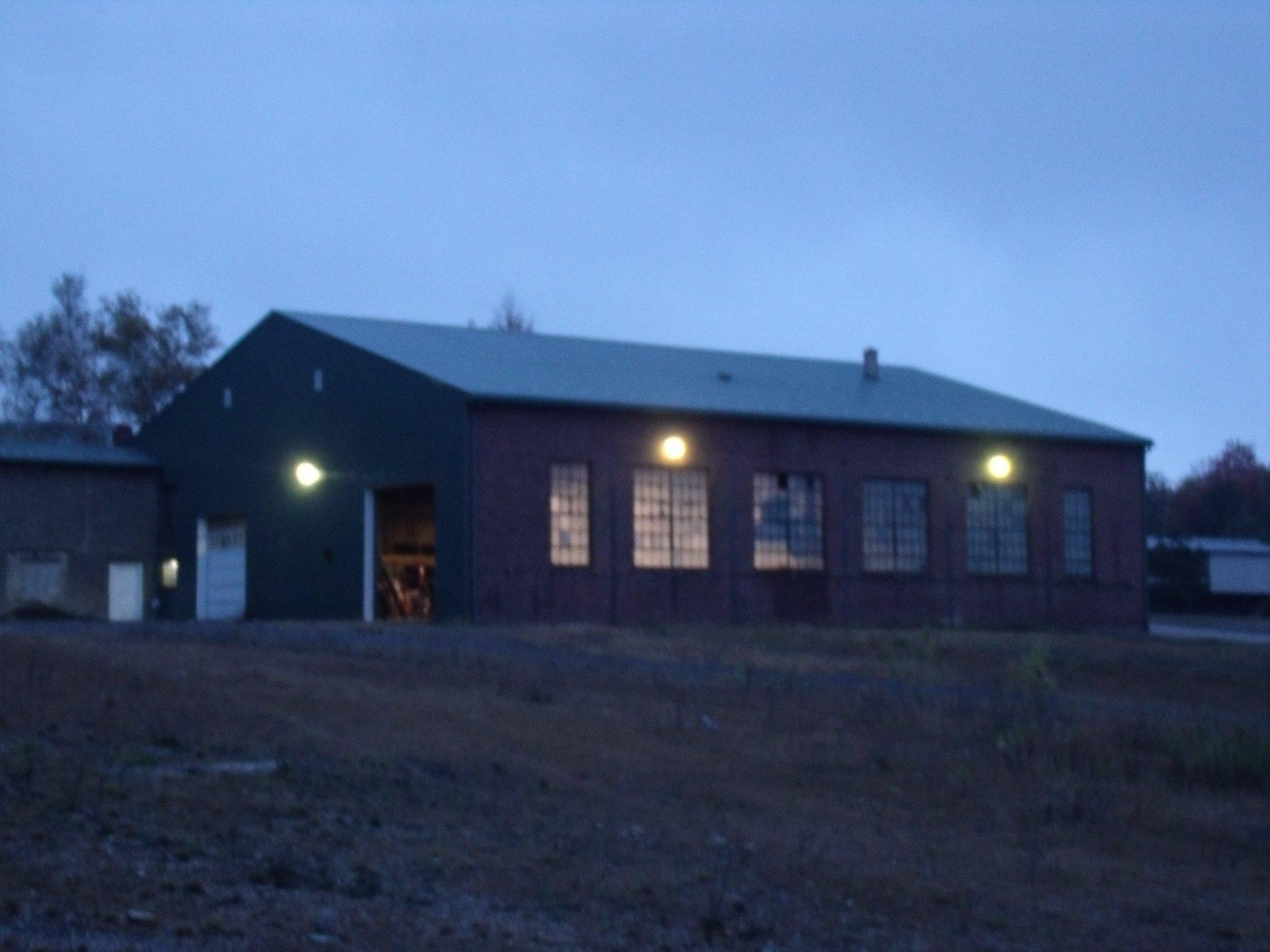

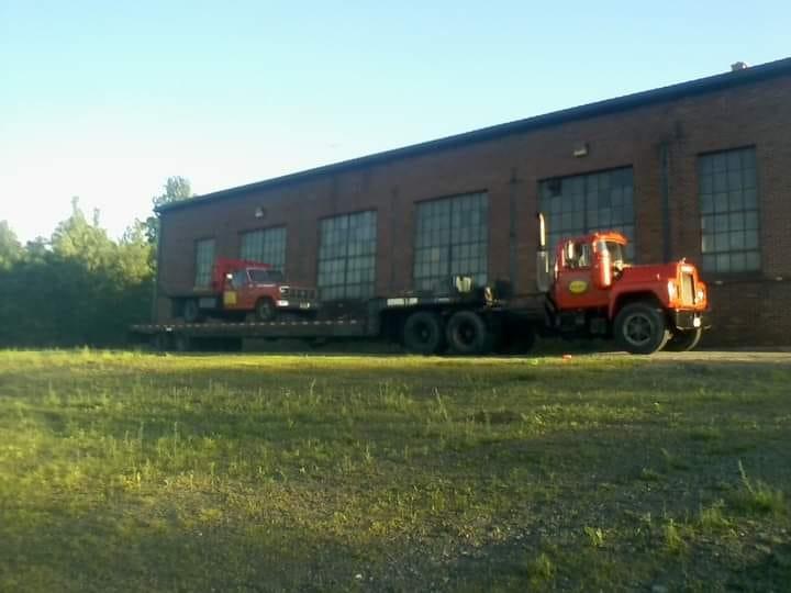

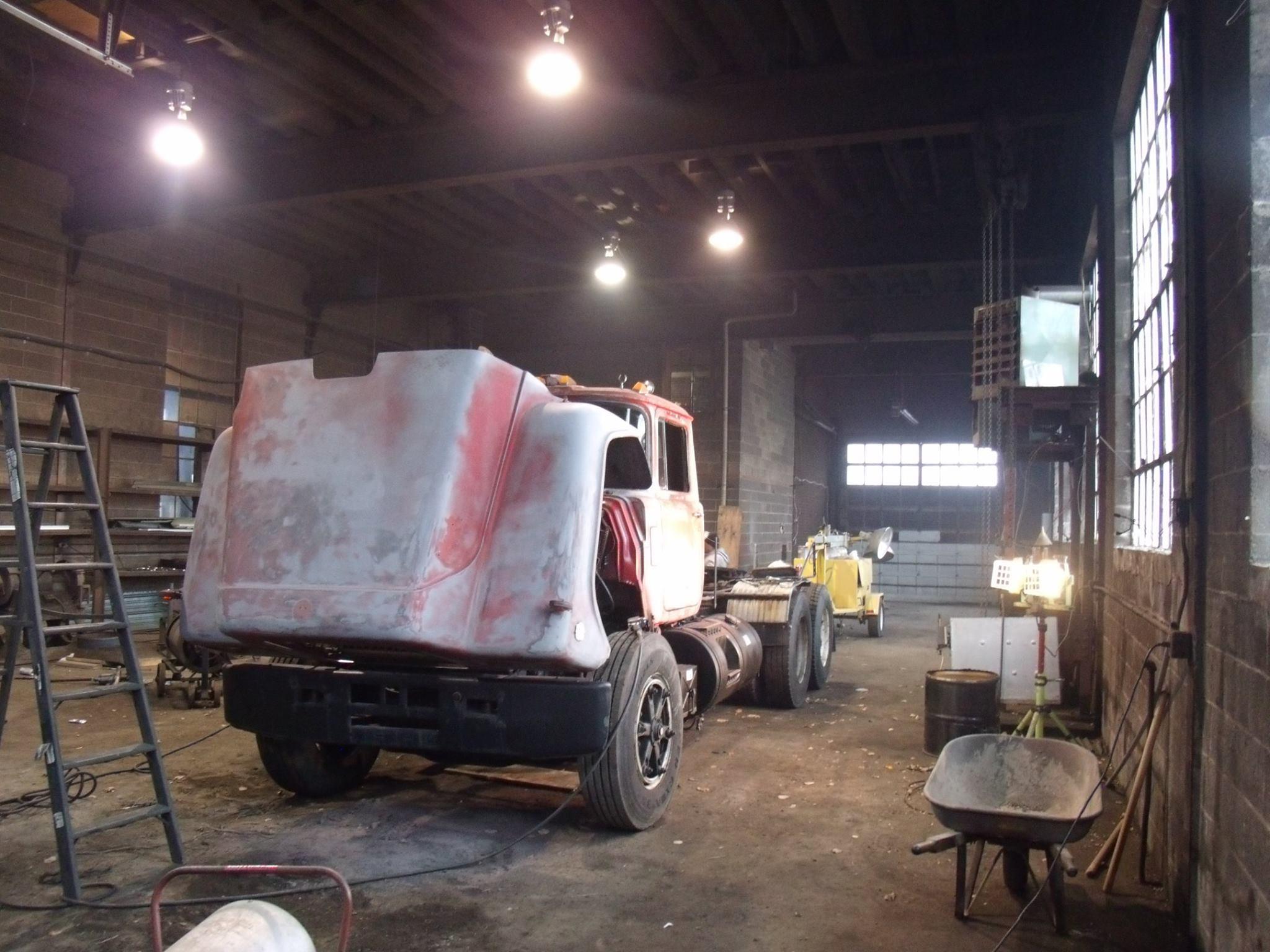

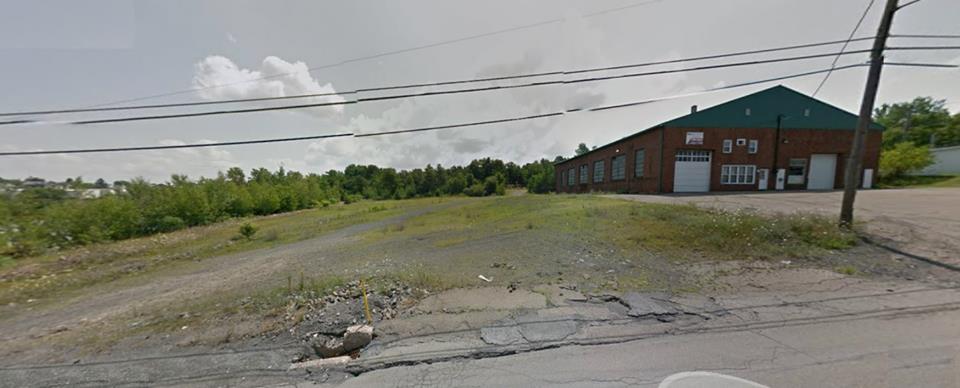

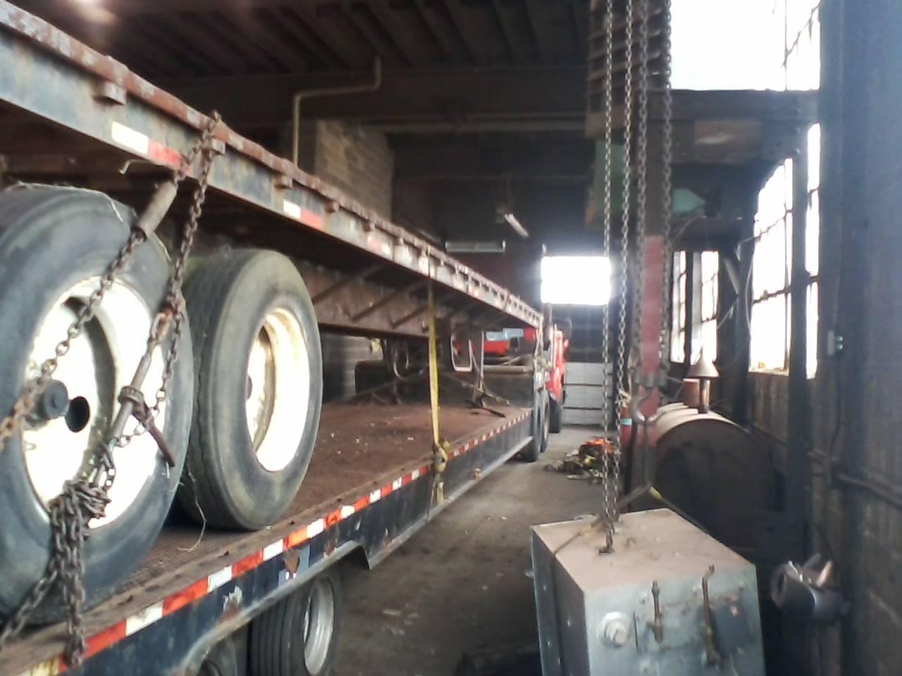

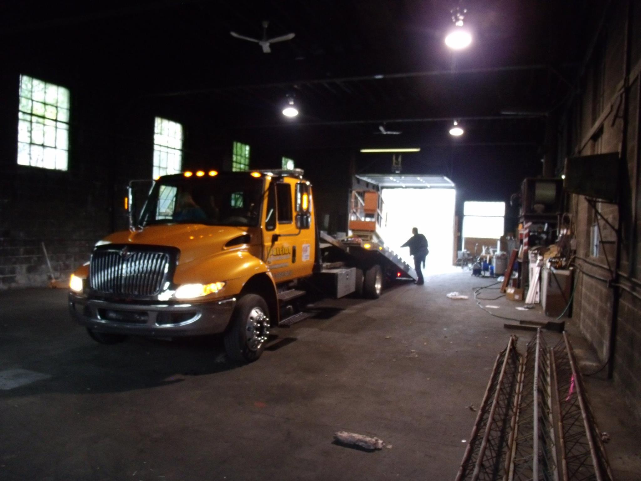

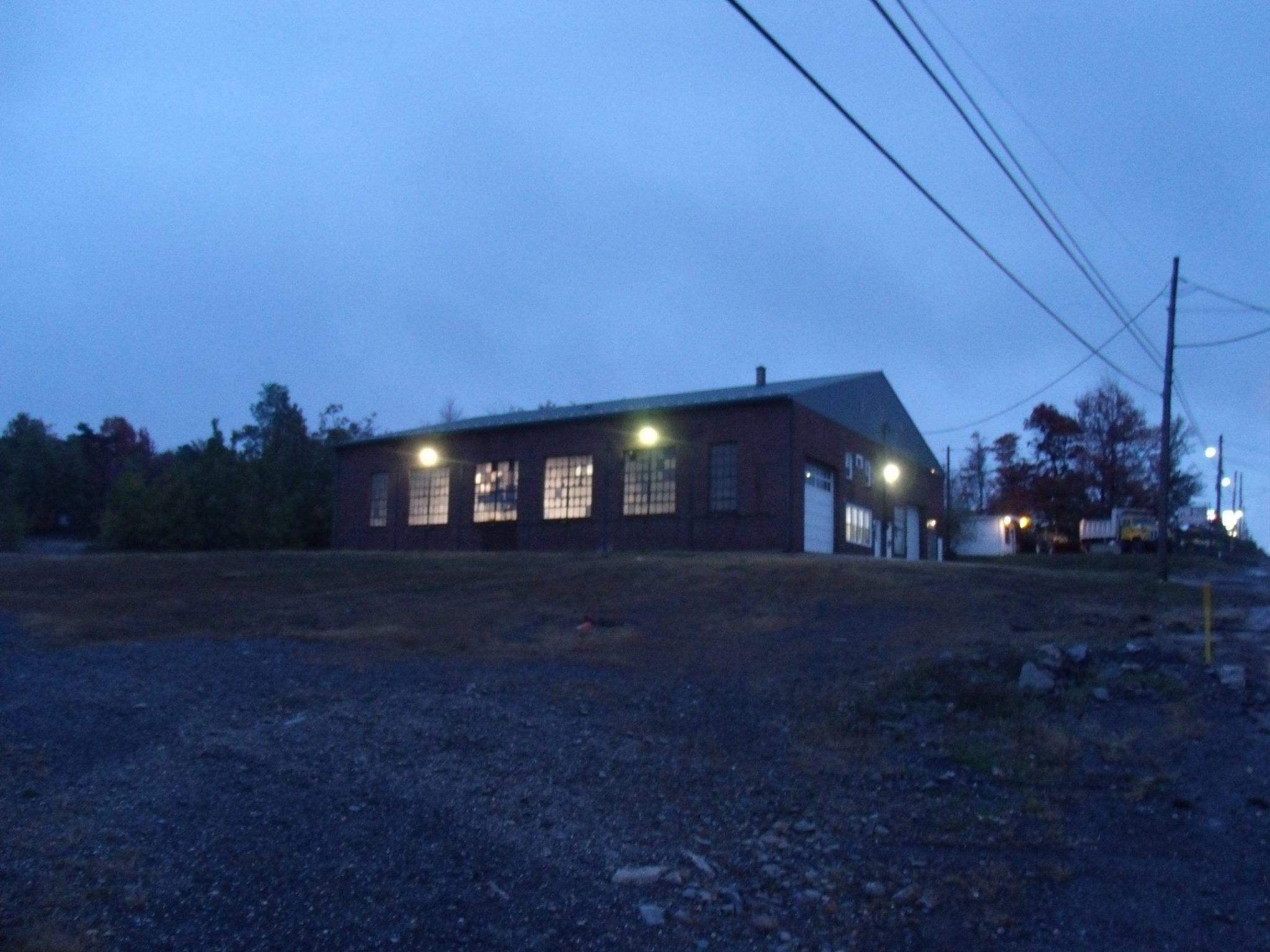

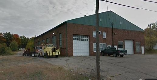

There are pictures of my stuff on here, pictures of my 10,000 square foot shop with 20 foot clear ceilings too. And I'll say it again, ALL CUSTOM TRUCK BUILDERS ARE HACK JOBS

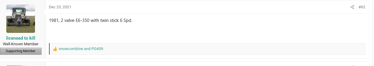

And I get called a keyboard warrior by a guy who doesn't know a duplex from a 6 speed low hole
Theres always one....on the other hand I think any day I dont learn something is a bad day.....By the way Id kill for a shop like yours.It fantastic....

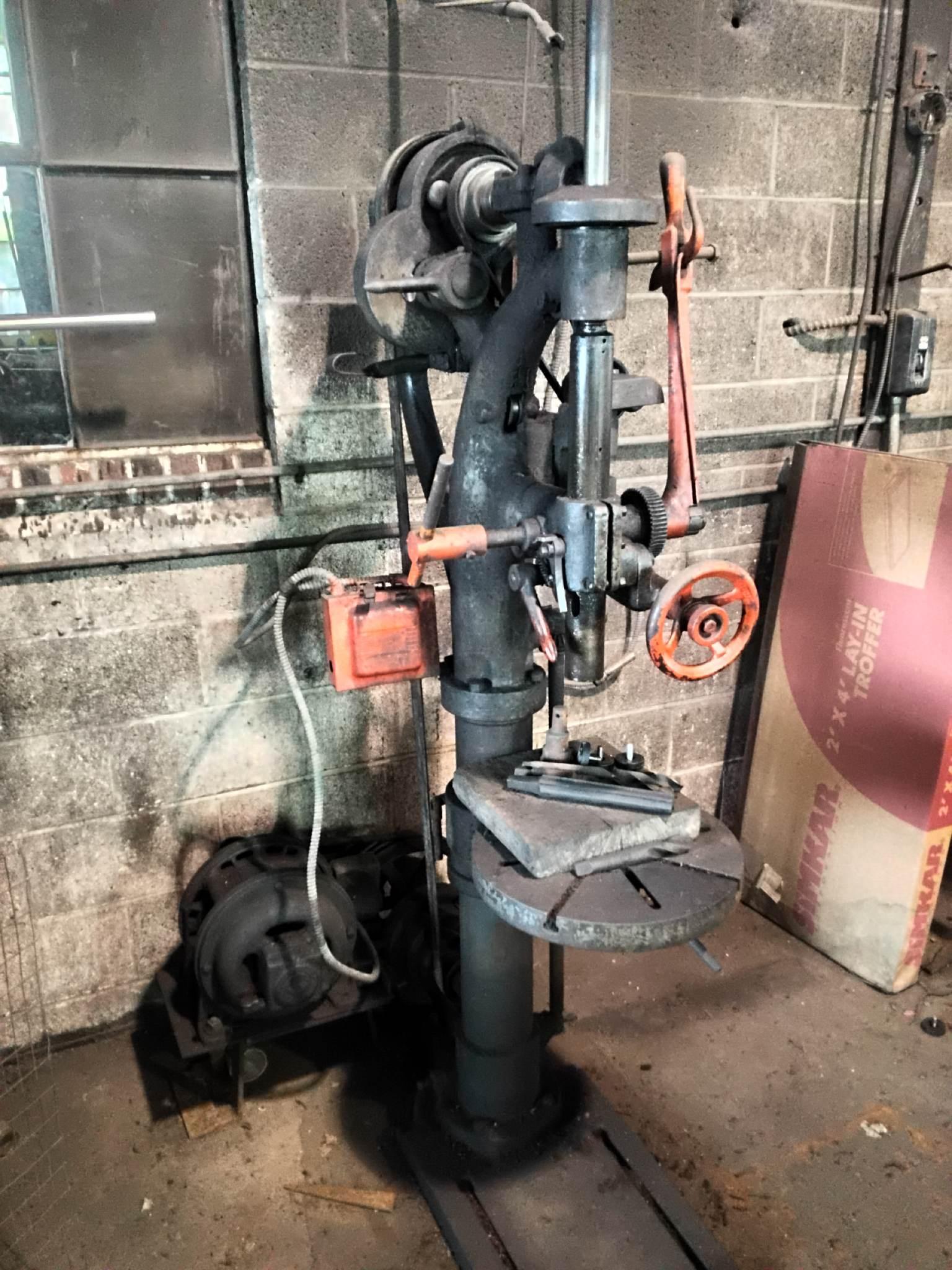

Kind of when I feel like it
50 minutes ago, 67RModel said:
How do you heat that sucker? I couldn't imagine heating 10,000 sft just to tinker with old trucks.
EFM Coal boiler, sometimes I use some propane. One side is built into the hill.
Not just to play with old trucks. The cats go out in the shop to play and I don't want them to get cold so I keep it like 45-50 and only heat it higher when I want to work out there

Joseph I just went past your garage on Wednesday was shopping down to Hometown and had lunch at the Beacon diner first time I ate there was about 1973 we were heading in the stripping's to repair a Cat. I have been in that garage more than once if memory serves it was Yamula's back in the dark ages. Didn't I see an old R model on the lower side and another old truck?
