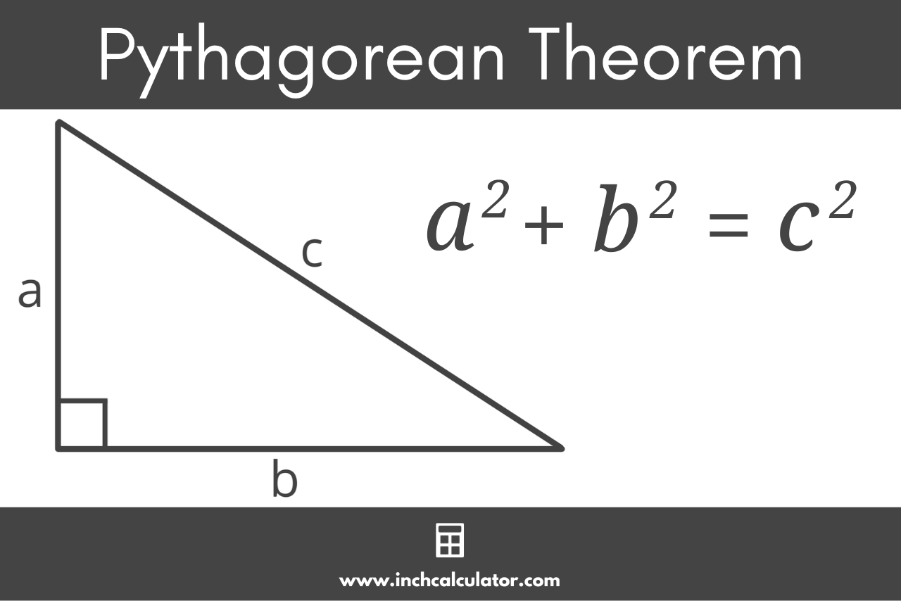

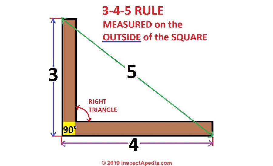

Helps to know some basic trig like the Pythagorean Theorem, or as carpenters call it "The 3 4 5 Rule"

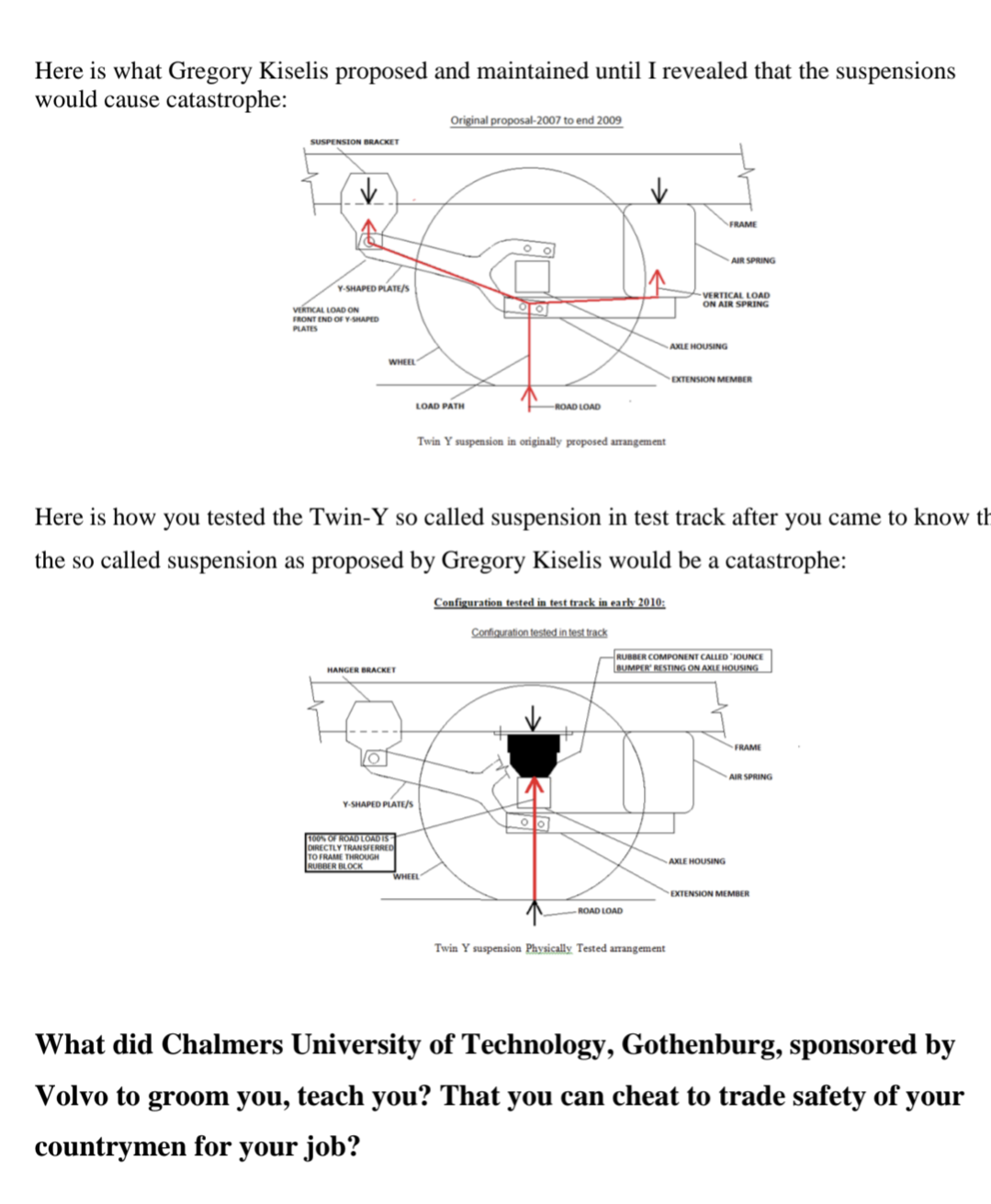

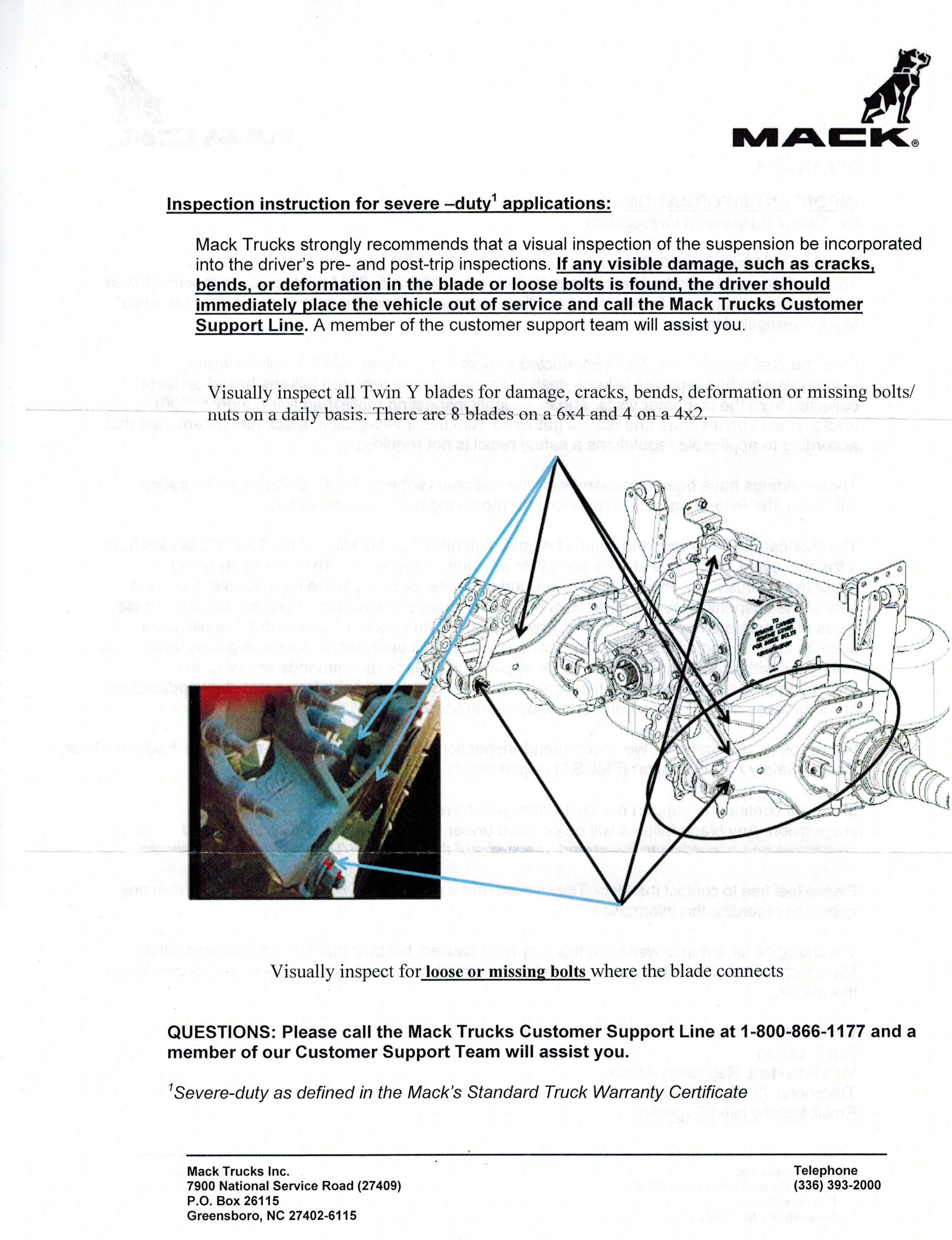

On 1/23/2025 at 12:20 PM, 2014pinnacle said:
Hi guys I have 2016 pinnacle with a twin y suspension it needs new bushings anyone know where I can purchase them my dealer says theirs none available and no idea when they could have them. The suspension shop the truck is at claim nobody after market makes them and I’ve been looking myself and that seems to be true
I PMed you.
On 1/25/2025 at 6:19 AM, Joseph Cummings said:
this is a copy of A Radan suspension and is more for  dump and mixer application!
I remember seeing that flimsy looking y suspension being offered in some write ups  touted as be light more pay load blabla ! Sounds like  yup you pay alright!

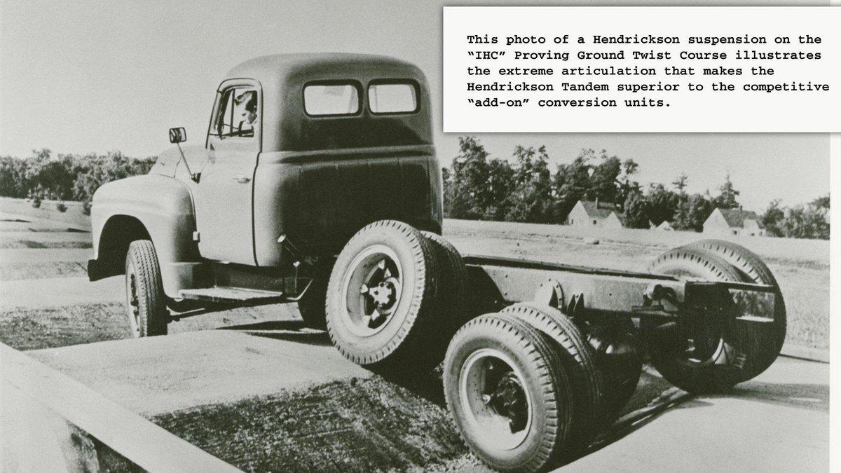

If I were to have walking beam (and have had), it would be spring. The walking beams, and any center point suspensions strong point is it dampens by transferring shock loads front and aft. The springs themselves don't do a whole lot of deflecting, and mainly on large "swells" where the load is on both axles at once.
 I don't see the air version as worth the complexity.
I have run various spring suspension, and loaded properly they are fine.
A lightly loaded walking beam on a short wheelbase tractor can and will "launch" the driver over a rough road. But any suspension will be rougher on a short wheelbase.
KW 8 bag is notoriously rough despite haveing the  most air bags of any air suspension.
The Hendrickson designed Z spring combines the best of both worlds and has been around in some form or another for 50 years, only the walking beam design which has been around for about 100 years can claim longer life. Both are Hendrickson designs.
The AR2 was never a big seller, and I have yet to see on a truck.
We could go right to this lol. But after haveing run an Autocar 9964 with the RS (Rubber Pads) and replacing the tail light bulbs every time I bobtailed more than about 20 miles, I'd say it'd be a little too rough.
I used to pull a Rodgers RGN that had those walking beams that had the axles cut in the middle, and between that and the RS Hendrickson under the tractor I started to understand why women wear sports bras

After driving all sorts of old trucks. I can safely say that a truck with air ride tends to hold up much better than a truck on spring or beams. my thought is that if you have air ride with diff and power divider locks you will be able to do the same job 99% of the time and the truck/driver will not be abused as much.  I use to swear by Camelback and auto power dividers until I drove a few trucks on air with manual power divider and diff locks.  the air ride trucks did much better with the locking rears. it was a eye opener for sure.

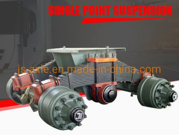

You'll never get the stability and articulation from an an air ride that you can get out of a single point suspension like a Mack camelback or a Hendrickson.
Same goes with the dump trailers. Everyone who works in a rough environment wants a Hutchens, or Neway single point. A bit of a rough ride beats the hell out of a dump laying on it's side

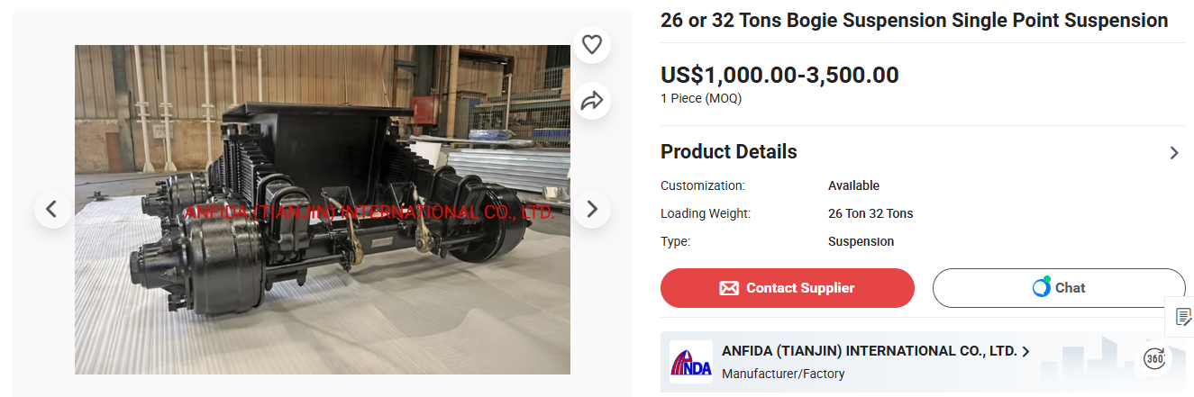

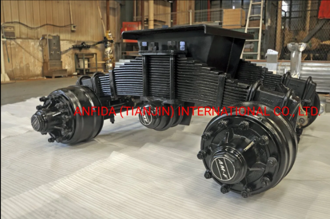

Looks like they are making nice dump trailer suspensions in China. I wonder how much with everything paid and delivered to my shop
