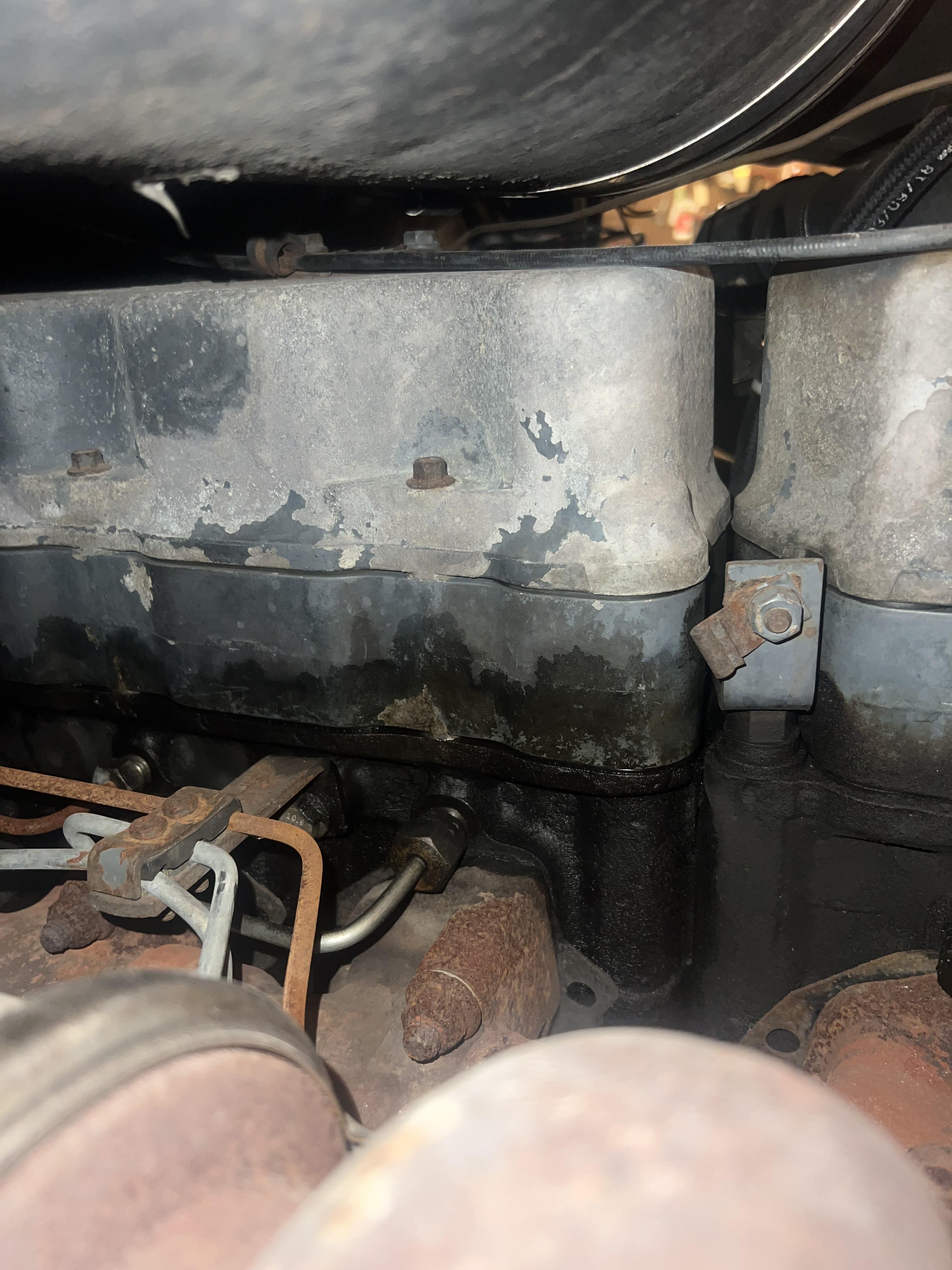

I would assume Jacob would still have the valve cover spacer to make room.  I thought dynatard was internal and wouldn't need the spacer.
My .02
Larry
if the engine tries to shut off at idle with engine brake on, it is a Jacobs.
if the engine brake shuts off at idle on it's own with switch still on, it is a dynatard
You sure about that? Mine has electronic throttle so I figured anything would be wired through computer to shut off with rpm, throttle, etc.
Look at the engine if there is a 2 inch spacer between the valve cover and the head its a jake!
sorry, i missed the 94 year in your post. i was referring to mechanical engines.
nope its crap shoot if they work better or not! Oil pressure was an alleged problem with these ! They added an external oil line kit sort of helped! But  problem being were only cracking one valve open ! Again not getting rid of all the compression needed for good braking ! Just my opinion!
