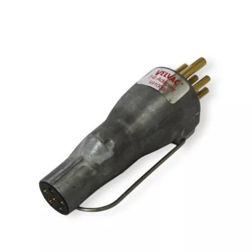

I towed many trailer of that vintage and older, I see it has the hole in the bulkhead for the 6 way as well as having a 7 way on it.
30 minutes ago, Geoff Weeks said:
6 way
Those were horrible. especially if you had trailers being pulled using this type of adapter
They were fine for their time. I use 6 way on all my trailers that aren't semi's. They were from a time with few bulbs on a trailer.
Only major difference is the tail and marker feed a separate on a 7 and combined on a 6, pins are a little bigger on the 7.
during the change over period, many had both receptacles on the front of the trailer. Some older ones were still around with only the 6, hence the adapter. I had one of those under my seat for a while, but never had to use it. Towed many with both receptacles, however.
