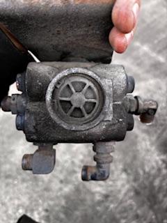

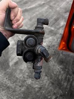

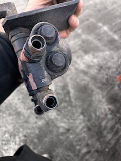

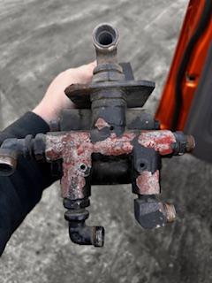

That is a weird one, Nothing I have see fits the pictures.
On the 2nd picture, it looks like there is a tag riveted to it.
Wonder if it is European style compressor unloader?
More I think about it, I bet that is what it is. Discharge line unloader.
Edited by Geoff Weeks
https://www.bigmacktrucks.com/topic/75099-air-valve/#findComment-568162
It doesn't look like the line unloaders on the buses, but they didn't have a duel brake system either.  It seams like something that splits the system in two and possibly unloads the line coming from the compressor.
 I am just guessing, it could be set up to react to either sides tank pressure. Seams to have two sections with a common exhaust.
They use a different unloader system for the compressor in Europe, they dump the outlet from the compressor when the set pressure is reached, the compressor keeps pumping but has no resistance on the outlet.
